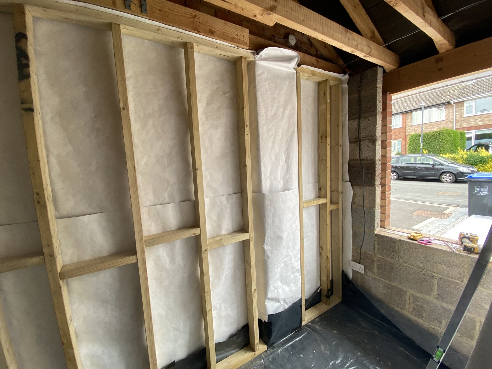

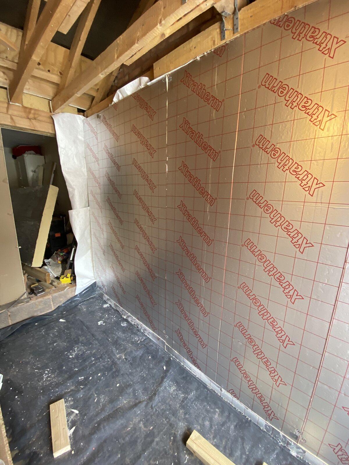

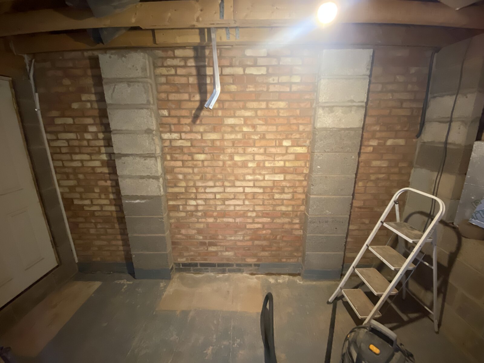

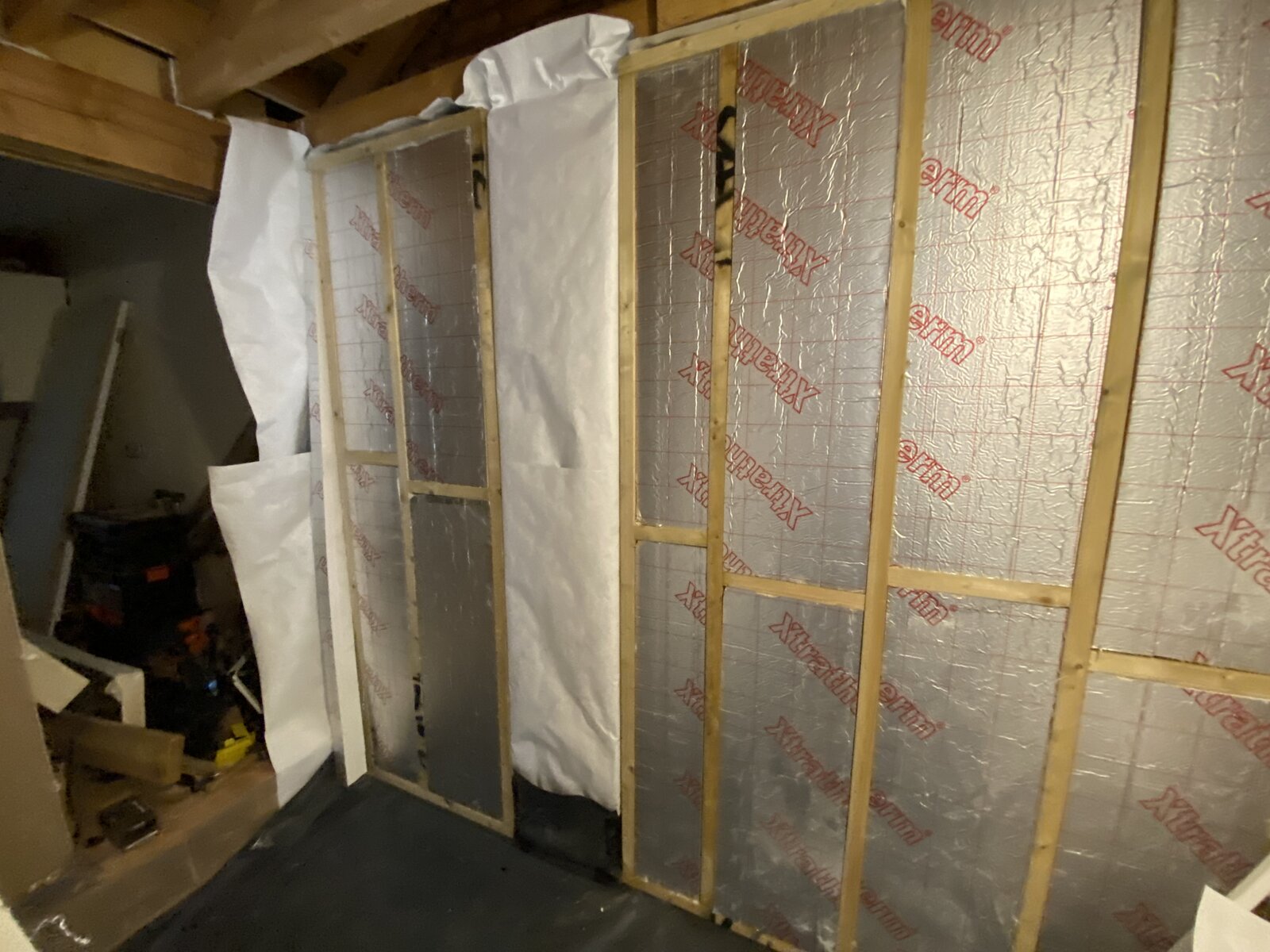

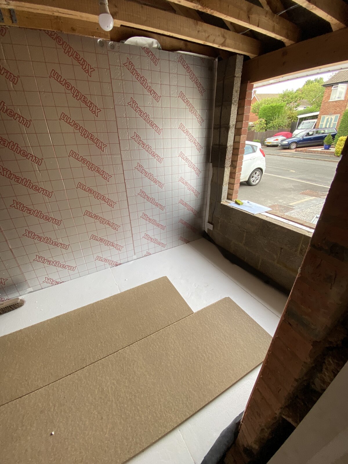

I did pretty much one of every type of wall in my integral garage conversion. Key thing is insulation. If its single skin ensure your piers are ok (mine were pulling away from the wall so had to relay them). Make sure you put a breather membrane up first if its single skin brick (I used Tyvek housewrap, comes in big rolls but you can sell the remainder of the roll). Timber frame comes after the breather membrane. I used wood as thick as the piers so that it sat flush with them. Then insulated with PIR insulation between the frames. You need to insulate over the piers so I used some 30mm PIR insulation to run completely over the full wall. Then plasterboarded through the PIR and into the frames (make sure you mark where the studs are behind the last layer of PIR.
Oh and appreciate you've already paid but I much preferred the private building regs company I got. They knew much more than the council one and were willing to compromise on some bits in exchange for other bits being overspecced. Plus they were cheaper!
Thanks for your advise mate it's really appreciated and it's given me something to go on. To be honest I wasn't sure about the regs company side of things, so sadly went with the council thinking there's probably not much in it. But we'll see
No worries. I’ve added some photos if that helps explain what I mean. It’s all the same wall.
