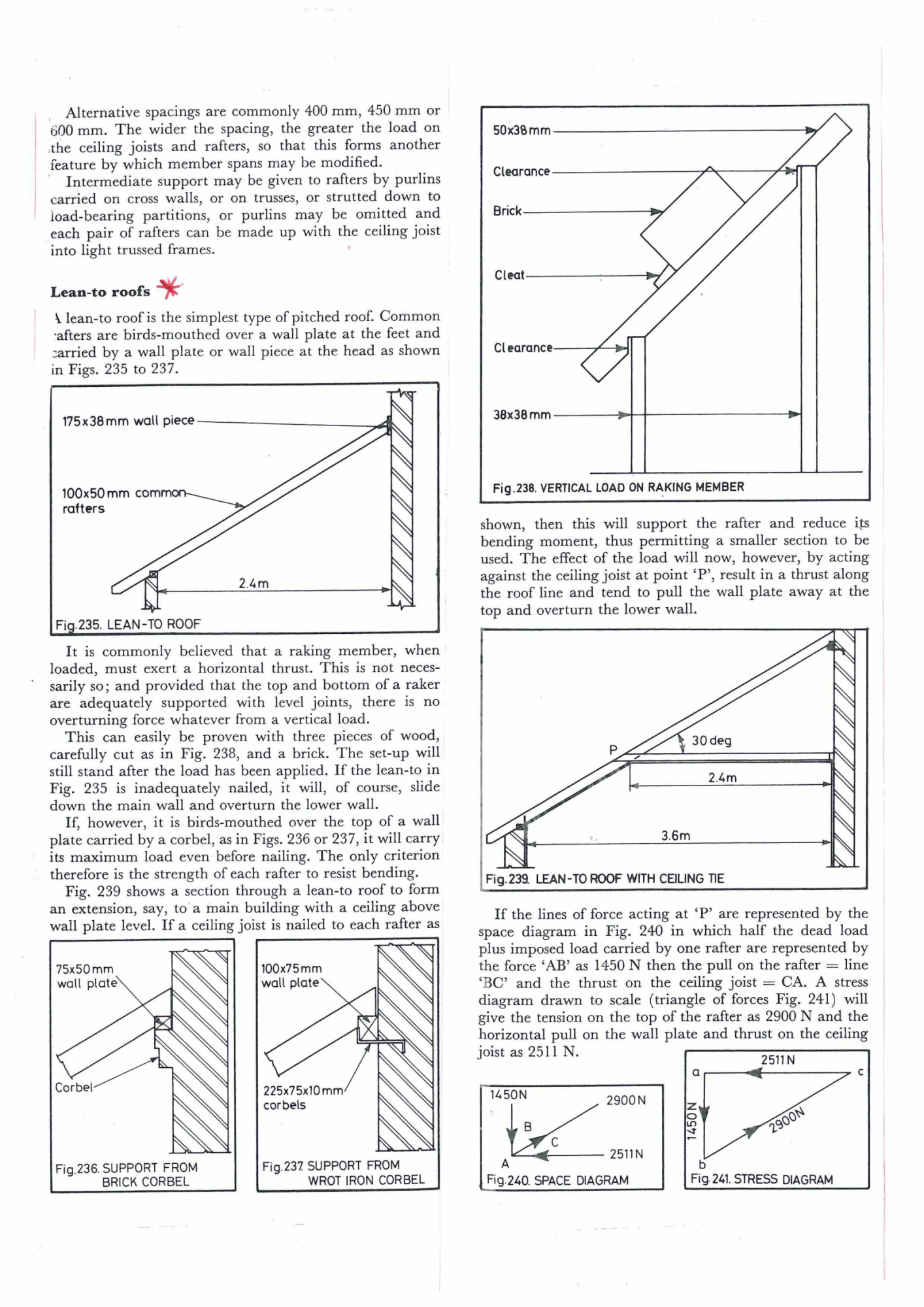

I am very unhappy with ridge beams, they can be as strong as you like but the problem remains of how you are going to fix your rafters to them. bearing in mind that if the roof starts to spread that the rafter will pivot at its top edge which will then try to drop. So first off all you have the stress of a long (say 9') rafter trying to lever its way out of the ridge beam, where the fixings will be close to the rafter end, say 3" which gives a leverage of 36:1, and that nail is within 4" of the end of the rafter. If you drop the fixing lower, you still end up with a very high leverage factor and a short distance to the end of the wood. The only way to get a secure fixing is to rest the opposing rafters end to end then nail on a plank across them then rest that plank on the ridge beam. If this seems a step to far, then strapping opposing joists over the ridge beam would work, providing the straps ran at least 12" down each rafter and are held by decently long screws. This method would interfere with nailing on the laths.

Frank, it's the same principle as below for lean to roofs. Yes, the fixings will need to be strong enough to prevent the rafter slipping down and imposing a lateral thrust on the external wall, but this should not be difficult to deal with if done properly.
Alternatively the rafter can be birds mouthed at the top and sat on a hanger, so that the hanger does all the work, or birds mouthed over the beam itself. This is the detail that I would be more likely to do if possible.
Unlike a ridge board, a ridge beam is designed to carry the weight of the rafters and will not sag so there should be no risk of the rafters pivoting about their top corners.
