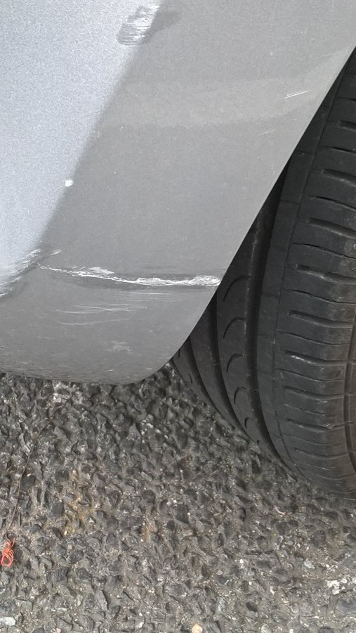

If the bumper is made from ABS then an ABS solvent could be used to solvent weld strips of ABS on the back of the bumper across the crack to provide the necessary strength to prevent the crack opening again.
The solvent used for solvent welded waste pipes might work but something like Plastick 1506 would be much more agressive and hence make a better bond.
Test on a clean bit of the back of the bumper and don't get any solvent on the front.
Ok, it took me a few weeks to get done, but I finally fixed the crack. It is not beautiful- if I wanted a beautiful finish I would have paid professional to do a nice job, but it worked! :D
I ended up using some 'Unibond' epoxy putty and put touch up paint over the top. It is still holding, and looks solid enough. See the photo below to see my mend (or is it more of a bodge?? :))
When I get time, I think I might sand it back a little (as well as the other grazes you can see on the bumper- caused by 'him indoors' by the way not me!!) and use some body filler to smooth it out. Any suggestions?
Thanks again for all your help and advice!

I'd say that was a mighty fine attempt, and a bit more sanding wouldn't come amiss. You've stopped the crack spreading and that's a good move.
If you consider any painting, be aware that there will always be some overspray which can be very awkward to remove so at this point I'd consider calling the Chipsaway people if you want to take it further.

Just a reminder that you need special filler for flexible plastic bumpers. You'll find it on EBay
Just as a tip for anyone reading this, if your bumper is ABS, which would be normal, then a solvent ( and therefore glue ) for this is acetone which can be bought cheaply as there is unlikely to be a big enough jar of nail-polish remover in the house.

Drill a hole at the end of the crack (then fill it in if you wish) to stop the crack growing.
