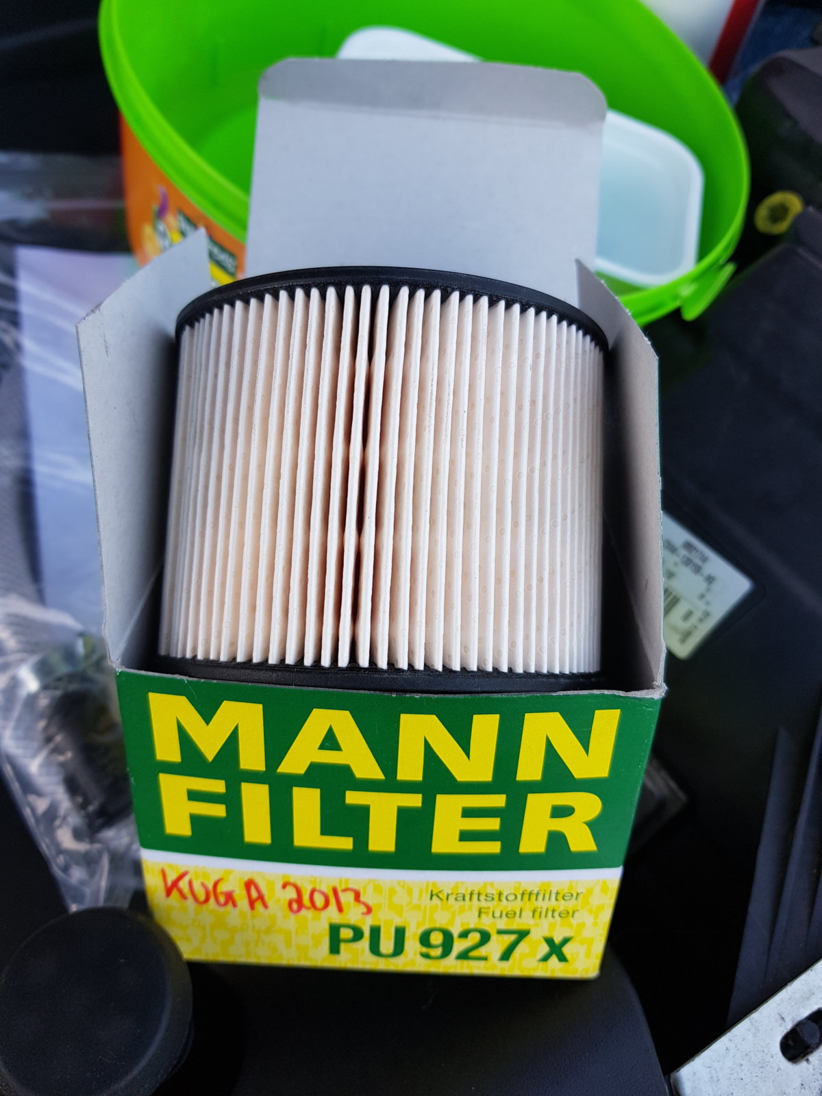

Hello all, I don't work on a lot of cars (mostly our own).
Did a Diesel filter change today and was wondering if the old one looks "normal" or if it's never been done before?, cars ticked over to 70,000 miles recently, coming up 7 years old.
I was genuinely surprised at the colour of it, Mann was the OEM fitment and they look identical.
I reckon thats about the norm, Keith.....my filters come out black too, but I’d never leave them for 70k.
I have noticed that remote bulkhead mounted filters keep cleaner but one mounted on the block changes colour....maybe heat plays a part.
30k maximum for me, 20k if its an easy change.
John :)
Cheers John, it is block mounted. It "should" have been replaced before we bought the car (50,000 miles) but given all the other bother I doubt anyone's touched it.
Loads of people have had starting problems after replacing them but I can't see why really, bought a Priming bulb just in case thought!
