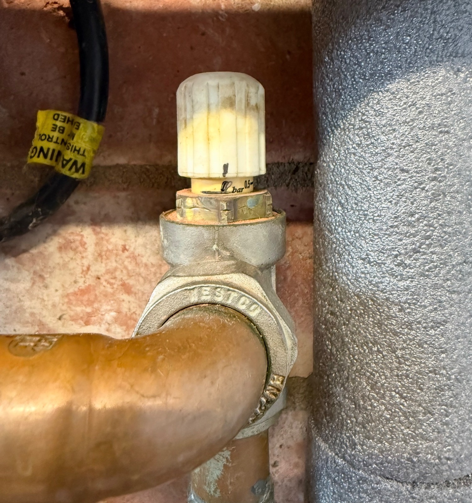

Hi, I have this Differential Bypass Valve on my central heating/hot water system.
I’m just about to run a MagnaCleanse through the system and the guide mentions that all bypasses should be isolated.
So I assume I need to close this valve off, but I’m unsure which setting is fully closed.
Could anyone offer any advice?

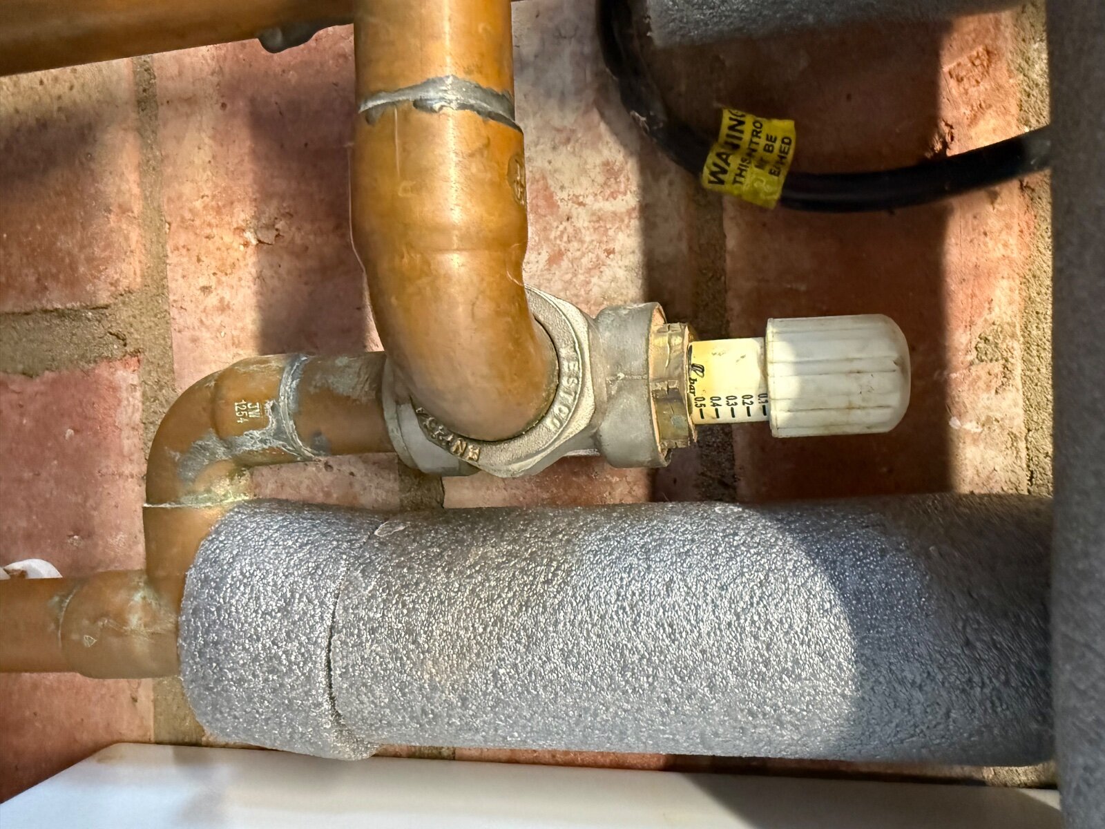

looks like an older auto bypass.
Wind it to it's highest setting, just remember where it was set. Though I would say that the bypass leg would also need to be flushed too.

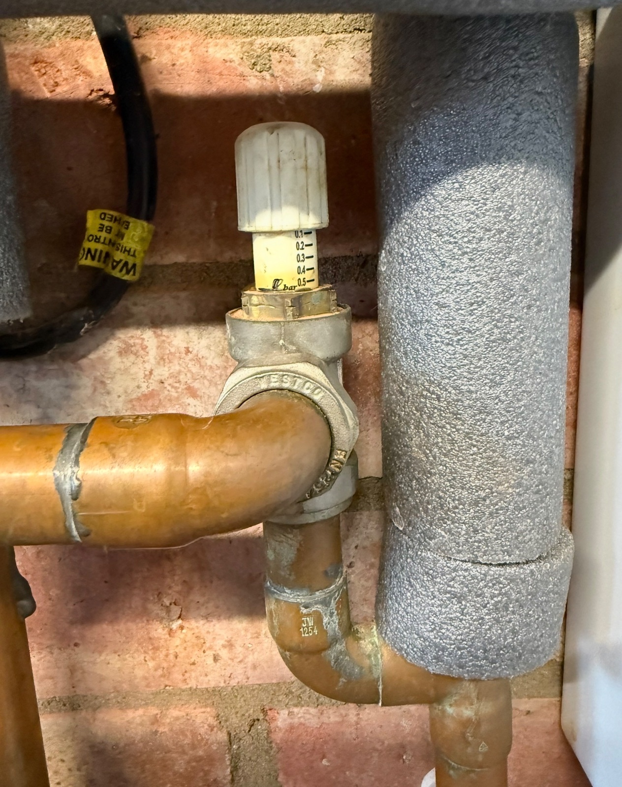

So wind it out like this picture to close it off?

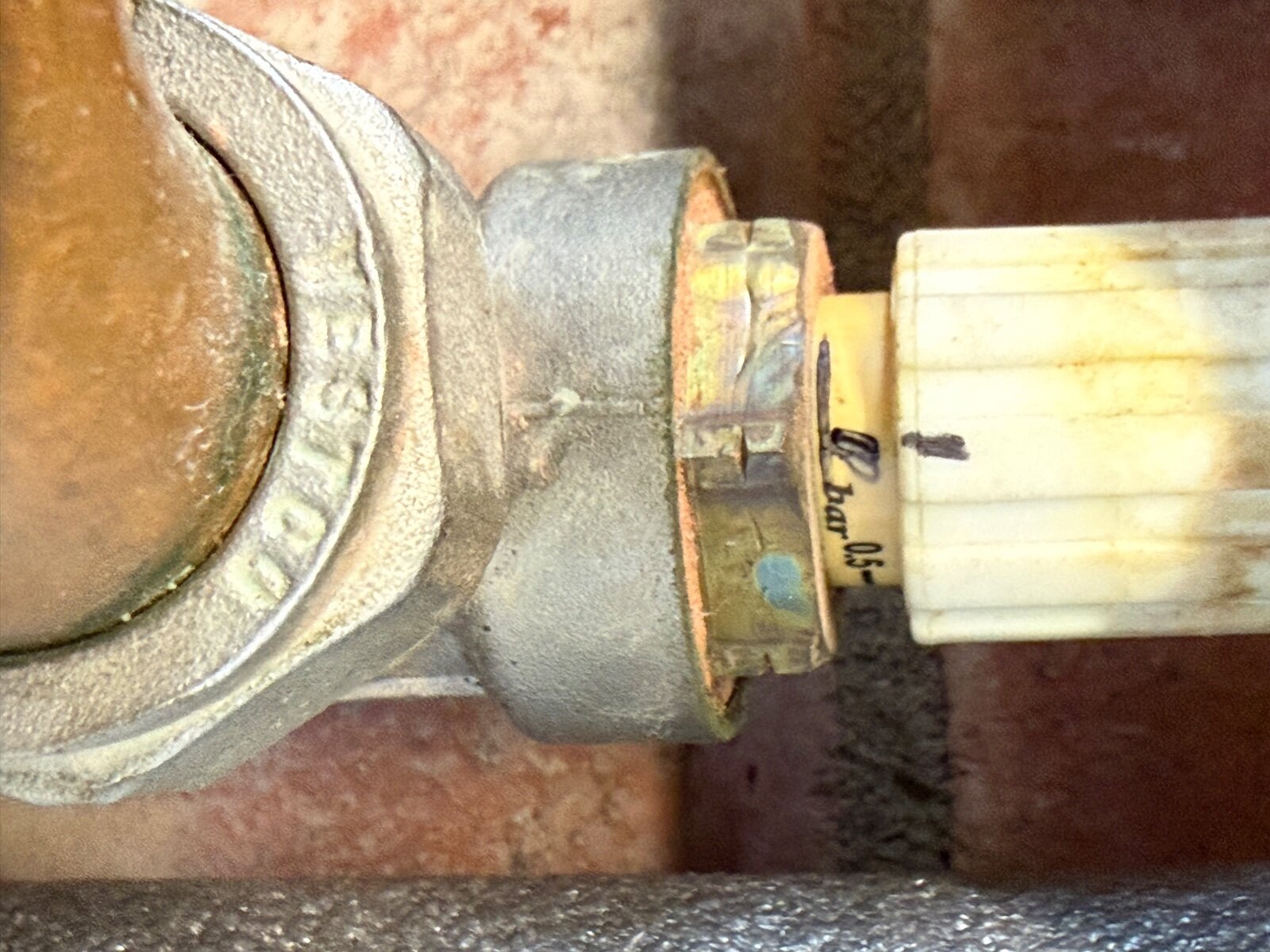

Ok, I get it now.
Looks like it’s currently set to 0.4bar, so just wind it down a bit more.

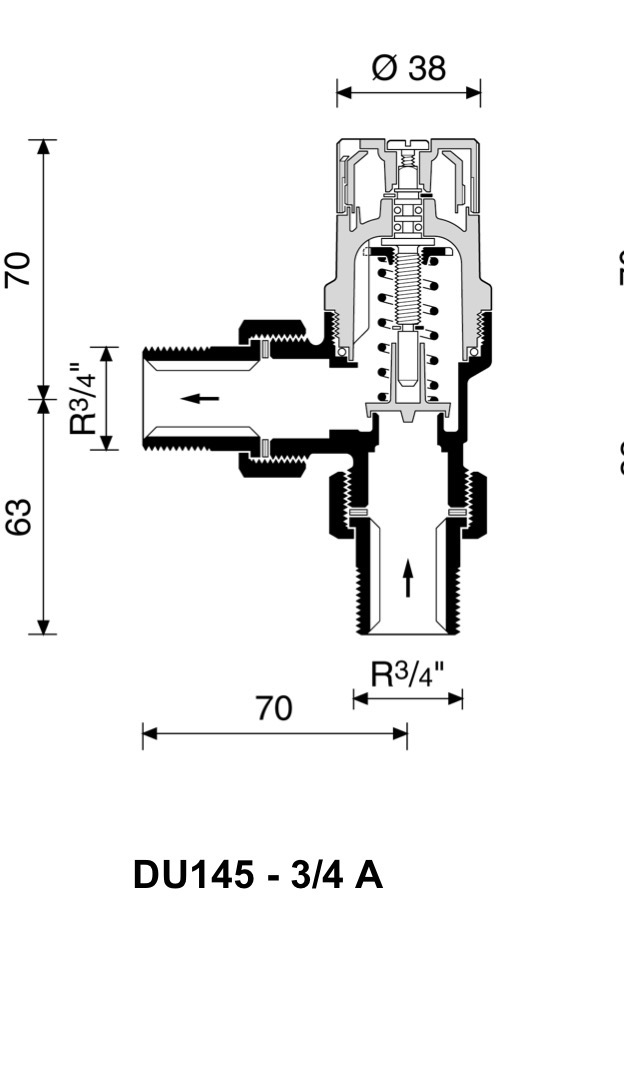

Is this cross-section an example of how the valve works?
Yep .... As the valve is tightened down it increases the resistance on the spring, that then requires a higher pressure to lift it.
