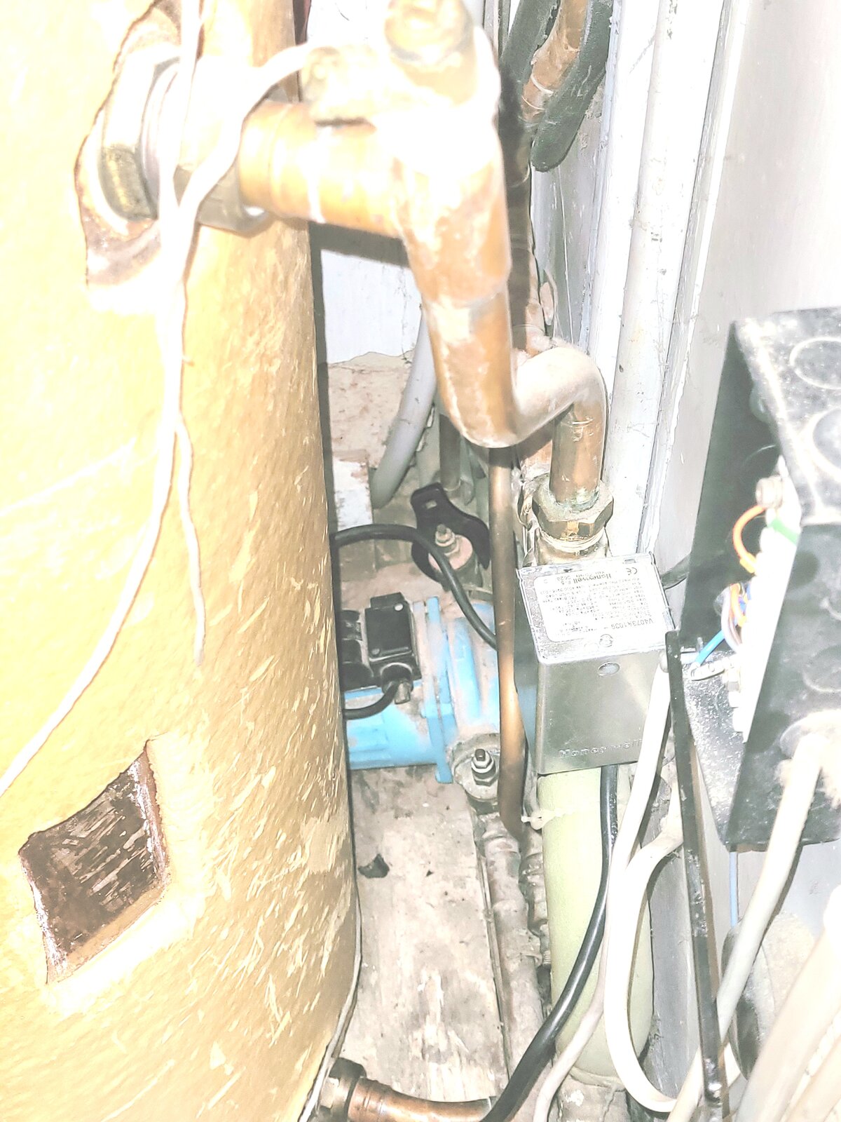

I think that the OP's problem is that to move it, he has to disconnect and remove the existing pump - which he can't properly access because of its position.
I would look at seeing if the existing pump location can be by-passed by rejigging the pipework, and then fitting a new pump in a more accessible location. Hard to see from the 2 picures whether this is going to be possible.
Thanks all
Sort of. What I mean is, if possible, work out a new accessible location for the pump and fit the new one there, and alter pipework underneath from old pump
If I could "alter pipework" I could access the pump. There's about 3 inches from that rear 22mm comp nut to the brick wall, and a 15mm Tee already in it. Those are 2ft/600 from where you are at the front of the cylinder.

I have crow foot spanners (32mm (for 22mm comp nuts ) and 52mm(2 1/16th) (for pump nuts) so I stand a chance. I can't even get Bahco grips on the pump nuts as is.
Have you tried giving pump nuts several hard taps with a hammer/ chisel? First thing I do on pumps not unknown for nuts to then come undone by hand.
Good thought, have tried a bit, but can only reach a small part of the circle.
If you can get the nuts loose, you may be able to twist the pump enough so it is facing upwards enough to allow access to the pump head bolts, then you may be able to just replace the head.
That being said, no matter what - and I do appreciate there are physical difficulties - it really is going to be nigh on impossible to service that properly with any degree of confidence that there won't be problems with leaks post the work, without taking that cylinder out.
The pump is old - a Myson Unit 3. No idea what would fit it. I may have a cp63 somewhere, but those old ones' back ends had a rotary valve on them, so probably different. Was thinking it would leak if the pump had only been spun round, but if I could release the 22mm nuts that could conceivably work :).
Only other thought I had was to file a notch in the 52mm pump valves and use a hammer and cold chisel to tap them round, If the nots broke, fine.

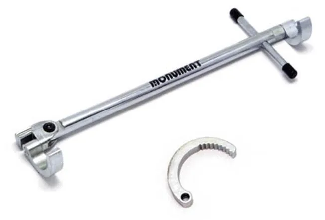

I used to have one of these, paid about £20 back in the day. Now £68 or so. Memory tells me they fit just about anything but are a bit springy. Anyone remember/used one?

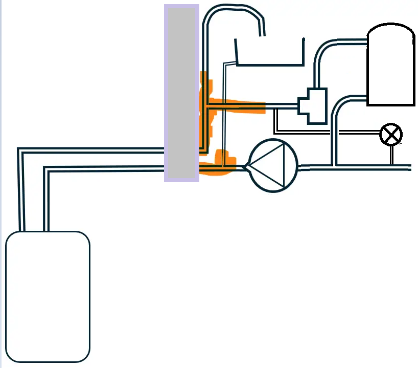

Posted a version of this earlier. Yes I know people will be quick to say it shouldn't be like that, but the engineer who did it estimated it would last a long time. It did. He thought he'd move house.... He didn't.
The by-pass has always been closed (15mm twisty one in the pic), and grey is a brick wall. Yellow has radiator-oxide-containing sludge which attracts a magnet.
