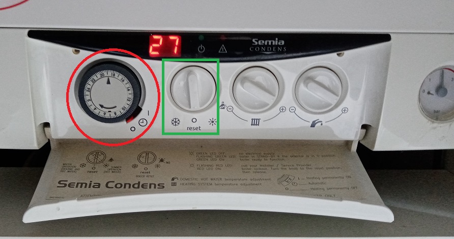

As per the photo, my boiler has a timer (red circle) with controls for Off, Timed, and On. None of these currently work.
The master control switch (green rectangle), has Winter (CH + HW), Off, and Summer (HW only) settings. Turning this to "Off" or "Summer" is the only control I now have.

That is because the time clock is set to constantly on, you need to move the little slider to the pic of a clock and set the tappets to what times you want to be on and off
Hi Ian
That unfortunately doesn't work.
In the pic, the red slider is on the "0" setting for "Heating permanently off", but the heating still comes on.
It also comes on when "Timed" is selected but the little grey notches are set to "Off".
At present, the only control I have is to flick from Summer to Winter.
In addition, the radiator temperature dial is set to maximum (in the pic). If I switch to Winter, the heating kicks in (even with the master switch set to "0").
If I then turn the radiator dial all the way to its minimum, the boiler turns off.
Turning the raditor dial back round to maximum, though, doesn't make the boiler re-fire.
To do that, I have to switch from Winter to Summer and back again, and the heating then returns.
It's very odd how the heating comes on even with the master switch set to "0" or "Timed" (but with the timer set to "Off").

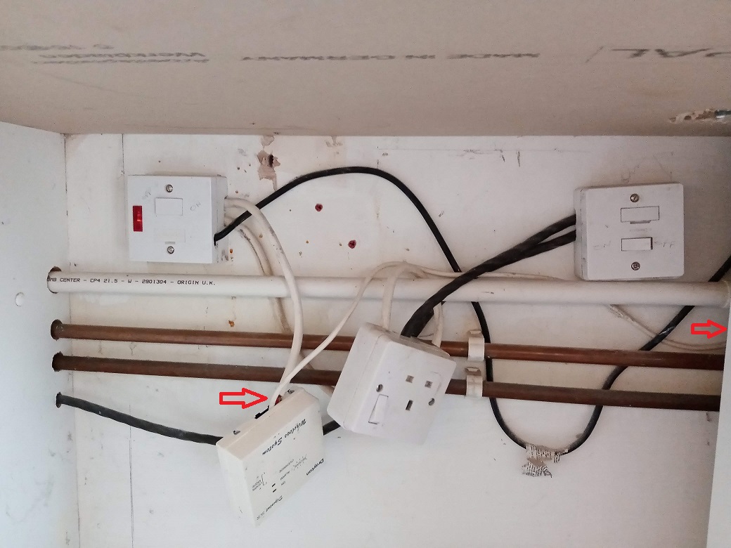

sounds like who ever wired in the SCR has wired it into the wrong terminals and not the External thermostat terminals, can you post a pic of where the SCR is wired into , not a great idea to constantly use the selector knob , the spindles tend to break

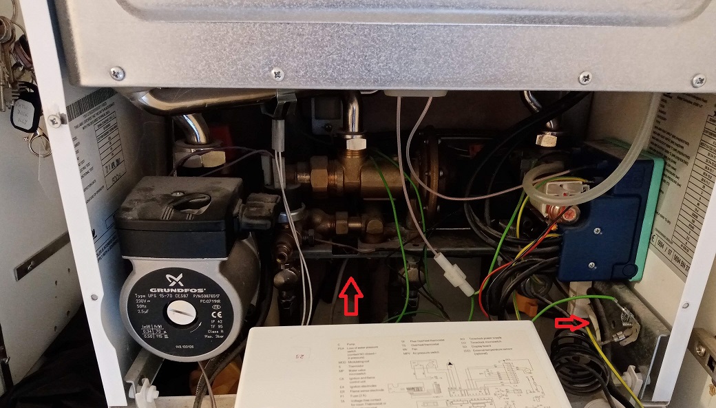

1. This is the disaster zone I am faced with underneath the boiler and behind the tumble dryer, none of which, I hasten to add, is my doing (but I will tidy it up after this).
Indicated by red arrows is the thin white cable exiting the SCR and moving towards the boiler.
2. The white cable comes up the back of the boiler and then round to the right hand side where it splits into two thinner black cables.

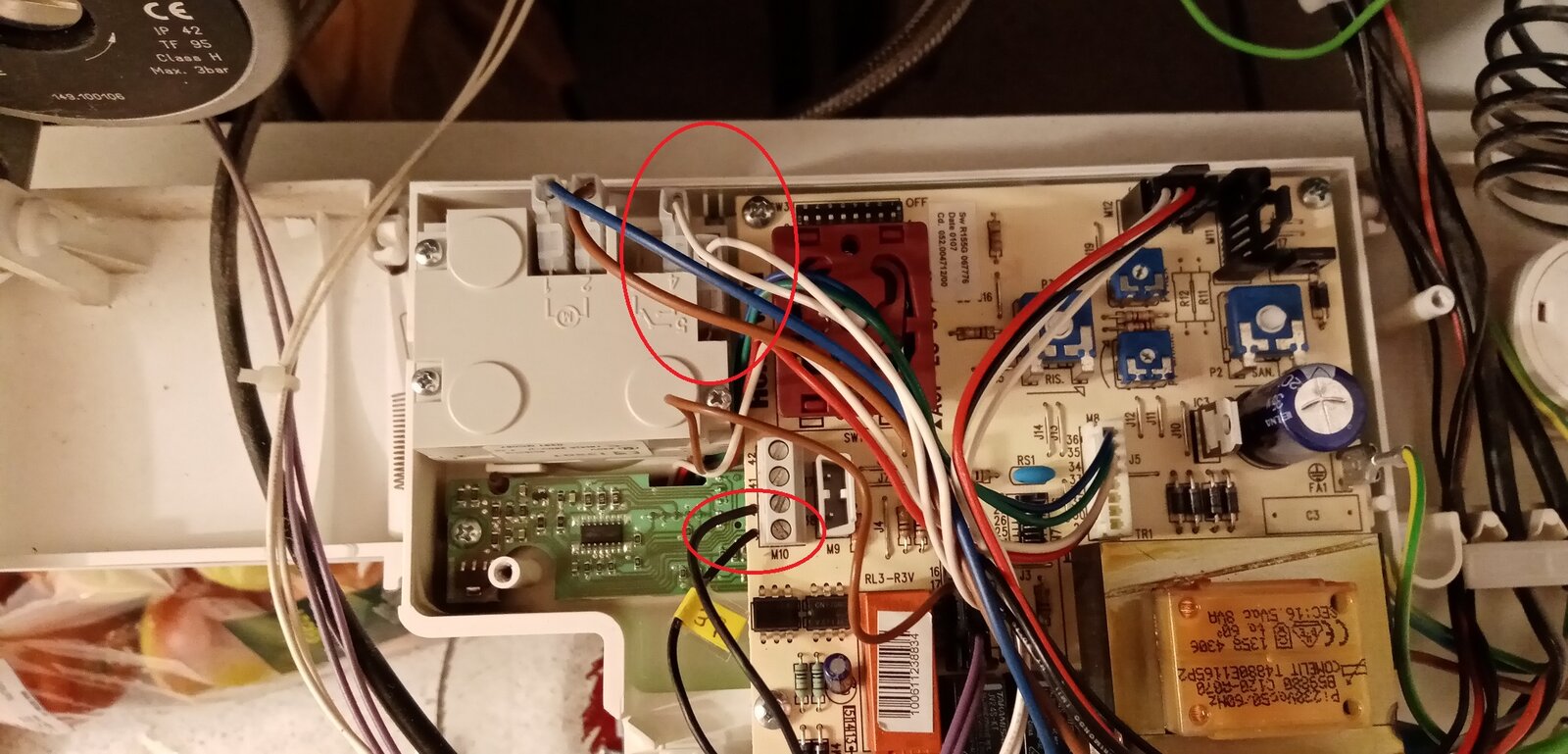

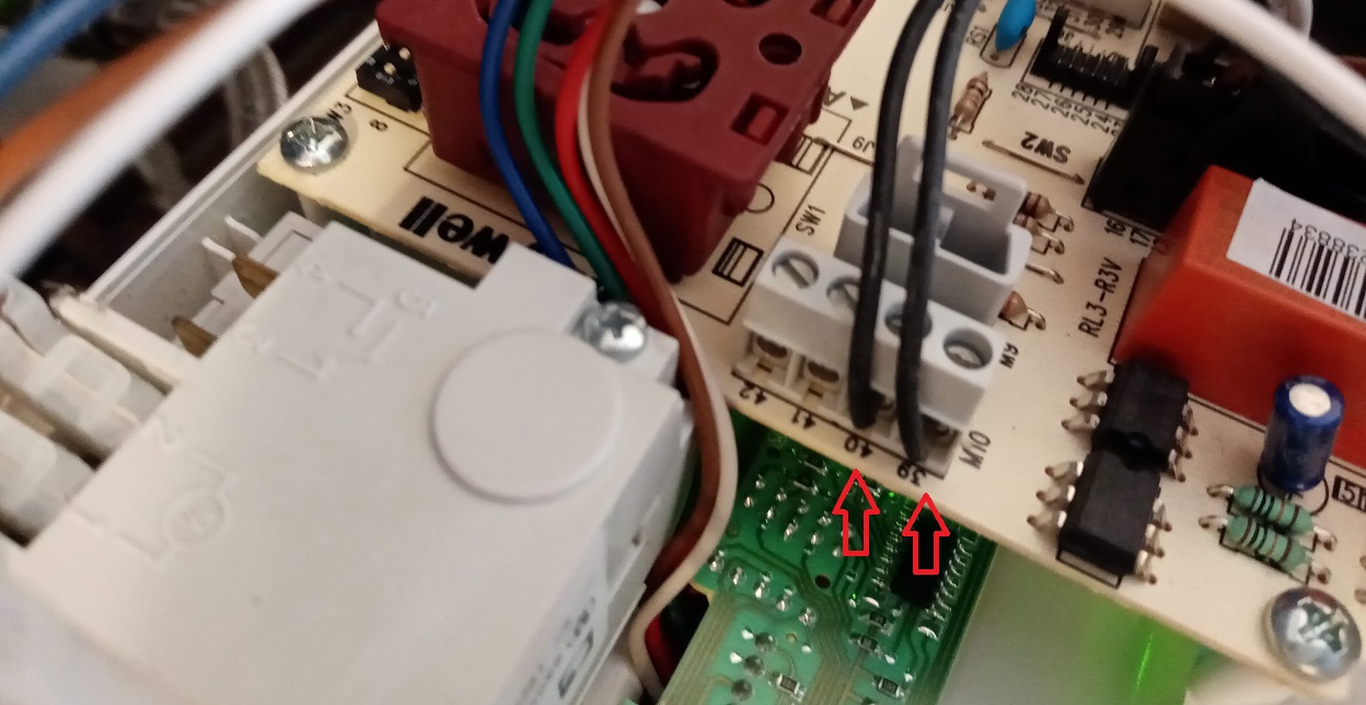

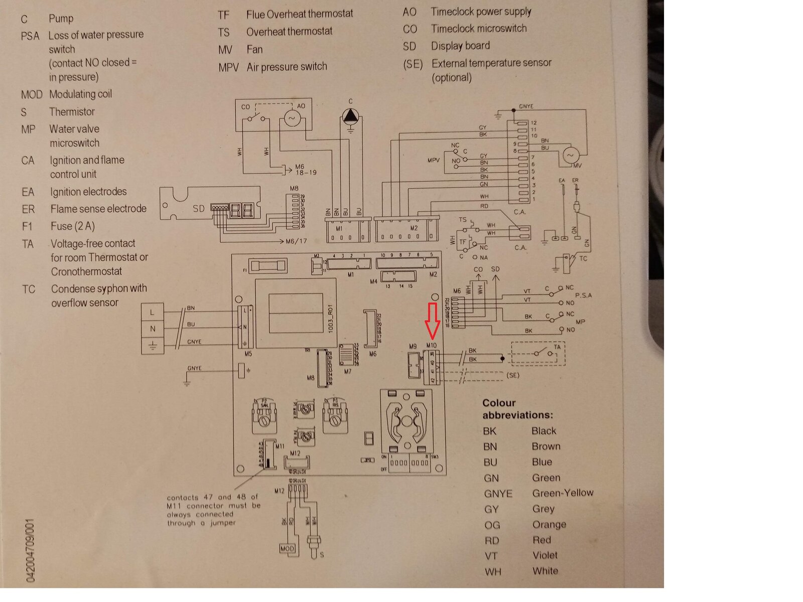

3. This is the wiring diagram on the inside of the drop-down PCB cover. Terminals 39 and 40 are indicated (as that's where the two black cables are wired in).

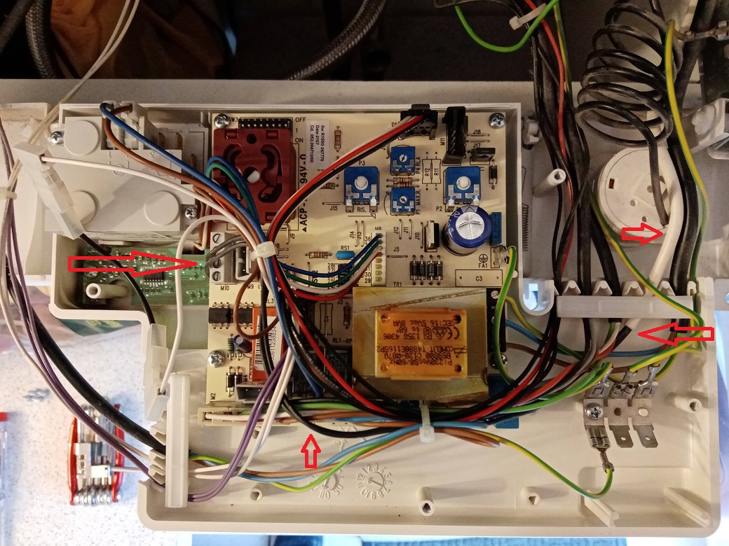

4. Here, you can see the black cables making their way round from right to left, ending in block M10.
5. And finally, here are the two cables entering terminals 39 and 40 of block M10.

remove the wires in terminals 39 & 40 and place a link in them , Just a small piece of wire, but be carefull make sure you isolate the existing wires as it could be a back feed effect because the SCR was wired wrong, if you are removing the SCR remove all wiring from it before making the link at 39 &40

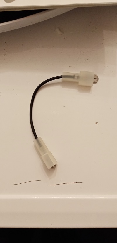

In block M6, white cables 18 and 19 were joined by the coupling below.
I looked at the instruction book pages I posted above, and I reversed the process shown for adding an external thermostat.
1. I removed the coupling.
2. I re-connected cable 18 to junction 4 and cable 19 to junction 5 (shown below by a red ellipse).
3. This didn't solve anything initially, so I then re-connected the black cables (which come from the wider white cable from the SCR) to junctions 39 and 40, and all the internal controls now work!
If this strikes you as safe, I'm happy to leave it as it is.
