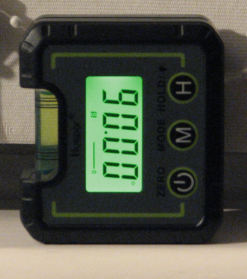

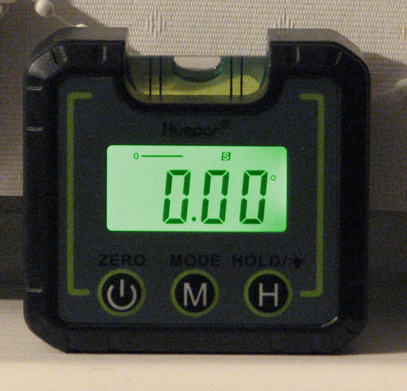

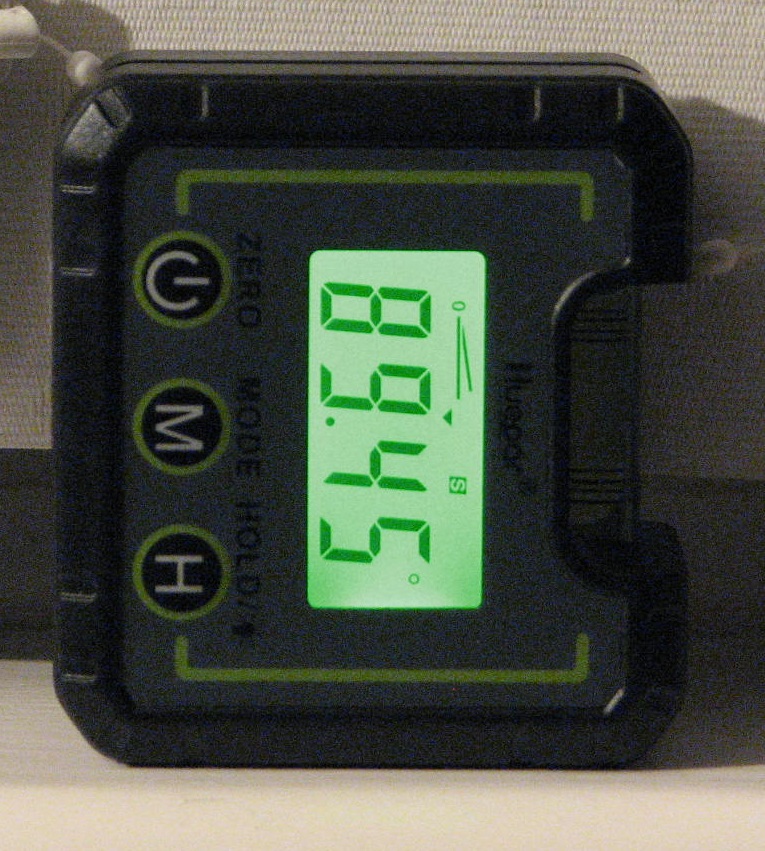

Hi,
I recently bought a digital inclinometer, it's a Huepar AG01.
It has 1 magnetic side and 3 non-magnetic sides.
When placed on its magnetic side and left side it's bang on.
However,
Upside down it's 0.45 degrees off.
The right side is 0.55 degrees off.
The bubble is also off by about 0.2 degrees.
Is this normal for these devices, or do I need to be sending it back for a refund ?
I've tried the device on several different flat surfaces, worktops, windowsills, desks, tables, sideboards and the results are always the same.
Thanks in advance.
Here are some pictures.

No, it isn't normal. You need to send it back. Any bubble in a level should be accurate out of the box when the level is turned end to end, on the flat or vertical. Similarly the digital read out should be consistent. This is always a problem with cheaper products - lack of consistency and quality control.
But are you sure that your control surfaces are plumb and level?

this one has an accuracy of +/- 0.2 deg, I guess over 180 degrees it could read 0.4 deg out -which is about what yours is
this one has a closer tolerance
the base is pretty small, so it would only need a tiny manufacturing flaw in the accuracy of the base, of a few 1/100s of a mm to make it out by by half a degree.
if its 60mm wide, then 0.3mm of inaccuracy on the base relates to an inaccuracy of 0.3 degree

I would suggest that is pretty near as accurate as you can expect. The reference face, is the magnet face, the sides and top will not be accurately machined and I'm not convinced anyone could level with a normal bubble to 0.2 degrees - that is well into specialised engineering level territory.

The surface's don't have to be flat and level, they just need to be flat, because these devices can use a mode called relative angle mode. They also have an absolute angle mode. For anyone that needs a full explanation of this feature. Here's a youtube video to watch.
The bubble on it is of no real use and wish I hadn't mentioned it. But on a level surface (checked with another level) in absolute angle mode I need to raise the left hand side to properly center the bubble and the digital read out is 0.2 degrees. Most other makes of these devices don't have a bubble, I'm not sure why Huepar decided to include one (probably just a silly marketing gimmick).
I reckon 3 of the corners are a Midgie's Dick out of square. And that's why 2 of the sides are off by 0.45 and 0.55 degress. Only 1 corner is actually 90 degrees and that's why I get an accurate reading on the magnetic side and the left hand side.
If any of you own one of these devices (or something similar) does yours read 0, 90, 0, 90 in relative angle mode on a flat surface as you rotate it, or does yours suffer the same issue as mine?
