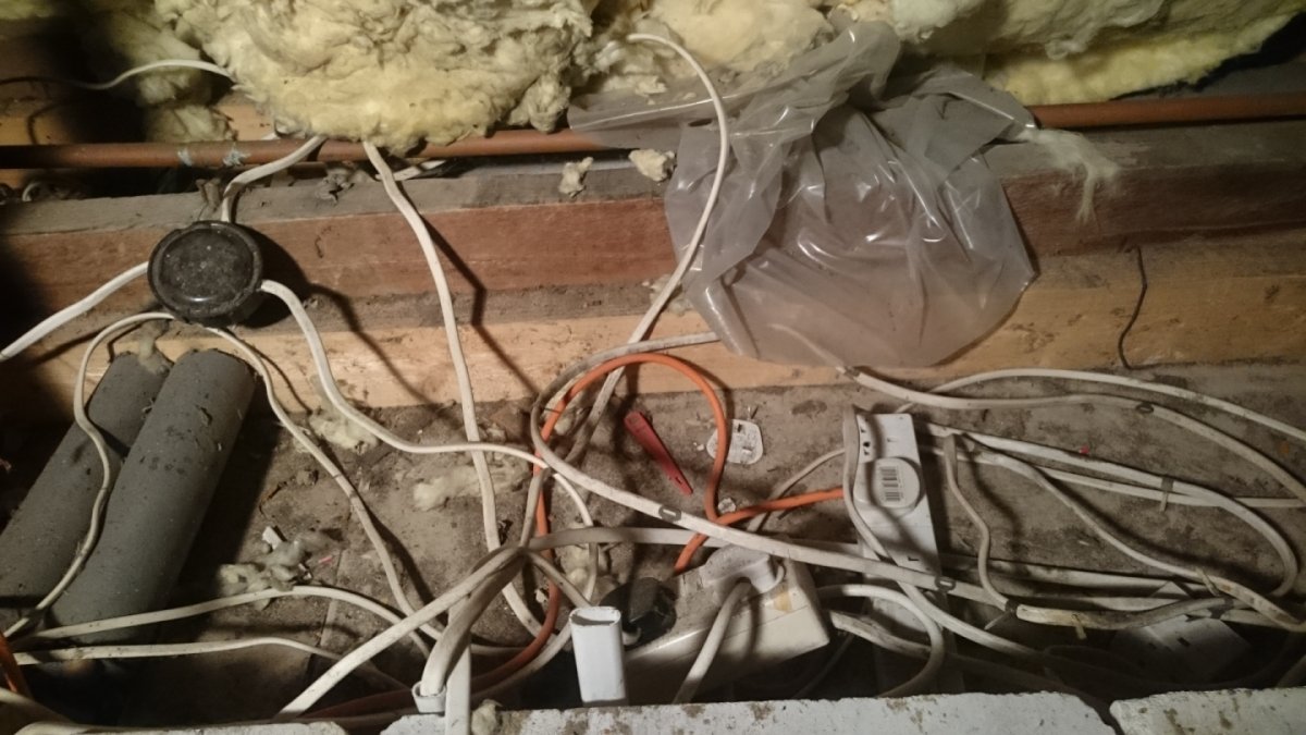

Sitting on the PC today, just about to start a game of tanks. Sunday morning, just had breakfast, kids all playing happily... lovely.
PC dies instantly, lights go off. I mutter "oh *******s" and wander through to tell them all there's been a power cut. But there hasn't. TV is on okay, and wife is listening to radio. I check fuse box... nothing. Now It's only the extension that has no power. I'm concerned.
Now we bought this house a few months ago, and the extension wiring is definitely on my list to get checked (there were a few cowboy signs visible) but I thought I needed to find the problem (electrics, fires etc) so I climbed up into the extension roof space gloved and masked, and hauled up the fibreglass insulation.
Now prepare yourself, this is what greeted me:
Yes, that's lighting and wiring connected via a 5-gang extension lead, which is in turn plugged into a 2-way socket, hanging on the end of a spur from the ring. The fuse in one of the plugs had blown. This has got to rank up there as some of the worst wiring ever seen.
Unbelievable.
I've disconnected everything except a single feed to the boiler which should make it safe. I'll have to get a sparky round this week as this job is probably beyond me. I'm hoping the sockets and light circuits are all good so I don't need a full rewire.
But I reckon probably either a consumer unit for the extension, or fitting of a proper new ring and light circuit to the existing board, but former probably easier.
Some people just need shot...
Oh yeah, I thought about that. But the extension is really just a sort of garage conversion - the roof and walls are all original, really just internal battening and plasterboard. Nothing complex about it, and nothing structural. But it looks like they've got some dumbo mate to just rig up extension cables from the one proper socket that's there.
I'm really debating what to do here. One hand says just fit a 13A in-line fused switch with RCD and tidy up all that wiring, the other says fit a new garage CU and re-wire. But you can't fit a CU to the end of a spur, and don't think I can find the ring main to break into and wire the sockets correctly.
Might be best to move this to the electrical forum. Where is your main consumer unit in relation to the garage/extension and what appliances do you intend to be using? I'm guessing the load exceeds 13a otherwise the fuse wouldn't have blown

Looks like you have the pipes going through the bottom edge of that joist too, then it's be kind-of doubled up.
Nozzle
Yup, that's for a radiator in one of the rooms. Unbelievable because there was absolutely no need - as you can see it's not floored or covered, and there's an older (soldered) joint and pipe passing over the joists as well. As I say, I've been in the house a couple of months, I think I'm going to find some interesting stuff...
If that orange stuff is what I think it is, there'll be no cpc to whatever it feeds....

The stuff I was thinking of was the two-core stuff typically fitted to Class II mowers and trimmers etc...
