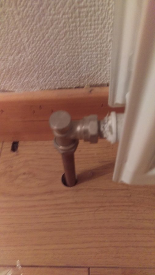

It's a Danfoss RLV-D. Very neat little valve.
the cap unscrews and an allen key is used. I have an idea it is about 6mm. You get one free with every valve. A clever person might have looped it on a pece of string and hung it on the bracket behind the radiator (like I do).
It matches the Danfoss RAS C2 TRV
Look near the bottom of the instructions page
http://heating.danfoss.com/PCMPDF/013R9355_RAS_C2_Keymark_VISXM302_.pdf
