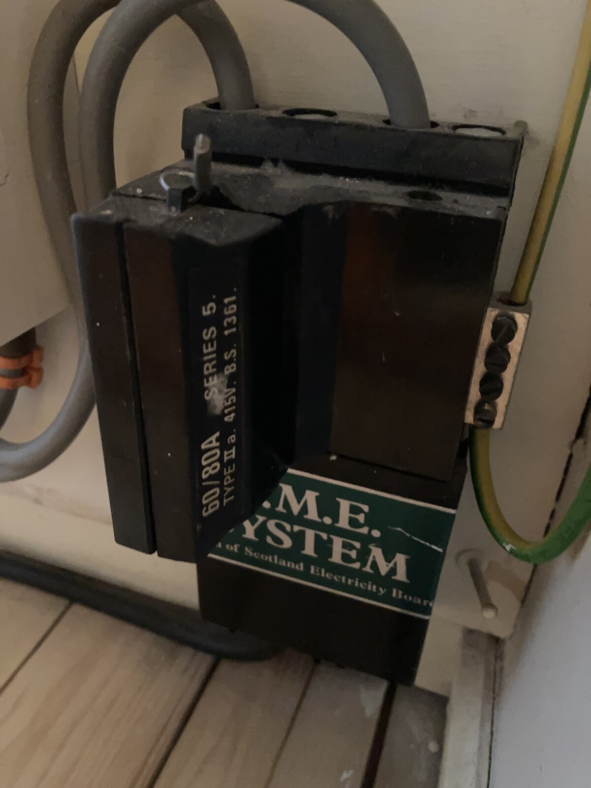

Hi
is it easy to remove this 60/80A fuse to cut supply to the CU? Simple as cutting holding wire and pulling?
cheers
daljit
That may be what some do, but officially you need to fit an isolator and get the DNO to transfer supply to isolator. Or get DNO to disconnect and re-connect latter.
What actually happens varies area to area.
The seal is there for a reason. Cut it and you may have to prove to the supplier and/or DNO that you have not been stealing electricity.
Pull the fuse and the fuse holder may fall apart, this might result in a short circuit across the incomig supply. Fuse at the electricity substation will be at least 200 Amps which will mean the arc ( in the short circuit ) would be more than 50 kW.
Cutting the seal breaks the terms of your contract with the supplier. Pulling the fuse can creates a dangerous situation

Hi all
I appreciate the words of caution, I really do. I’ve seen these fuses in the stairwell of tenement flats, and aware electricians remove them to cut supply to specific flats. I imagined them to be similar to the old style fuses, which although exposed to hell, seemed pretty safe to work with. I’ll investigate further. Thanks again.
Daljit

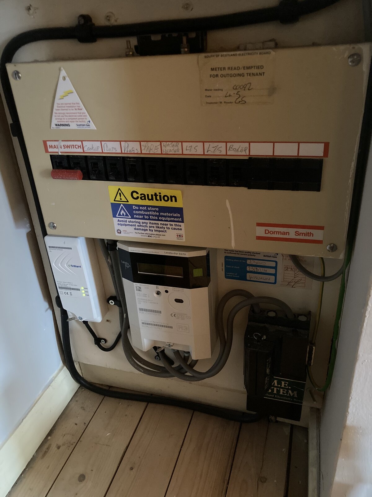

You forgot examining the cutout for signs of damage/overheating, ensuring it's securely fixed to the wall, checking for surface voltages on it, ensuring it's not a type that's unsuitable to open or work on, and the rest of the protective clothing, and having the appropriate insulated tools readily to hand in case it goes wrong.
There is a smart meter there. While many think the reporting features of the smart meter is a myth, it WILL inform the local DNO of its outage, and depending on their algorithms, will flag a possible issue. They may completely ignore this (Storm Arwen keeping them busy), or they may send an engineer. If the meters mpan is in area already flagged with an outage it will be ignored. The algorithms vary hugely by area though, so while some would be ignored, others would be investigated. Most likely just slapped wrists.
