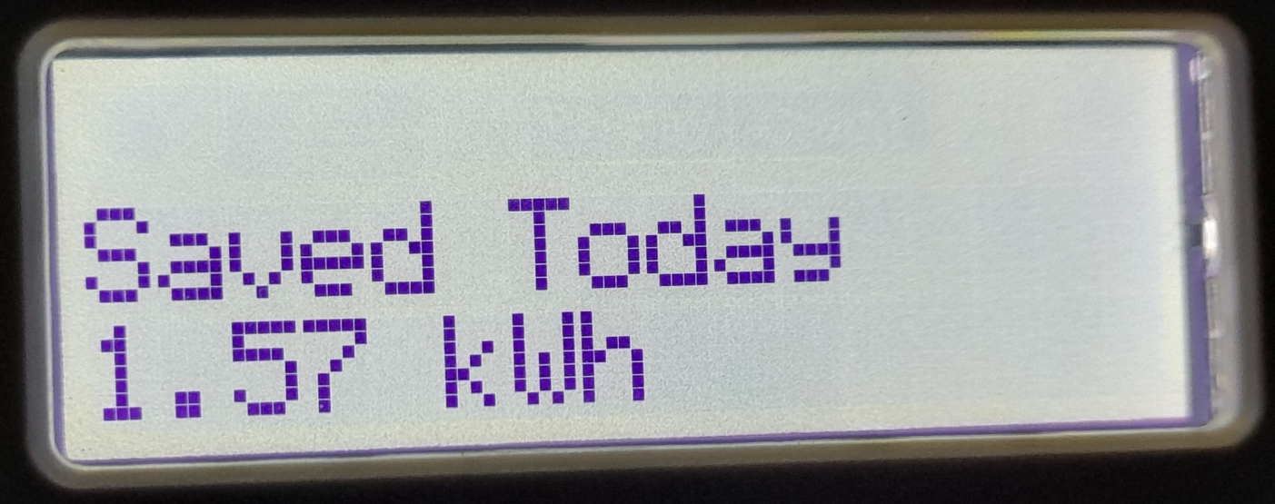

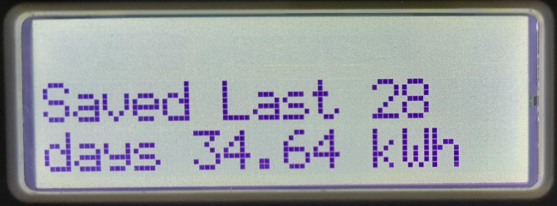

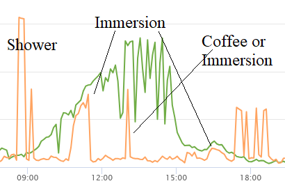

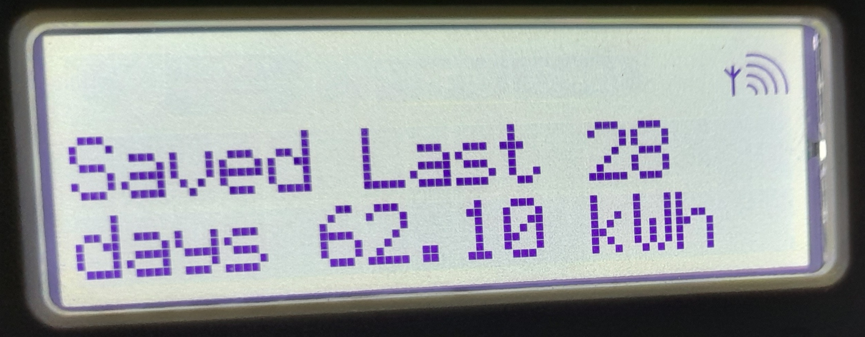

If I look at energy use, the immersion follows the solar production, so two peaks are the immersion, the peak between could be either cup of coffee or immersion, but when it fires up there are no losses, where with a boiler there are.
Note:- The iboost+ means my immersion does not always use 3 kW, it just uses the excess, so the first and last curve is following solar production. 1785841600836.png The bar graph from a smart meter is useless, I can only see my use because of the solar software.

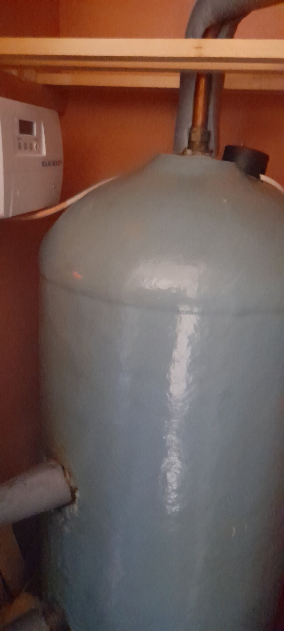

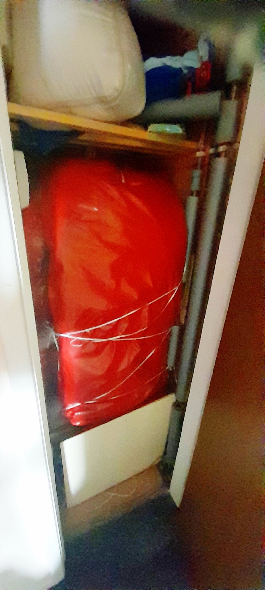

As to 9" v 28" nothing. When I moved in there was a very short one fitted, and I got it swapped for a longer one, and electric use did go up, but get a dull day so no solar heating, and hot water lasts until next day.
I also tried fitting a jacket, it was an insulated tank, but not that thick, so thought the jacket would same money, hardly made any difference. The saved today 1785844134169.pngcan vary a lot, as can last 28 days 1785844389183.png near double what it was a year ago, as to why, not a clue. Must have used a lot of hot water for something.

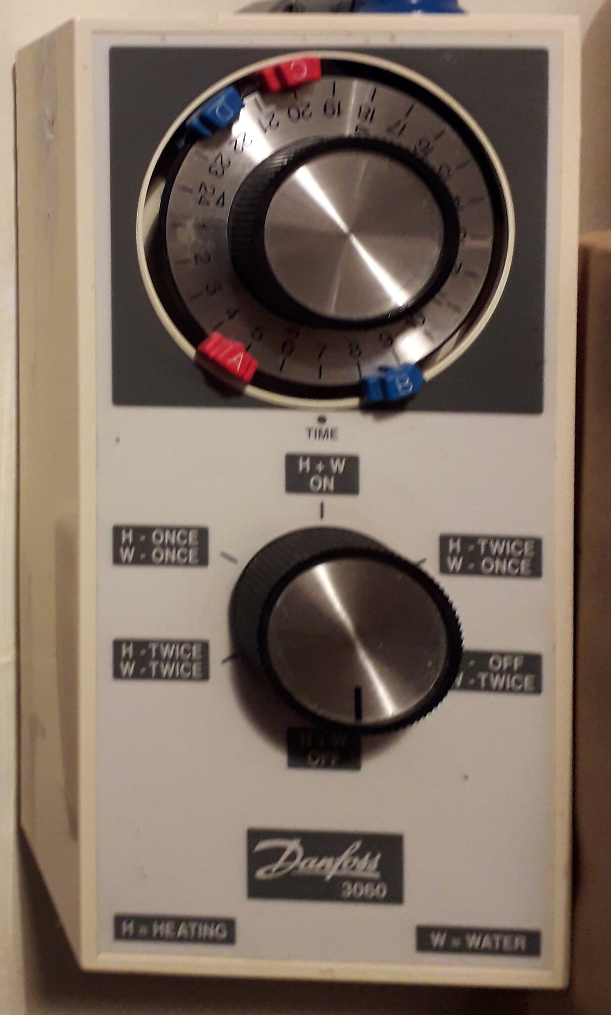

With my C Plan and no tank thermostat it was a suck it and see, and ½ hour 4 times a week not enough, so needed once a day, which likely only heated it over the 60°C needed a couple of times a week, and I was worried about legionnaires, and was considering using the immersion once a week to be sure.

So only with a system boiler do you have the option. But my old programmer would only allow 1.5 hours minium run time, so time alone was too long, and the thermostat alone would trigure multi times a day, so it needed a combination of both to keep costs down. And clearly distance between cylinder and boiler was going to change how efficient. Pipe lagging was pointless, as pipes were cold by the next time it fired up. Winter does not matter want the heat in the house, it is the summer where there is a problem.

I wanted a wireless thermostat to work the DHW in summer, the programmer Danfoss3060programmer.jpg would only go down to a 2-hour burn, but when swapped for Nest Gen 3 I could set to ½ hour, the tank would stay warm for around 3 days, so experimented with 3 and 4 days only a week, but worried about legionnaires so once a day, the immersion at around 9" would not span a day without enough sun, so increased the insulation, but it had little effect. Tank before lagged.jpgTank after lagging.jpg You can see the iboost+ controller in the first picture. The longer immersion heater 27" does mean I can span a day, and it also uses a lot more energy, I did look at the Willis system, but the cost for the savings, was just not worth it.
