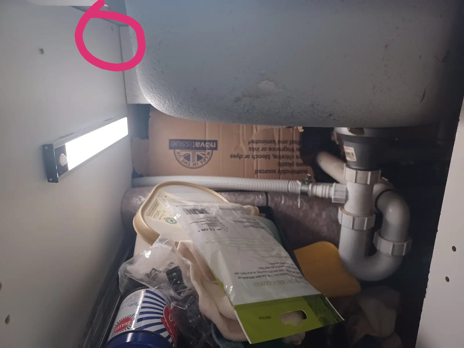

Dishwasher on ground floor - plumbing issue?
Hello Themoo,
Make a hole about here (or see if there is a gap under the worktop) and pull down if the hose is long enough. If not, you will have to buy an extension hose and cut to length.

So it needs to shoot up and then down again, just not with all the length that it did have.
Is it expecting too much if I ask the plumber to come up and sort this? I kind of thought he would know what he was doing with this kind of thing.
Are you sure he is actually a plumber? He does seem to be completely lacking in the common sense of basic plumbing.
High Loop.
