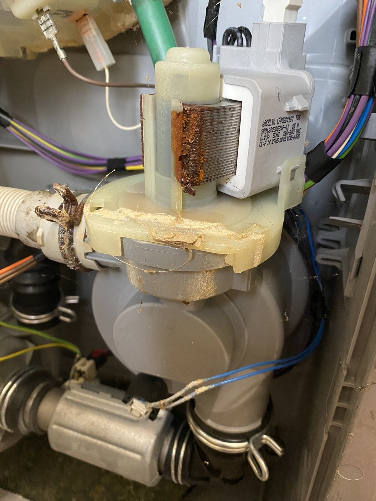

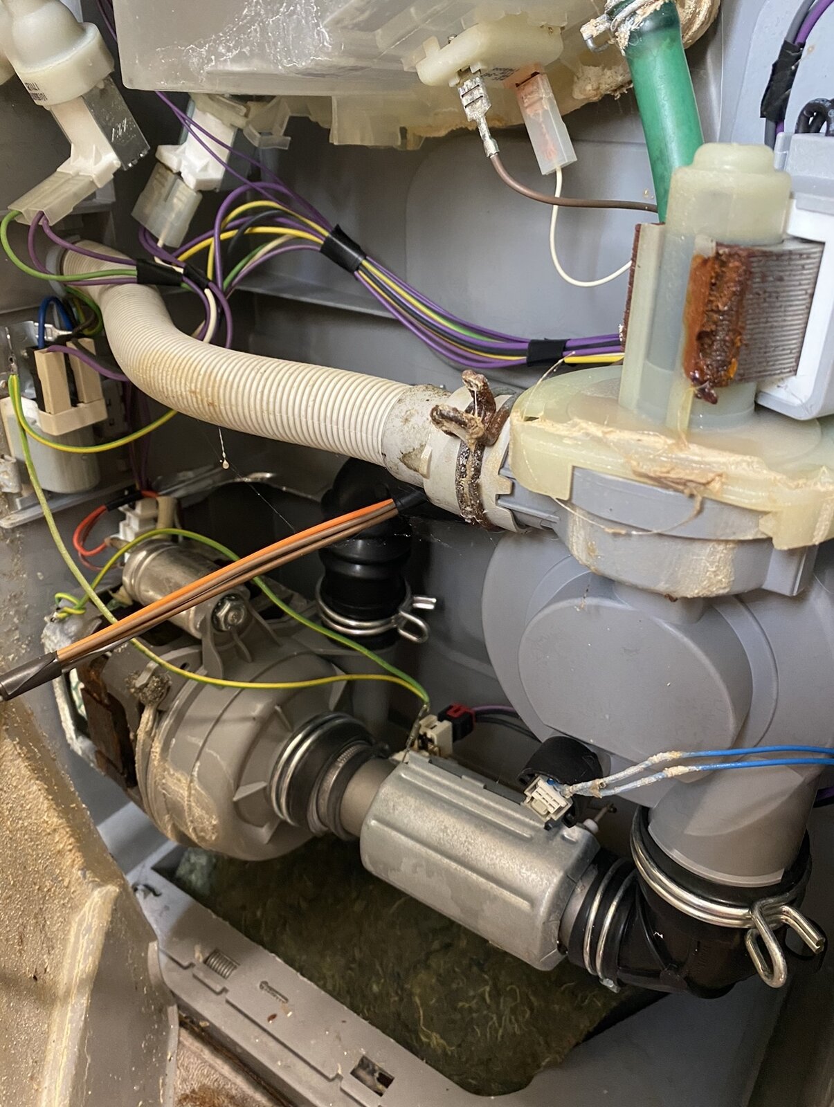

Hi I have a Beko Dishwasher. It’s about three years ago and it really hasn’t worked since I got it. Every time it powers in, does the wash cycle and when it gets to the drain cycle it blows the fuse in the box. Today I’ve laid it on its side and got the bottom panel off and the insulation blanket at the bottom is wet, the side one is dry. And there is rust on the motor and pump. The pump feels wet to touch. I can’t work out where the leak is coming from. Will I need a new pump and motor and how can I see where it’s leaking from? If I need a new motor and pump it would be about the same cost as a new machine. Thank you for any help.

Take the left hand side panel off and watch it fill. Most common culprit are the o rings air break to water softener.
Anti flood should have kicked in before reaching the pumps.
