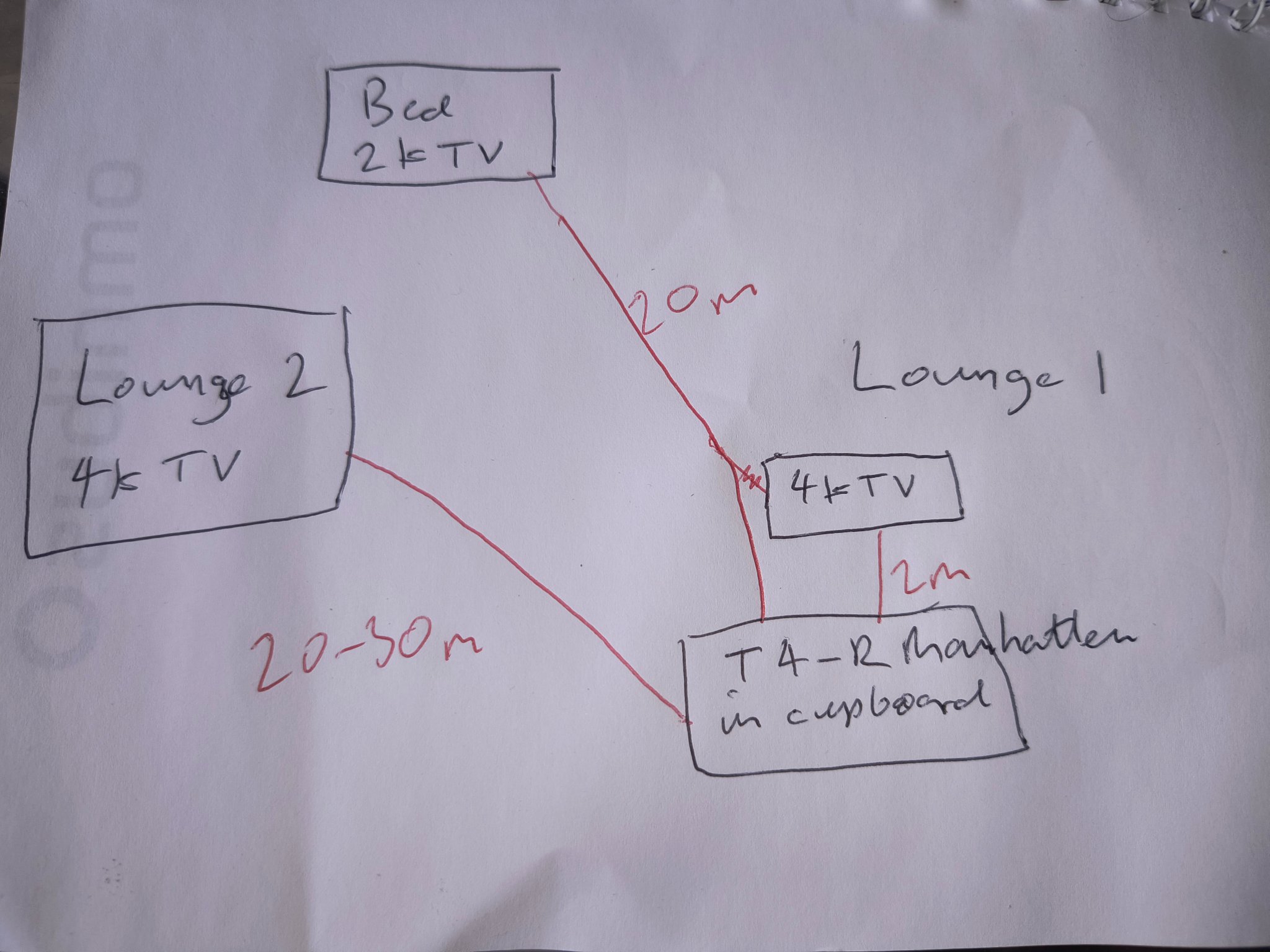

I need to achieve this:
I originally thought a 1 in 4 out HDMI splitter and long HDMI cables but think I was barking up the wrong tree and I should be looking at splitter, adaptors and Cat 6 cables? I think I'm ok with the ir remote extenders (they'll plug into to adaptors).

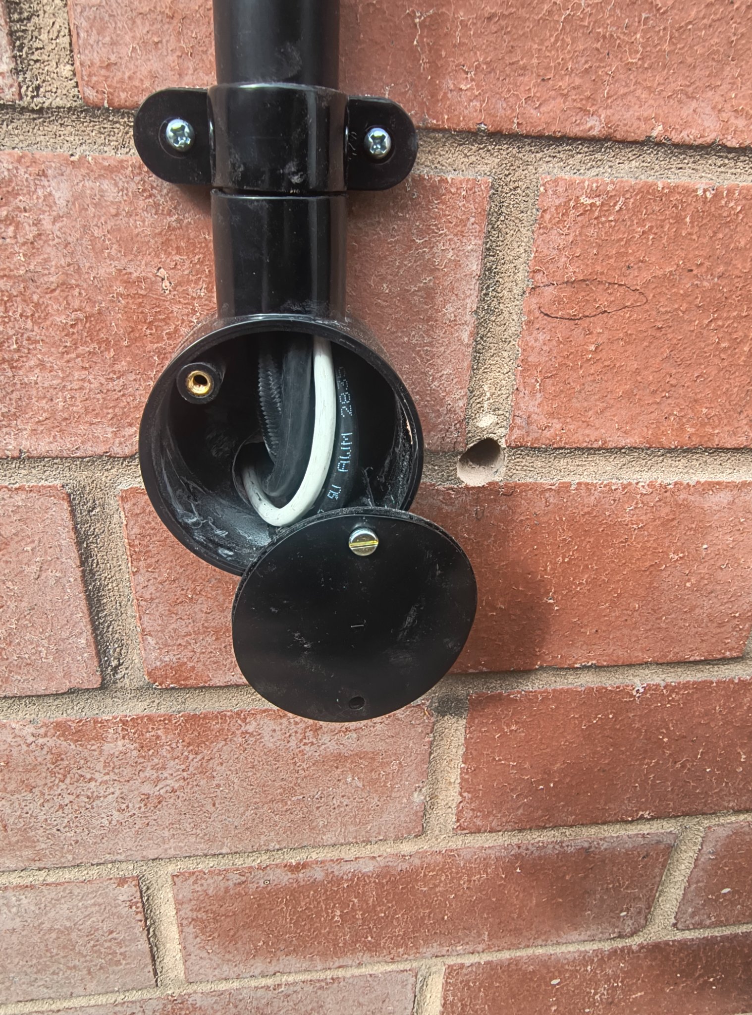

The cables will need to run partially outside (about 5m) - will two cables with plugs, and a single WF100 fit in 20mm round pvc trunking?

Edit - I think the run to the bedroom could come in at under 15m so could I get away with a hdmi for that? and would it go through the trunking?

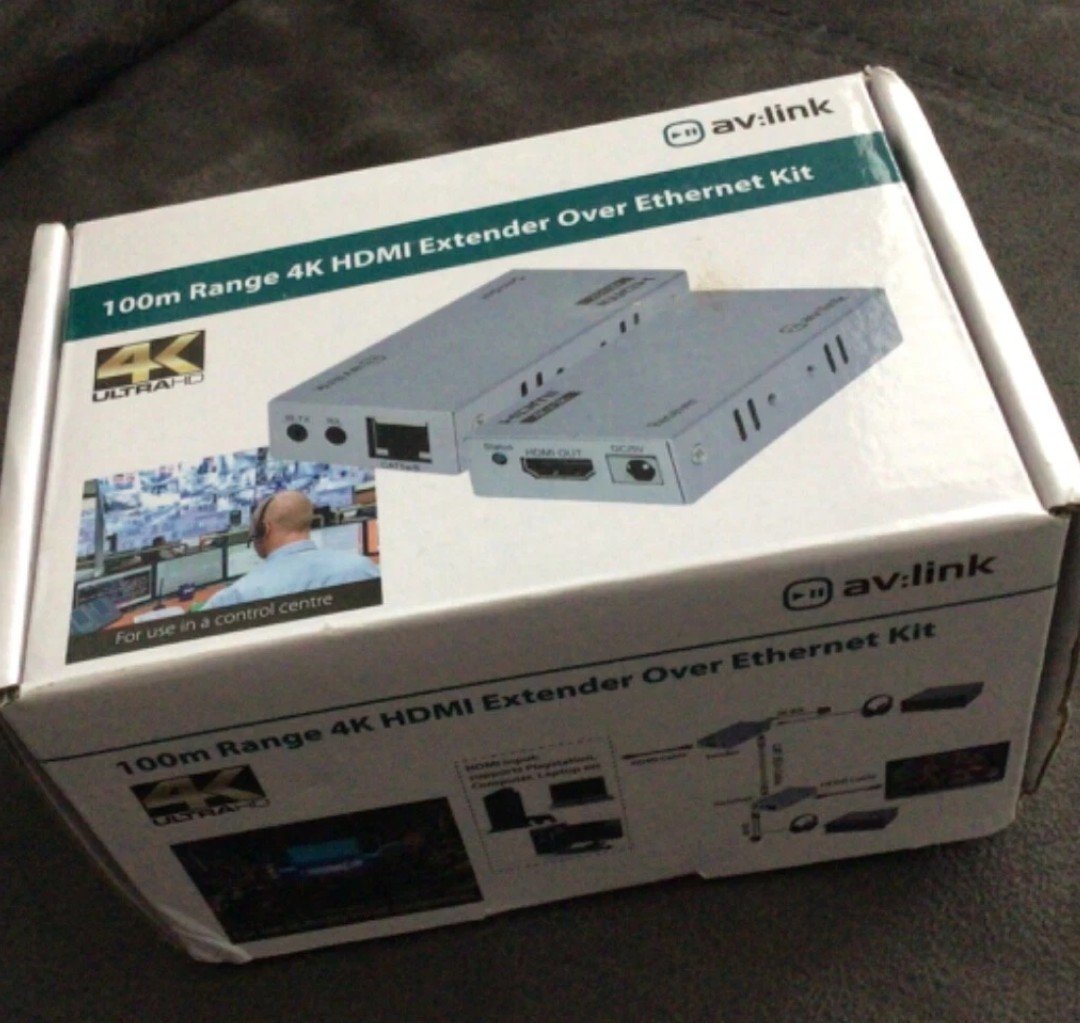

Wanting to view / control the Manhattan PVR from all three locations as 1080 HD stuff then you could use HDMI over Ethernet cabling with suitable units (check how far they will support) or a DVB-T modulator over the coax aerial distribution (NB stereo PCM sound only)...
You can get a couple of coax and Ethernet cables inside 20mm conduit with care of use external grade Ethernet cable clipped to the walls. Beware making too sharp a bend on WF100 cable!!!
You won't get a standard HDMI plug through conduit.

We want to record stuff on the Manhattan recorder anywhere downstairs and have it available on the TV upstairs and vice versa.
We have the same setup at the moment, only 2 rooms not 3 with an obsoleteish hdr1100 and an old 20m hdmi lead from lounge 2 to the ancient bedroom TV (being replaced by the 2k one) (before that we had the old sky sent upstairs Via the second output and a coax cable) it works - wife can go through the radio times, record loads of stuff and watch/resume/skip ads from anywhere. Our internet is ok but we find that everything is full of ads and when you watch crap crime documentaries on C5 they repeat half the program after every advert and the introduction takes 3-4 minutes so we can just skip it all.
So - same as we have now plus an extra TV all in modern quality and Freeview instead of Freesat.

Check out / search on AVForums for others who have done similar HDMI over Ethernet cable solutions? There may be brands to avoid!

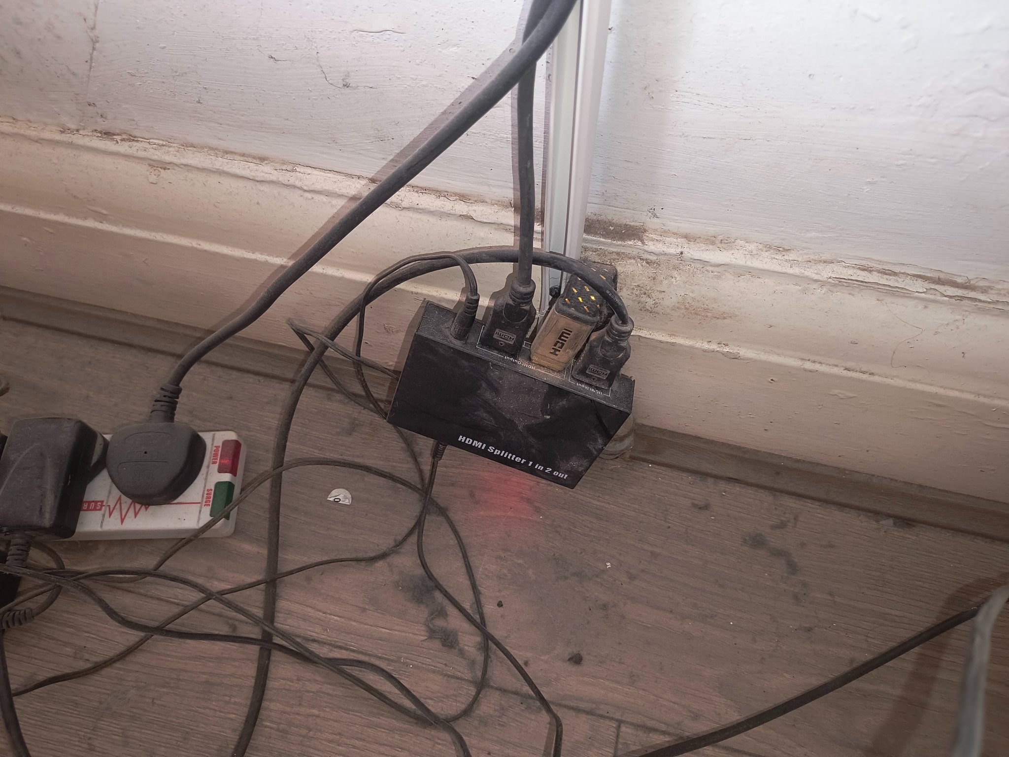

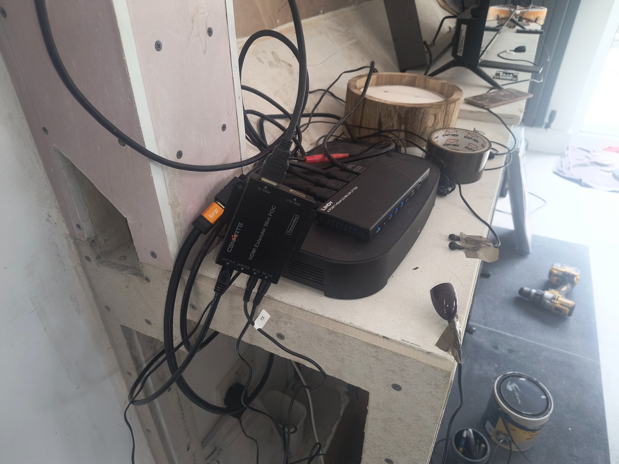

Split the output from the Manhattan to all 3 TVs via a Lindy 4 port splitter
- to the (2k) bedroom TV with a 15m kabeldirekt hdmi cable and a PSG3401 IR Over HDMI Extender Kit,
- to the TV in the same room with a 3m hdmi cable and an IR blaster so the box can go in a cupboard,
- to the second downstairs TV with a Cenmate HDMI over cat 6 extender incorporating a IR remote extender and a 15m cat 6 cable
The external trunking (25mm) contains the hdmi cable to the bedroom TV, the aerial cable from the loft to the Manhattan, the cat 6 from the Cenmate to the second TV and the single sat cable from the sky to the TV. A bit tight but they fit.
