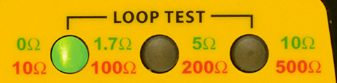

I have looked at socket testers, without a loop test they tell you very little, good in a caravan to ensure correct polarity, but of limited use, the ones with loop have the pass far too high for a ring final, typical 1.9 Ω where the pass mark is 1.38 Ω, and with the RCD test it is often way over 30 mA so it tripping does no better than pressing the button on the RCD/RCBO.
It is better than nothing, but the danger is it will pass when not within spec, giving a false sense of security, I spent 12 weeks doing a night class of 3 hours, so 36 hours to learn how to inspect and test, OK also time doing the practical exam so not quite that long, and I have modified my ideas since doing the course and exam, for one thing the codes changed from four to three main codes.
I have I will admit considered getting a cheap £50 plug in tester after my loop impedance tester failed, saves borrowing my sons, and to hire at around £60 for the week does seem a bit steep, but then it would be a proper job.
Before my loop impedance meter failed I would use it before and after working on a socket, if the reading before was 1.23 Ω and after it was 1.35 Ω it rang alarm bells and I would remove socket again and test to ensure ring was still a ring etc. So it was a very good tool, but a Martindale EZ365 is around £64.80 and it
as seen here says between 0 and 1.7 Ω but pass mark is 1.38 Ω so what is the point? OK for a TT shows under 200 Ω which is far enough, and with a radial 1.7 Ω is normally a pass, but in the main in the UK we have ring finals.
Before my loop impedance meter failed I would use it before and after working on a socket, if the reading before was 1.23 Ω and after it was 1.35 Ω it rang alarm bells and I would remove socket again and test to ensure ring was still a ring etc. So it was a very good tool, but a Martindale EZ365 is around £64.80 and it View attachment 326302 as seen here says between 0 and 1.7 Ω but pass mark is 1.38 Ω so what is the point? OK for a TT shows under 200 Ω which is far enough, and with a radial 1.7 Ω is normally a pass, but in the main in the UK we have ring finals.
