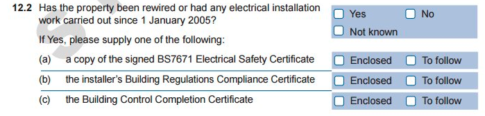

That sort of 'depends'. The question you will have to answer is usually of this form (from a standard conveyancing "Form TA6") ...
Despite what it says, I don't personally think it was really intended to mean "any electrical installation work" but, rather was only really intended to refer to "notifiable" electrical work (a concept which only arose on 1st January 2005). Apart from anything else, the documents (b) and (c) it refers to will usually only exist in relation to such 'notifiable' work - and, as for (a), there is actually no such thing as a "BS7671 Electrical Safety Certificate"! The latter is probably an incorrect attempt to refer to an Electrical Installation Certificate or a Minor Works certificate.

On buying this house I was presented with the installation certificate and compliance certificate, made out as if for whole house, it turned out it only covered the flat under the house.
@JohnW2 picture
upload_2021-11-16_3-16-45-png.250877
is I think a standard form, and there is no reason why you should not complete a minor works certificate yourself for bits not requiring notification, this means you can say yes to electrical work being done, and include a copy of the minor works certificate so you have told no lies. Saying no it could come back to bite, but if any certificate is provided for any bit of work, your not lying.
