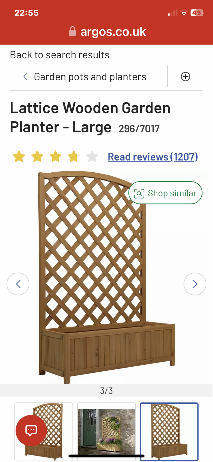

Quick and cheap option is to use a planter fence which will enable you to mark your boundaries without any damage to your drive.
