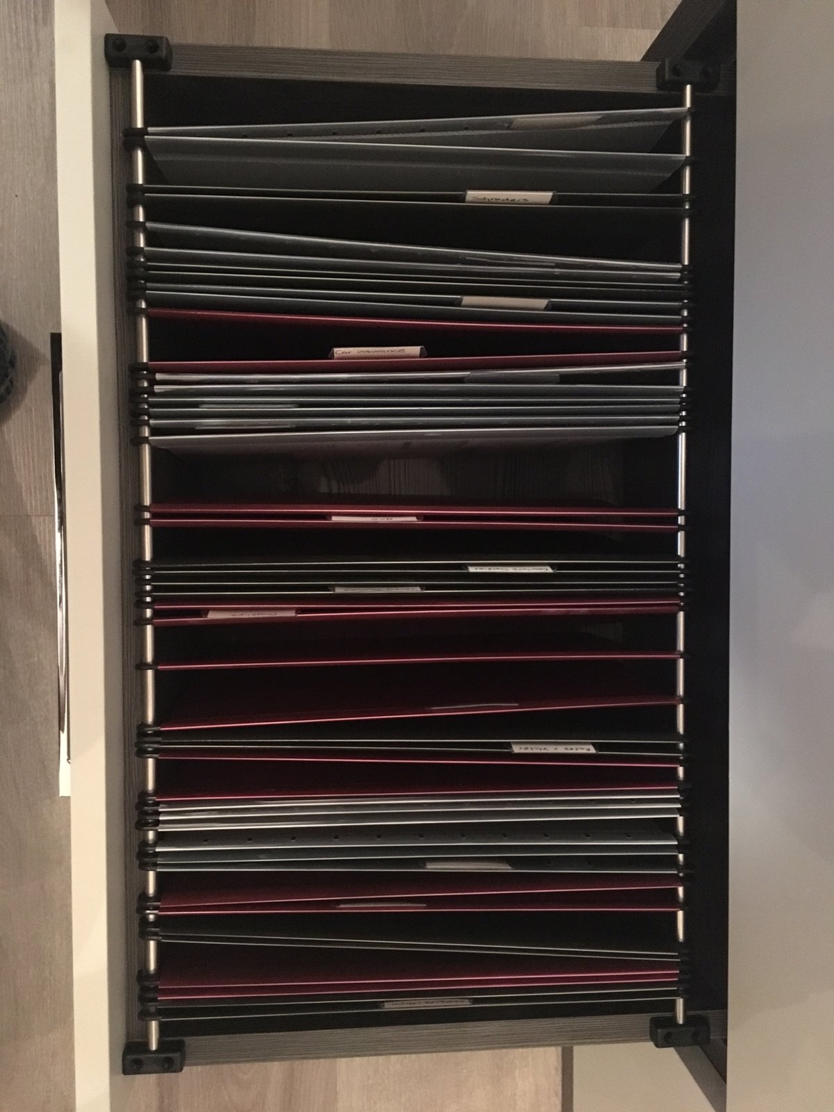

Just to add, I've used pipe clips to hold my net curtain rails in place (15mm dowel, 15mm clips), and that doesn't move at all (although it is wood, more friction). If that arrangement did move for you it's nothing some insulation tape wrapped round the rod wouldn't cure. The one in pic is a Talon 15mm pipe clip. 8mm is a micro-bore size I believe, so you could perhaps find similar pipe clips for 8mm. I know they do 10mm ones.
full
Cheers for all the help, first time poster so really appreciate it.
I've gone for the modesty blocks in the end, despite dismissing them initially, they are quite a neat solution. See picture of how it looks. Drilled an 8mm hole and the rods are nice and snug, just need to get some black screws and I'm set.
