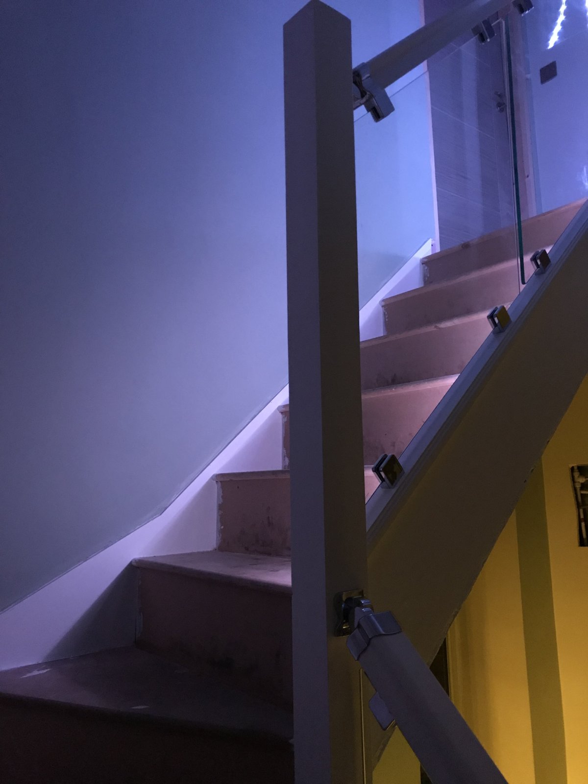

We did a loft conversion with the new stairs over the existing so could either do the new to match the old or start again.
I liked Adam182’s stairs so asked him for some advice then had a go myself.
I decided to use some adjustable handrail brackets to save me cutting angles, they were £12 each, I got the hand and base rails from the same place:

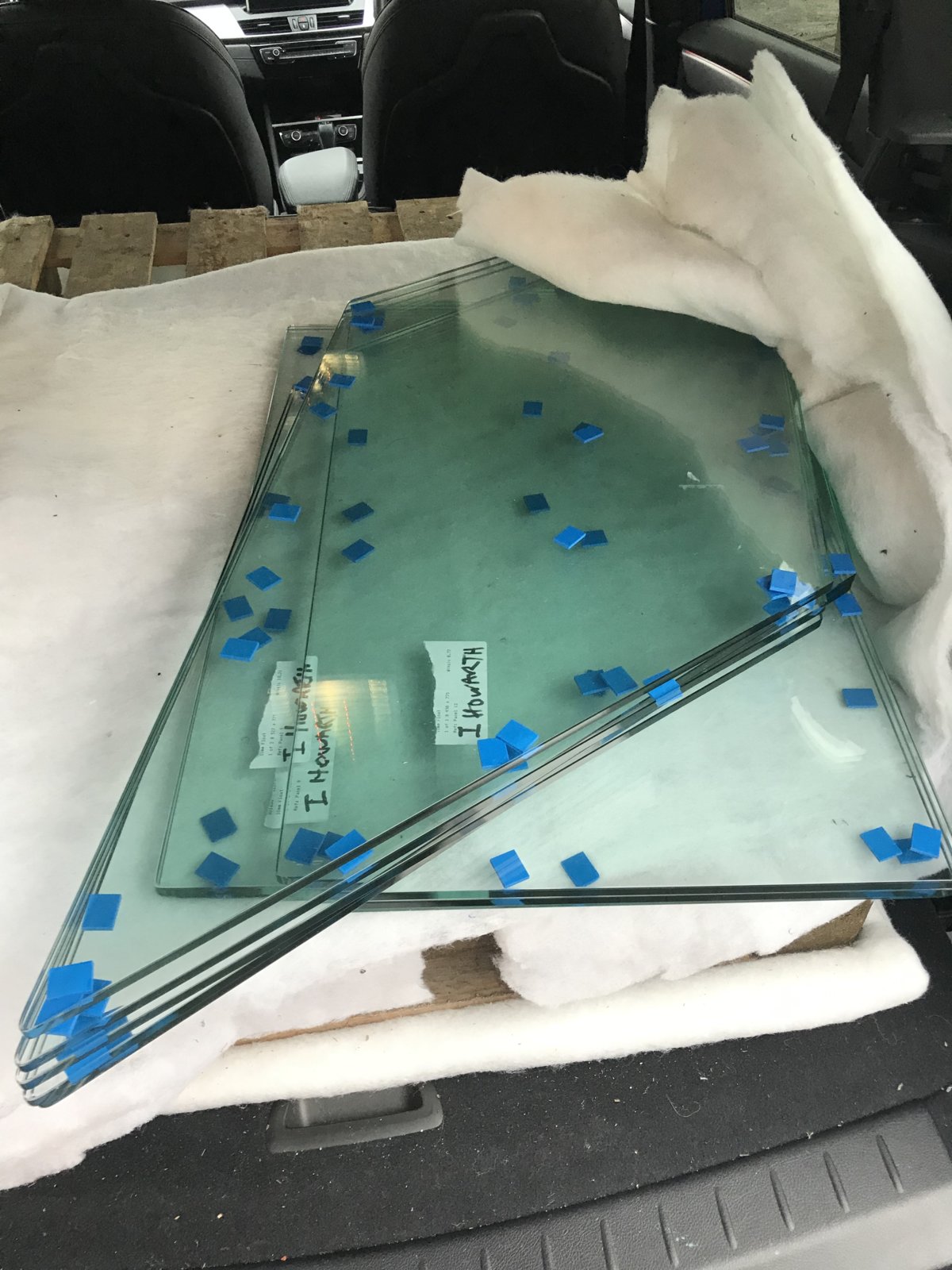

Then the glass I decided on 10mm toughened, first price I got was £650 for 10 panels but I ended up paying £374 from a place called Diomet in Sheffield:

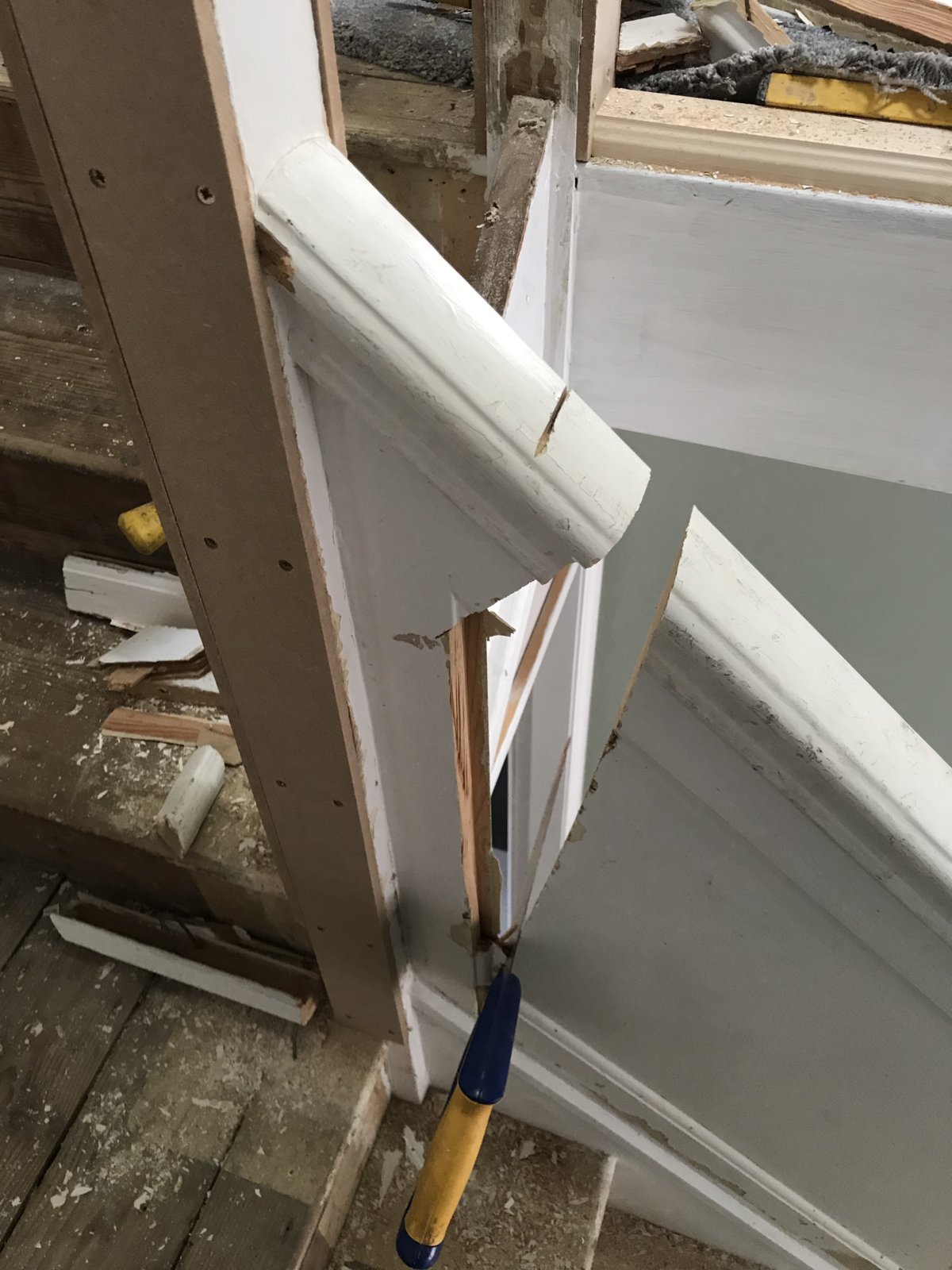

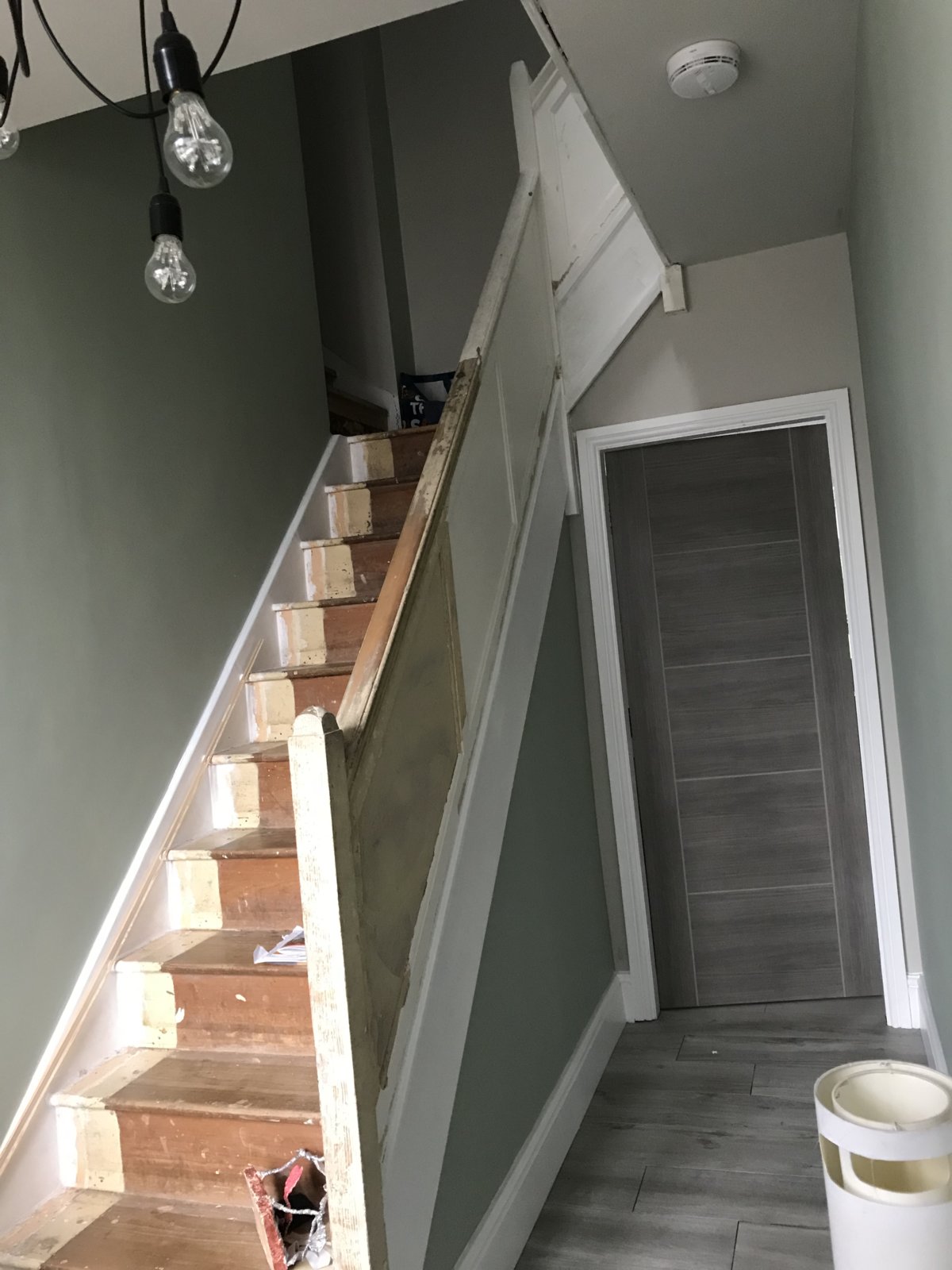

The old stairs were panelled:
So I hacked them out:

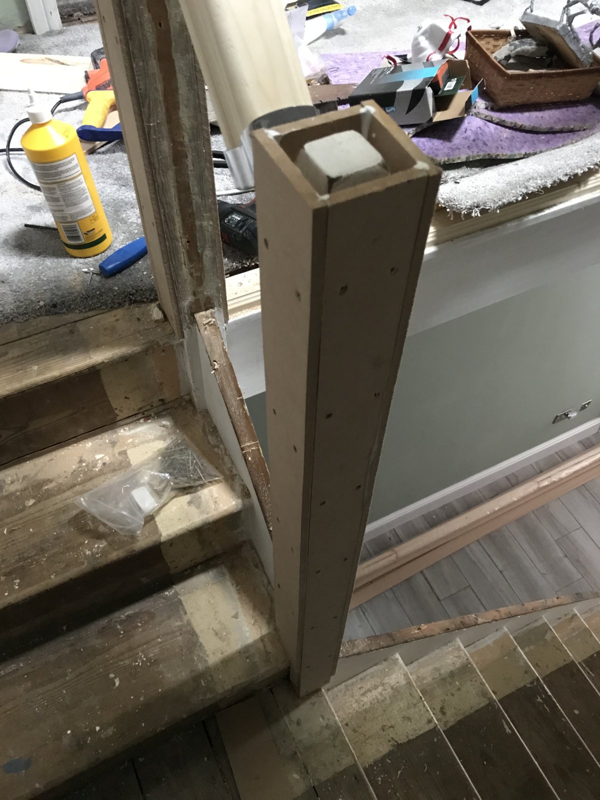

Then I used MDF to fatten the old newels to match the new:

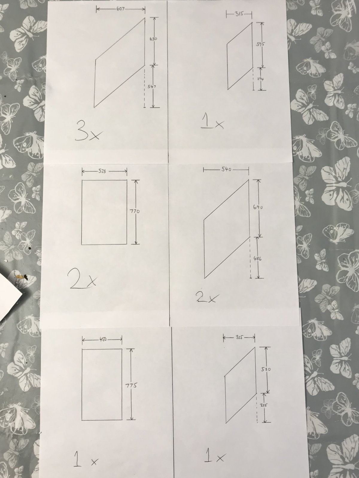

I used an old school steel and glue finder to measure for the glass, I did that 3 or 4 times to be sure:
Ordered it and collected it:
Moment of truth and my measuring was good :)

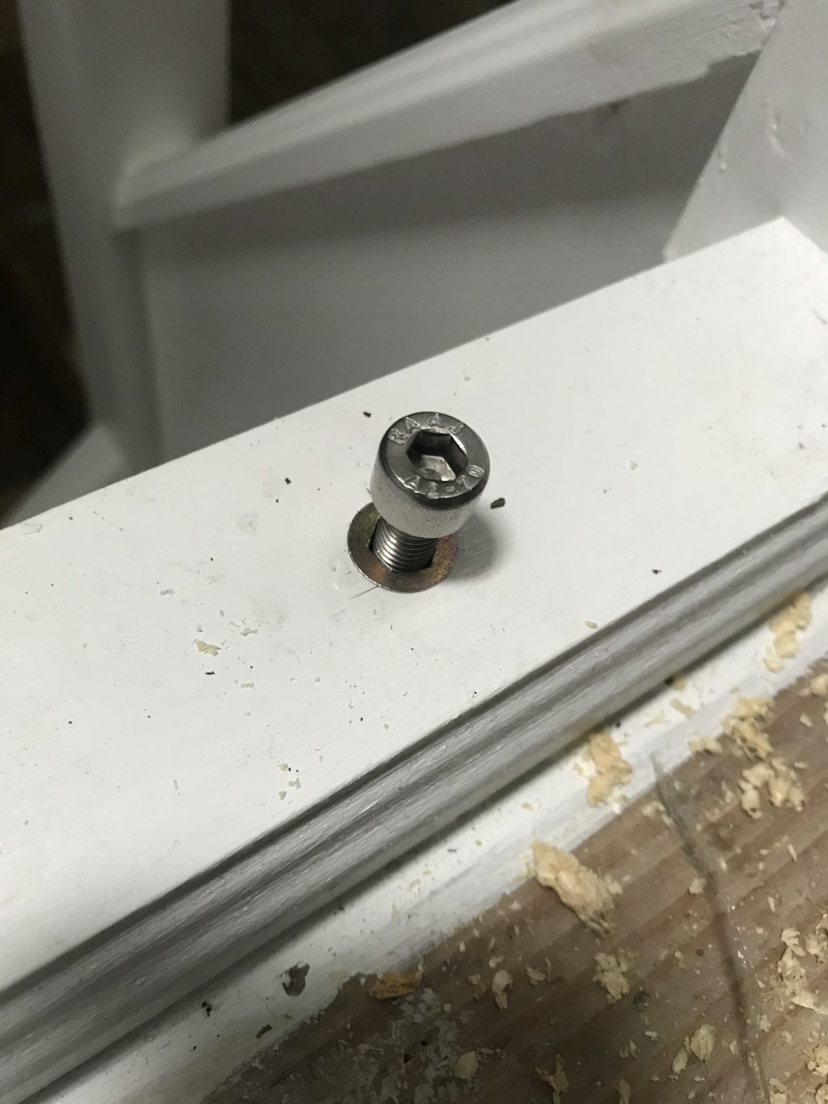

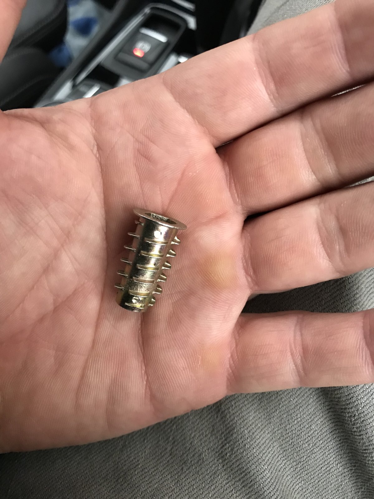

I first fixed the brackets with screws but after doing the first one I found they were no good so found some M8 inserts:
So I could bolt the brackets in:

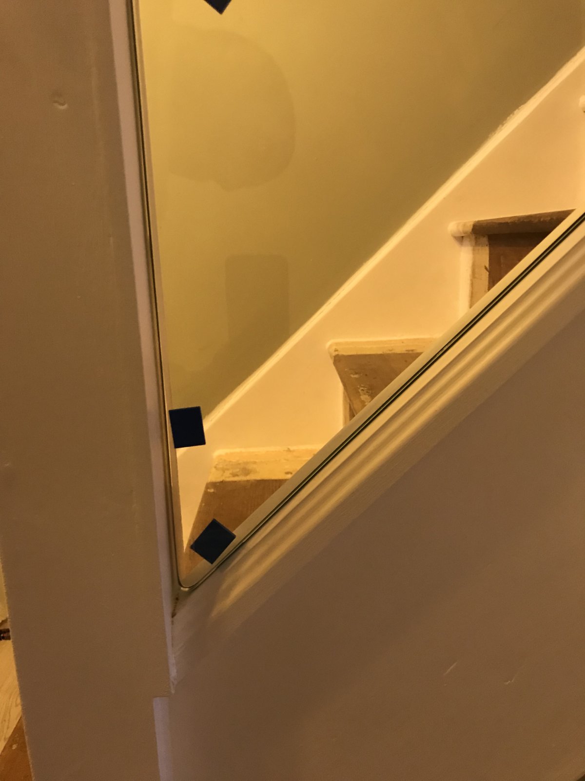

Then the fitting was easy, I used a 20mm spacer all round and fitted each panel at a time:
The bottom brackets actually hold the glass on their own while I fitted the handrail:

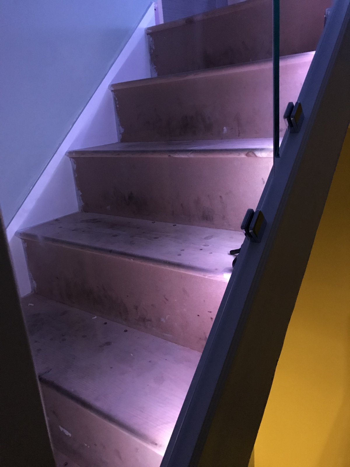

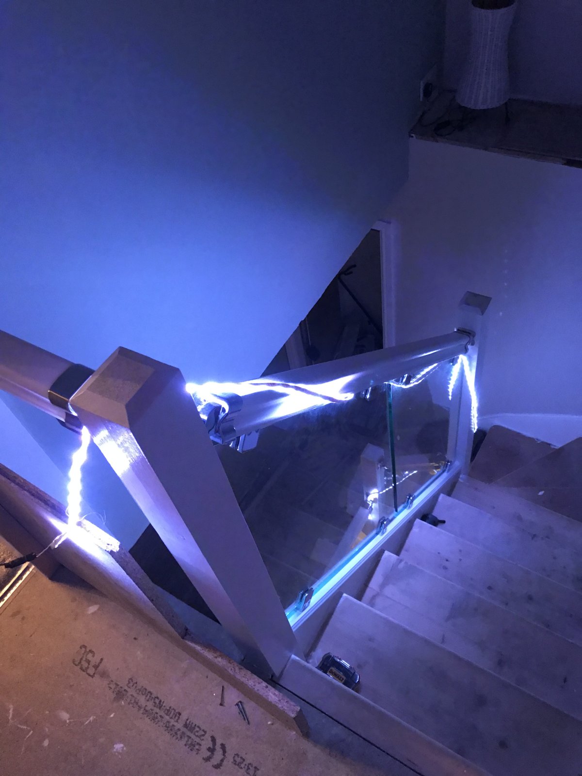

Not a fan of glass , but then I don’t have to clean it . If I used glass would run led strip under handrail to illuminate it at night .Good job.
I did think of putting one under the edge of the base rail if I could find a switch small enough.
I use a remote control switch on some on my led lighting .

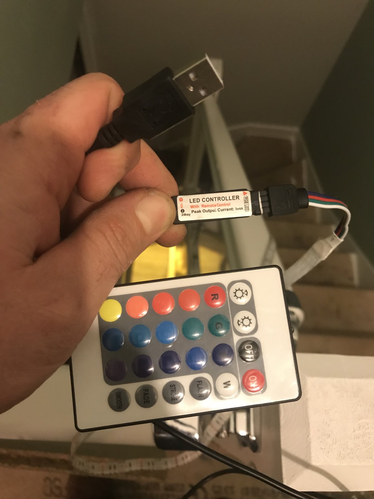

Did you shorten any? I’ve got a piece here that’s 4mtrs long and remote control but the stairs are only 2.6mtrs.
It’s USB on the power end so not sure how I would join that to the light power under the landing floor.

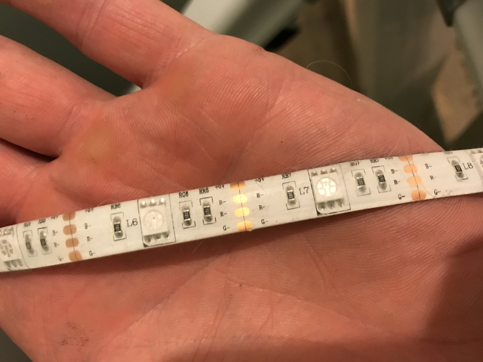

This is it, it was very cheap:
It would fit under the edge of the base rail if I put some fresh tape on it. It’s been in the kitchen for a couple of years.
