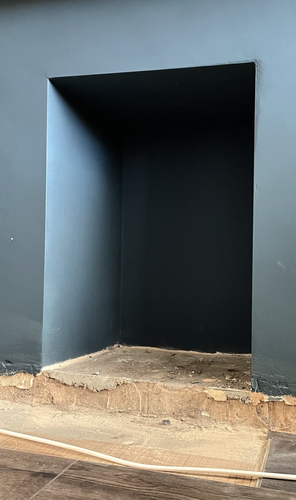

Hi all. I am wanting to make my own hearth - purely decorative, not for a burner. Has anyone made one before? I was thinking laying some tiles over paving slabs. The height of the concrete floor to the lip of the recess is 70mm so would probably have to stack 2/3 slabs on top of one another (stretcher bond). Ideally, I would have lowered the base of the recess but it would mean having to get it all re-skimmed at the bottom.

Why not cast in concrete in situ and tile on top of it. Make concrete height less tile and adhesive height.
Is there a real chimney above that fireplace? If so i'd suggest as above-poured concrete and tile on top. Take some pics, if you (or anyone else) wants to put a burner in there you/they know the hearth is up to the job.
Thanks both - I’ll go ahead with pouring concrete in situ - and yes there is a chimney so it would future proof. Daft question but how would I secure the timber frame onto my concrete floor? I don’t really want to drill as there is a risk of puncturing the DPM...
Its only 70mm- surround it with loose blocks or tubs full of water, couple of blocks sat on top of the shuttering to stop it floating. If it was deeper i'd say brace sides & front to nearest wall with bits of 3 x 2 or any other gash timber kicking around.
