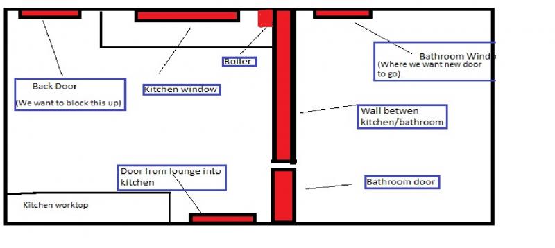

Hi all - I have been a fan of this website for a long time but never had the need to register until now.
Basically I am living in my Moms house (She lives with her boyfriend in his house) but she wants a kitchen diner just to improve the layout.
At the moment, our bathroom is downstairs. We want to move the bathroom upstairs into the box room and knock through the wall to open it into a kitchen diner (But leaving the boiler where it is)
The plan at the moment is to brick up the existing back door and move it to where the bathroom window currently sits. This would enable us to maximise the kitchen space.
So the questions I have are;
1. Bricking up the back door. Is it simply the case of removing the door, then a simple brick/block job to fill in the void?
2. The dividing wall between the kitchen/bathroom is a single brick skin. How do I find out if it is safe to knock down and is there any specific process to do it? (Supports etc)
3. Where the wall sits at the moment, obviously when we move it there will be a dip in the concrete floor. How do we fill it in to get it level? We will be having lino.
4. With the bathroom going upstairs, my Moms boyfriend mentioned something about having a soil pipe running up the rear wall with a vented top??? (Whats he on about here) I thought a bathroom needed a simple soil pipe running to the main sewer line and then an extraction vent?

Sounds like you need a builder who knows what he's doing and/or possibly a structural engineer. Given the questions you are asking I don't think you should be knocking down walls and installing WCs etc on the basis of asking random questions here hoping to find out everything you don't know.
You'll need Building Regulations approval for the work, which will mean proving to the council that the structural aspects are all sound etc.
Or find somewhere else to live and just let your Mum's boyfriend have at it with a sledgehammer.
As per Bas really, sounds like you are delving deep into B.C territory.
There are the thermal aspects of the build to consider as well as the structural ones and these may influence how the walls, floor and roof turn out regards finished levels etc.

The dividing wall between the kitchen and what used to be the bathroom is now down (I checked that it wasn't load bearing and you could see the single brick skin under the floorboards and it wasn't holding anything up)
I have used breeze blocks o the inner skin of where the outside door used to be and "toothed out" the half bricks. I am now having problems with bricking it up as I can't seem to get the existing mortar joints to line up with my new ones unless the mortar bed is huge which looks ridiculous. I've spoke to a few brickies who might help.
I'm happy with it so far and have proved that it can be done by a DIY'er, its all in the research and bravery to just have a go! Will post pics when everything is complete :D
No joists resting on it?
You're sure you are competent to make structural decisions like that? And your Building Control department accepted your plans for compliance with Part A?

Wow! Thanks for the interrogation - but yes I have had BC out and conformed with the long list of regulations throughout. They are happy with the plans and many of the houses here have done similar. My girlfriends brother is also a structural engineer and has ticked everything off informally for additional peace of mind.
No there were no joists resting on it, hence why I stated it wasn't holding anything up. The brick was built BETWEEN joists and wasn't even holding up plasterboard. It was simply there as a room divider. It doesn't take a genius to lift the floorboard up and reveal whats underneath, I think too many people get put off by peoples attitude towards "structural changes" when in reality, if nothing is resting on the wall it is simply the case of carefully taking down the bricks. Painstaking but easily achievable.

Your mum's fella was right regarding the soil pipe. It should continue up to roof level to terminate to allow ventilation of the drainage system. Assume you've done this if B.C. are happy. An extraction vent is required if the room does not have an open-able window.

For what it's worth, it sounds to me like you have your head screwed on, have come here for advice, which is sensible, and informed building control of your intentions.
I'm not sure what the concerns are with part L as I can't see where you have done anything that would have affected the thermal efficiency of the house.
You checked that the wall wasn't load bearing and had an SE on hand for advice. I'm a structural engineer but I don't think you need to be one to be able to work out if a wall is load bearing. It really is just common sense, which you used.
Er, no; sometimes it's not quite that simple.
Just because a wall does not appear to be supporting anything above, it does not mean that it is non - structural.
It can sometimes be intended for lateral support of the main external wall (Approved Document A stipulates a maximum length of wall between return walls, buttreses, or internal walls).
This is to ensure that the main wall is properly stiffened to resist lateral loads, principally wind.

Although it's not likely to be an issue in a small domestic building. I'm assuming this is a small domestic building if the only bathroom is downstairs.
