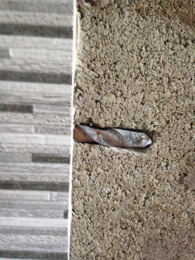

I found a mirror at IKEA that's the perfect size for an opening I have and only £20.
I thought of mounting in on s frame and putting a 3mtr strip of white LED's around it.

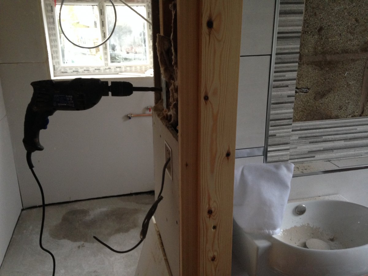

This is all an afterthought and before the room outside the toilet was plastered I drilled a hole and put a cable from the switch to behind the mirror like this:

Can you get a cable between the switch and mirror (where the drill bit is) ok? or is there one in place that cannot be removed? Can you get a cable between the switch and the ceiling/loft space? If you can do that then have a transformer/controller in the ceiling/loft space and then run the power cable down to the mirror from there.
I've put a wire where the drill bit was, I doubt it could be removed.
I think I would be able to get another down to the switch if I lifted the floor above it.
I was hoping with the wire from the switch to the mirror that it could come on with the ceiling light, as long as the LED's are not too bright.

Are you able to knock out/chase into that breeze block behind the mirror? If so you could possibly create a gap for the transformer/controller to go into. The concern then could be heat dissipation and moisture (unless its a sealed unit).
I could open up a block, there is only a small wash basin and toilet in there, no shower or bath.
