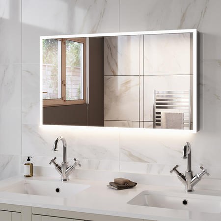

Here is the full link of the item I bought:
I've just registered for warranty on their website even though I bought this from a seller on ebay. I hope they will allow this as its a new-unused boxed item.
I am going to raise this as a case with them once the warranty registration is successful, as it seems there are multiple ways to address this issue.
