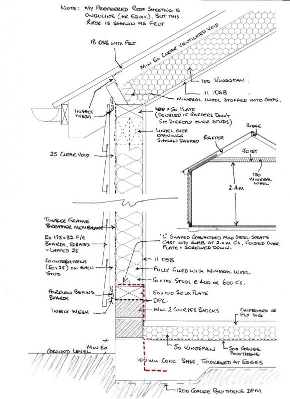

I am currently designing a workshop for my back garden. Footprint is 7m x 3m with a height of 2.5m (pent roof).
Was planning on building a 4x4 timber base frame (which will sit on an appropriate concrete base) and creating 3x2 stud walls that I can screw into the 4x4 base frame.
Plan was to then clad the outside of the 3x2 stud walls with 22mmx150mm shiplap. This leaves a cavity inside the stud that I can insulated, then I can skin the inside wall with ply or plasterboard.
I have noticed a lot of people skin the outside of the stud walls with OSB (11mm) then a membrane and then attach battening to the outside of the OSB/membrane for the cladding:-
Are my plans doomed to fail? is 3x2 too thin for stud walls? Should I skin the outside of the stud walls with an extra layer (OSB + membrane) before cladding it with shiplap?
Any thoughts would be much appreciated.
4x2 studs, breather/batten/cladding.
22mm cladding is strong enough.
Insulate between studs, visqueen then osb.

If you put the osb on the inside it'll be better for hanging things

I'd clad the inside of the studs with the 11mm OSB as this not only acts at a vapour barrier on account of all the glue in it but you then can do away with any noggins as the OSB will strengthen the frame. You can also then insulate easier. Wrap the exterior with breather membrane, batten and clad.
This is from another forum from Mike Garnham. Seems to be a pretty good way of constructing an outbuilding, shed, workshop.
