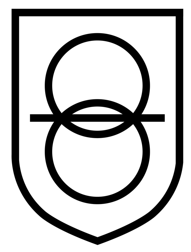

There should be a sign on the transformer/driver/power supply like this 1699351877072.pngwhich means it is safely isolated from the mains supply and does not require and earth, however I note the 20 volt supply for my lap top does not have it and the 20 volt supply is not earthed. It is rare for ELV to need an earth. Reduced low voltage is 55-0-55 single phase supplied and 64-0-64 three phase supplied the line to line voltage in both cases is 110 volt, 110 site supplies have no neutral so the cables should not have a blue core and the plugs and sockets should not be marked N it should be L1 and L2 but never seen a three core yellow cable without a blue core and never seen a plug without one pin marked N, we have to use common sense, and in the same way lack of the safely isolated sign does not mean it needs earthing.
