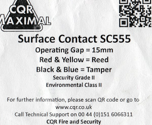

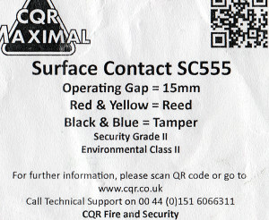

This is the little instruction leaflet inside one of the contacts I used. It's not the cheapest (grade 2), but not the most expensive:-
CQR in all their wisdom use red for the detection circuit. 4 core has red and you probably wouldn't use 4 core for any type of active sensor requiring power. This would suggest red & black are not for power. Perhaps there is a rule of thumb colour scheme. Hmm...
The SC555 does not require a power supply hence there is no Positive or Negative core assignment and Red and Blck can be used for any other purpose. In this case the manufacturer suggests red and black for the sensor but it could be any other pair of cores.
