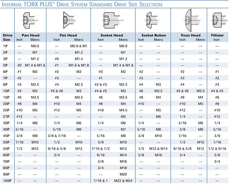

Do engineers rate these things to the diameter of the plug
Yes! No different to hex head, Allen, Phillips etc, there's set sizes to use depending on the head type and thread...
So, a T45 would be an M8 thread if it were a pan head, should never be found in a countersunk, M8 again for cap head, M10 for button head, etc.
What thread is the sump plug?!
