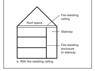

Hello,
I am thinking of enlarging my loft hatch to provide better access, the property is 13 years old, at present I have a metal loft hatch with some level of installation and I believe is fire rated.
Access to the loft is from the hall way, do I need to replace the loft hatch with a fire rated loft hatch or can it be non fire rated?
When I spoke to a company who makes these custom loft hatches she said, I only need a fire rated loft hatch if my ceiling is fire rated... not sure how to check this...?
Thanks.
If your house is a two storey, the celling below an unconverted loft is not classed as fire resisting, so the hatch does not need to be either.
If it's three storey, the hatch should be 30 minute rated as it's in the escape route.
This would make sense as to why Barratt installed a fire rated loft hatch.
Where can I can find this in a regulation document/website to show the installer?

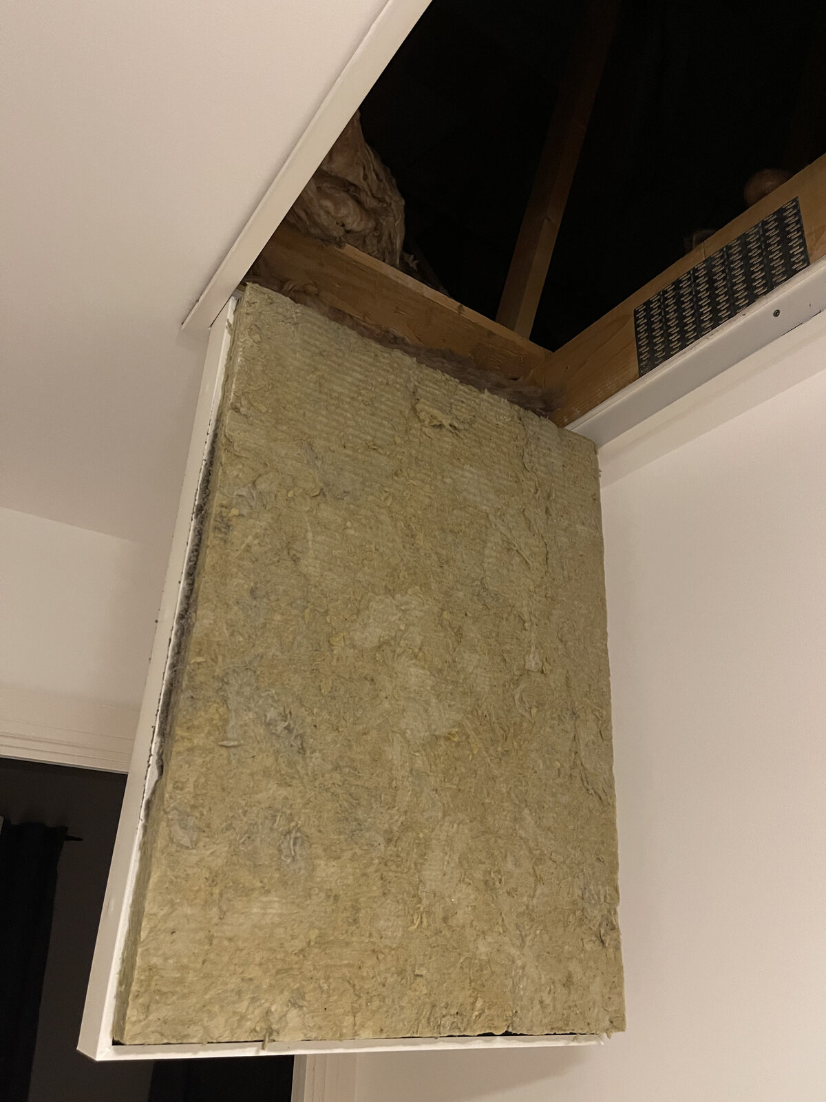

Think I was told incorrect information... my hatch doesn't look fire rated, can someone confirm?
Approved Document B1, and section 2 deals with means of escape where it describes the need for a protected staircase. You'll need to refer to the 2006 edition.
Any reason NHBC says different: Loft hatches and fire resistance
I have fire doors in all my rooms in the house, therefore I assume the loft entrance doesn't need protection. In addition, if there was a fire and we escaped into the loft, the ceiling itself its fire protected. I sent a picture on my previous post, I don't believe my hatch is fire protected is it?
That NHBC document is actually saying the same thing!
You have a protected staircase as the escape route from the upper stories, and the ceiling of the landing forms part of the protection of the escape route.
It's not about escaping into the loft but stopping a fire from the loft compromising your escape route.
Your steel and rockwool hatch may well be fire resistant.
Is there any way to check if it is fire resistant?
Would I also expect the plaster boards in the ceiling to be fire resistant as well?
