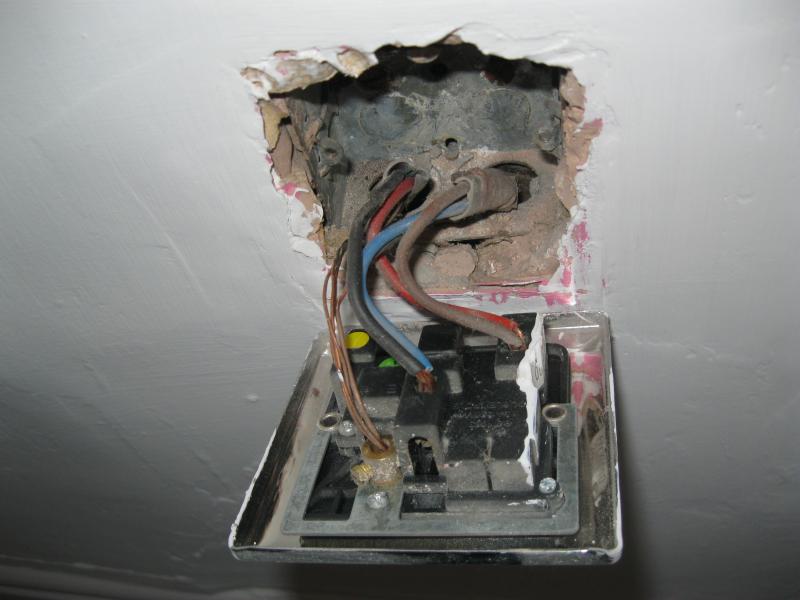

I am fitting a double socket in my small bedroom as it only has one single socket so double on other side is much needed
The single socket is part of the ring as it has 2 feeds connecting into the back of it, can I simply attach a 3rd cable to this which would feed my double socket wire will be going under the floor boards
also...I have removed plastic conduit from the corner and chased the wall and simply put the conduit against the brick, will this suffice or does it need to be of different material, conduit cover is also on and hope to simply skim over with plaster
Thanks for any help

are you sure that single is on the ring? because it has brown & blue cable i would say it probably isnt.

To tell if that existing socket is on the ring, turn the power off. Check it is dead. Disconnect socket. Test for continuity between live and live. Neutral and neutral. Earth and earth. If you have a circuit between each set of conductors this should prove it's a ring.
What size fuse or mcb protects this socket? 30/32 amp? Answer this first, may save a bit of time and effort.
A 20 mm rubber grommet should be used round the cable entries of the metal boxes.
Green and yellow sleeving should be placed over those bare earth wires.
Some capping or conduit would be nice over that new socket cable, though not essential.
Using that old trunking over your shower cable is ok, but capping may have allowed you better coverage with the plaster, because it's thinner.
Says 32 on the sticker, could I connect other end of the new cable to the back of the single socket or does it depend what type of circuit I have
Had been on a 16 or 20 amp circuit you wouldn't have needed to check if it's a ring.
You need to check if the socket is on a ring. Do you have a test meter?
The different colour wires may suggest a spur has been taken from a spur. It could also suggest an original cable has been repaired/replaced. Or the ring has been extended.
So you need to test if it's a ring before you do anything else.

Easier to borrow a meter though. In layman's terms, you need something that will buzz or light up when you touch the two test leads together. This is me trying to be un-technical.
Multimeters are about £5 from Maplin. Alternative is to take up all your floorboards, to follow the wire.
