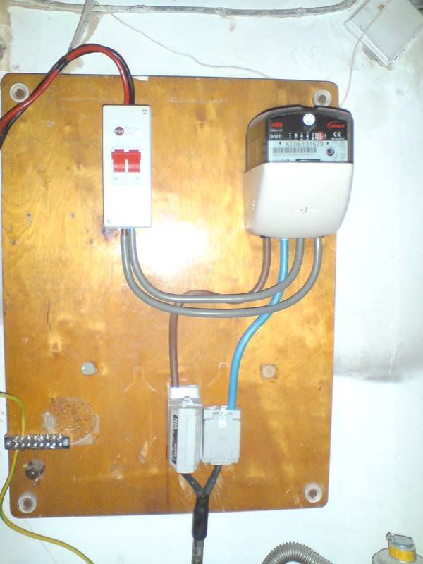

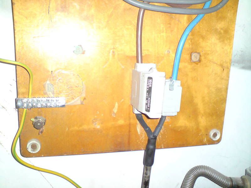

maybe you still have time to go out and buy one, plus an enclosure, plus a metre each of 25mm tails.
Get a metre of 16mm G&Y and an earth block too, or they may reconnect your old earh wire and seal the terminal so you can't change it later.
Thanks John,
what would you recommend for the isolator, do screwfix sell one? As I will have to go from work , before they arrive at 6.
Or Can I get all of the above from TLC?
