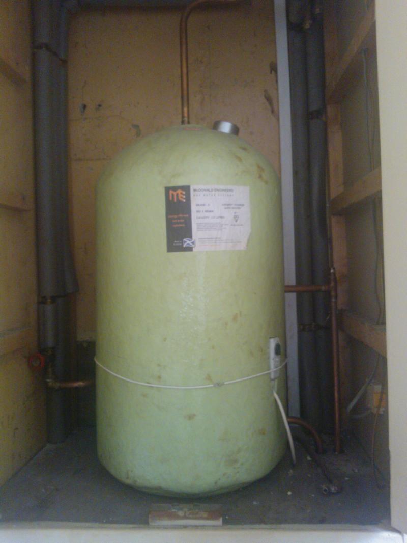

Just moving into a 2 bedroom house with central wet heating. The scheme has no gas:(icon_sad.gif. in the kitchen there is a big indirect cylinder (water tank)an a combi boiler at the other side. takes a lot of space up in the kitchen a its in a big cupboard. can anybody tell me if I can remove it? is it off use? do I need it? and if I do whats the estimate to move to loft if it is possible is it hard? thanks
Is it being heated? Before you do anything you need to work out why it is there. If you discover that it is required for some reason you won't be able to move it to the loft, it needs a cold water cistern to feed it from above and the easiest way to do this is from the floor above.
You say you have a combi boiler and gas?!
Are you sure it's a combi and not a system boiler, ie the heats the radiators and the hot water cylinder?
More pics would be good.
You don't have a combi so yes, you do need the tank. It could be moved into the loft provided you have enough headroom to raise the cisterns above it, but it wouldn't be easy or cheap, you would have to pay someone to do it. Also you have an electric boiler so expect high bills.
what does your combi work on if you dont have gas ? is it oil? are you sure it is a combi what is the make and model ?
Easy job to move it up to loft . A little bit of copper pipe- and even change it for a combination cylinder . Known as 'Fortic tank'. (that's if you dont have a combi). Not much pressure though if you run a shower off it.
Otherwise -similar sort of Combination cylinder-- and you can also run it off economy 7 electric. Really cheap to run.
