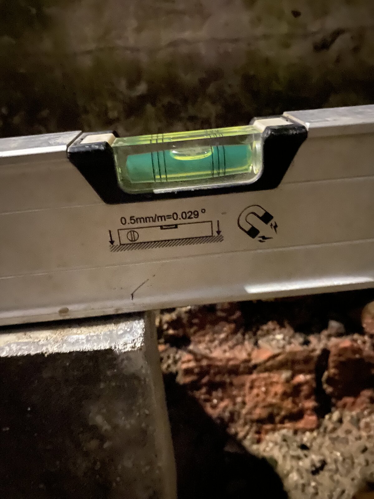

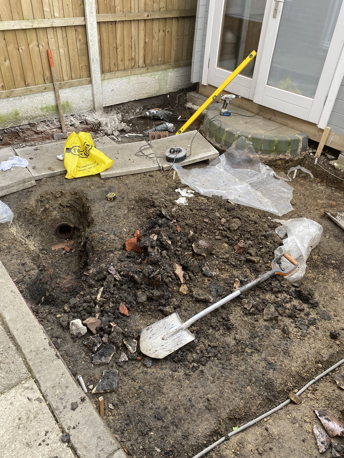

I laid my first concrete edging piece and I don’t think I have the the fall correct from the word go. I’m Laying an Indian stone patio
It’s a 2.7m x 4m patio but the fall is going to be on the 2.7m from front to back
I’ve installed my first flat top edge (there is a gap under spirit level as it’s not 100% flat)
I feel that maybe the fall should be bigger (the spirit level shown is 1.8m long and the first edge is 92xm long, so the spirit level would show the slope over the 1.8m length based on the angle of the current edge
Am I overthinking this? Should I rip it up and start again or will a 1cm fall over 2.7m length suffice?

1:80 is a benchmark recommendation. Some jobs have to rely on less because of contributing factors. Lesser fall means more precise slab laying is required. Unless your stone is super flat smooth, you will end up with individual little ponds due to the texture, in any case.

It’s a textured Indian stone I’m laying. There is an aco channel going next to the path edge thet runs behind my terraced house (so not directly next to house)
It’s probably not far off level based on the first edge… maybe I should take it out considering I’m at this stage…. Would you?

Not necessarily, no. I work out all my falls before I even put a shovel in the ground - i.e. I always have somewhere for the water to go. I will introduce the minimum amount of fall as I dare, in order to achieve what I need to do. 1:80 is fairly steep as far as I'm concerned, but I do take a lot of care when laying the slabs. Any hollows in a slightly falling patio, will end up as shallow puddles.
I’ve bought a 3m length of timber and cut it down to 2.7m (length of patio where fall is), and put a long spirit level in the middle.
I’ve used it to set up a string line and the total fall is just over 20mm across the 2.7m length.
I calculate this as a 1:120 fall. Any more than this I feel it will look too much of a gradient.
Ultimately I’m putting an ACO in so I really should have a gentle gradient of some sort otherwise it’s pointless having the ACO if it’s level
See pic below: fall will go from log cabin towards the path edge (where aco will be)
