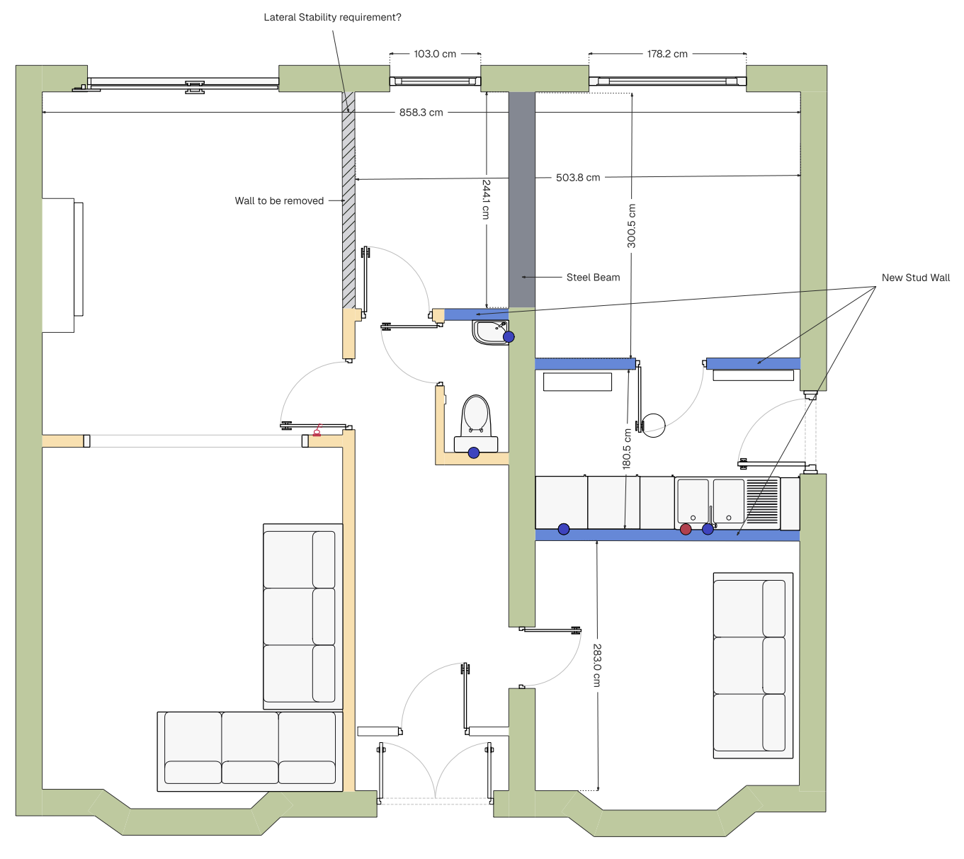

Hi All,
I know this seems to be a rather evergreen question on here - but I have a dilemma in relation to our house renovation (and the fascinating lives of Structural Engineers).
We are knocking through an internal wall, and have had a qualified SE to come and confirm that there was no beam required to support any load above. However, this SE also then stated that we would need to either leave 550m of a section abutting the exterior wall, or install a windpost, for lateral support. We later had a surveyor round (to measure for windows) who claimed to have considerable experience with structural calculations (but either retired or not an SE), who suggested that this was unnecessary and that the first SE was being over-cautious. We would much prefer to remove the whole of the wall (as architecturally it makes sense for the kitchen layout etc.), but we don't have funds for a whole wind post install.
So now we are looking for a second SE to assess, but I'm a bit concerned that a lot seem to be 'overcautious' with these calculations, and we are going to pay twice for the same ('incomplete'?) advice, and still end up with a mildly flawed finish. So I'd love to hear your opinions please? (I gather @tony1851 seems to be a resident expert here!)
There is a diagram of the ground floor attached to indicate the wall to be removed. All the green walls are cavity walls - the RHS is a 2-storey extension, the LHS is a party wall as we are semi-detached. I'm not sure what other details would be needed, but obviously happy to provide whatever I can!

The old wind-post hobby horse wheeled out again by some SEs.
The distance between the party wall and the original side wall of the house seems to be around 5m, which is not excessive for a horizontal span, and IMO no post would be needed, assuming the house is in a sheltered/suburban area and not on the top of Ben Nevis.
As it seems the first floor joists run onto the rear wall(?), they will also provide some lateral restraint to said wall.

Thank you all for your considered replies. I'll reply in reverse order;
Yes the first floor joists run onto the rear wall, the span is ~5m and we live in a suburban sheltered area.

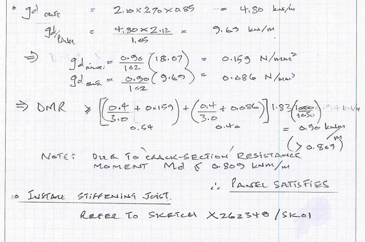

Sorry I know this thread is done now, but in case anyone else searches it in the future I thought I would add the results thus far.
We had a second structural engineer to do the calculations, which looks like the below (all a bit over my head tbh, apart from the glorious "PANEL SATISFIES" conclusion). Though he does suggest adding another floor joist in the ceiling as a recommendation - I don't know how helpful that will be?)
So in the end we paid for two structural engineers at a cost of £600-700 to tell us we could remove an internal 3m wall without a windpost or additional support.
