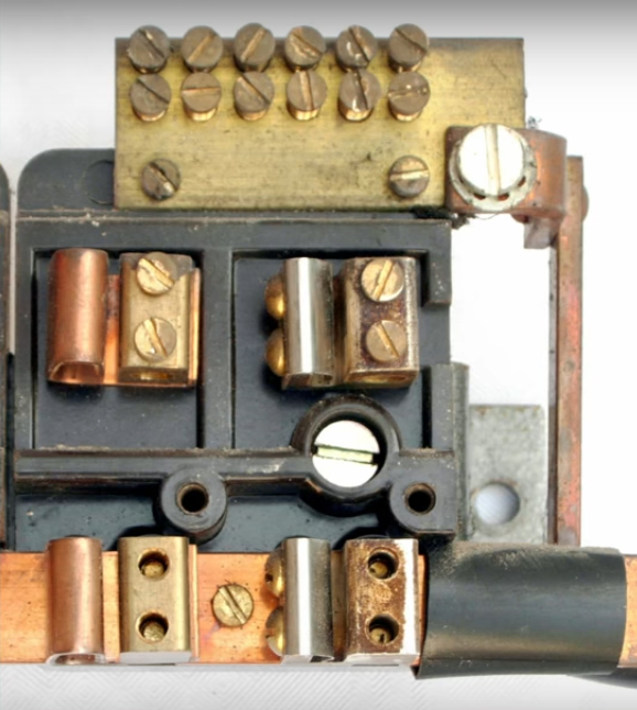

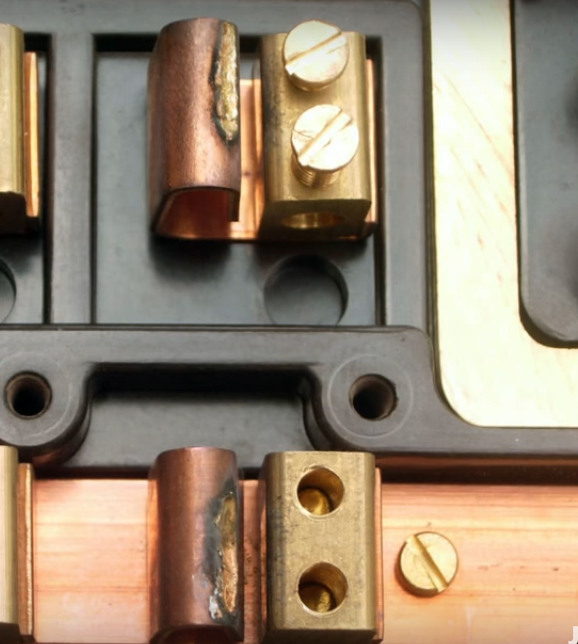

I have seen many a steel enclosure which has degraded over time and it falling to bits, not seen the same with plastic enclosures, the old Wilex fuse-box-1.jpg has been around for a long time and I don't know of any problems, OK burnt contacts Wylex burnt contacts.jpg where the heavy duty version Wylex heavy duty.jpg has not been used, but it was the use of plastic which was the problem, it was the build quality and the fact type approval was given to sub standard designs. The type approval should have ensured better build quality. The cure would have been to remove the type approval for units which had fire problems, we have not banned washer/driers because one make was going on fire.
Aren't people forgetting that the regulation does not state "Thou shalt have a metal CU"?
I don't think people are forgetting it - but, rather, are stuck with metal ones because non-metal ones which would qualify as 'non-combustible' either do not exist or else are not identified as being adequately 'non-combustible' to satisfy the regulation.
