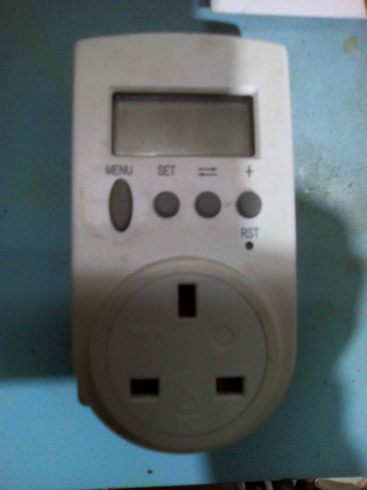

There are plug-through (doubt whether that's the right word) RCDs available, an example (link):
https://www.ryness.co.uk/13-amp-30ma-plug-in-rcd-adaptor-white
In my minds eye I can see a Residual Current Meter looking something like (apologies for shadowy photo):
but I can't find anything, am I throwing wrong keywords at Mr. Google?
What I can find are clamp meters, example (link):
https://cpc.farnell.com/multicomp-pro/mp780050/mini-leakage-current-tester/dp/IN08364?st=ac leakage
It's my belief that to use such a clamp meter I'd have to knock up a shortish extension lead in which the earth wire is in a separate cable to the one which contains the live/line and neutral wires, is this right?
Background: A friend has a 100mA Current Operated Earth Leakage Circuit Breaker (does the name give away its age?) which started tripping and which cuts all the electric to her house. It seems likely that its caused by the boiler but I kept on impressing on her (what I believe I've gleaned from other threads) that the boiler might be just the final straw and that other device(s) might also be faulty. The boiler is plugged into a normal 13A socket (which has been used successfully to boil a kettle) and so it seemed it would be easy to plug in a Residual Current Meter and see what it showed.
I too have looked for such a device & never found it.
In the past I have resorted to building my own. A few years back I found a variable RCD module in RS that happened to have a real time readout of the earth leakage current on a three digit LCD display. I boxed this up & put 32A ceeform in & out leads on it. This became a mainstay of our diagnostics kit used on festivals for many years - along with inline current meters for 16A & 32A ceeforms.
I think the closest you'll get is a clamp meter similar to the one you've linked to together a modified short extension lead that separates the earth core from the other two.

To measure the earth leakage, you either need to measure the flow of current (mA) in the earth wire, or measure the difference in current flow between the live and the neutral again in mA. An ordinary ac multi-meter, able to measure mA, could quite easily be used for the first method, whilst taking suitable safety precautions.
Be aware when measuring leakage, that the measurement is an instantaneous one - there might well be a much larger leakage which only appears under certain circumstances for an just instant.
Lots of modern equipment includes mains filters, using the earth pole as a reference. The more of these there are on an RCD protected circuit, the greater the leakage, the higher the likelihood of nuisance trips of the RCD. So the filter on the boiler, might well be the last straw in leakage, rather than the main cause of the nuisance trip. This is where multiple RCD circuits have value, in reducing the total leakage seen by one RCD (or ELCB).
That's not conclusive as there may be other paths to earth.
It's called a Residual Current Device because it is the Residual Current of the Line and Neutral; not the currant in the earth wire - obviously it can and might be the same but that is not what you are looking for as far as the RCD is concerned; it knows nothing about the CPC.
There are possible other paths to earth, but we are usually looking at an appliance's leakage to earth. Items like boilers will also quite likely have pipework forming a path to earth. So the only way to be sure, is a difference measurement between L & N.
Then we have agreement :)
You do, but you are agreeing about something rather different from what you originally stated :-)
In fact, (in terms of what you originally wrote) with anything to do with plumbing/heating, measuring the current in just a CPC is definitely not appropriate, since any leakage current will, in that situation, almost inevitably be shared between the CPC and other paths to earth (even other paths back to the MET).
