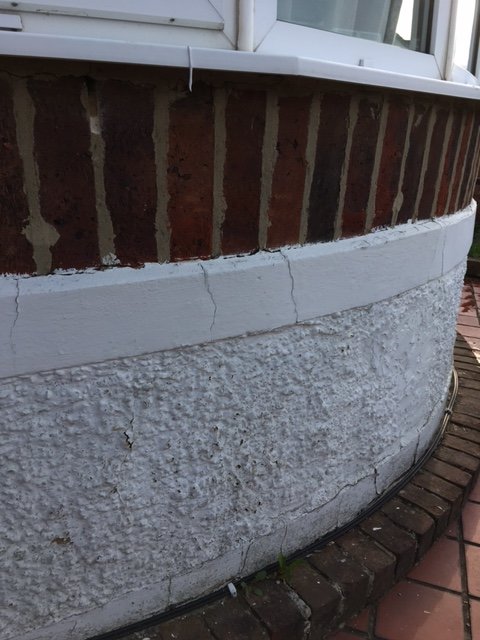

Hello all,
Virgin post here, so bear with me. I am in a 1930's place that is like a throw back to the 1970s, slowly being fixed up as we speak.
Looking at the bay, two issues:
1. Bricks leaning out, see pic
2. Render Cracking off
How do I fix the bricks?
Ref the render, I want to restore that band at top and bottom, then tyrolean in between as it is now. How to create the band?
your photo dont show the full height of the bay an you cut off the corner so its difficult to see if or how far the soldier bricks are leaning?
the Tyrolean an the render bands are failing .
render should be cut back from surface contact at the base by about 50mm - your bottom render band seems to go down behnd the brick semi-circle.
hack all the render/tyrolean back to ... what, dont know what the background is, brick, stud framing etc.
the soldier bricks would have to be taken out an reset in sections but it might prove a difficult bit of work?
originaly you had a timber bay window an how its been replaced with the Pvc frame might have caused the soldier bricks to lean.
definitly a job that needs experienced eyes on site.
