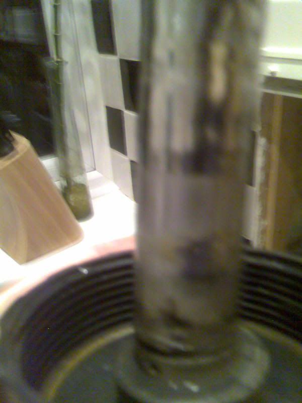

I was called to a leaking boiler a good distance from home as it was an emergency and the installer who fitted it couldn't get back to it for a few days during a recent cold spell.
When I looked underneath it turned out to be the magnaclean that was leaking. It was as if the head had popped off its threads.
When I looked at the base of the magnet the protective stainless case had ripped open causing the core to expand and push the magnet at an angle with enough force to rip the head off its threads.
As the job was far from home I snapped the magnet off so I could get the thing back together and advised the householder to take it up with the installer and/or magnaclean. Goods not fit for their purpose n all that.

I wonder if the homeowner might have dropped it?
Homeowner didnt know what it was or that it even existed until I told them.
I twigged what was going on when I couldnt re-assemble it and saw that it was out of skew when the cap wouldn't go back on.
A smart tap with a hammer broke the shaft at the line of the fault
