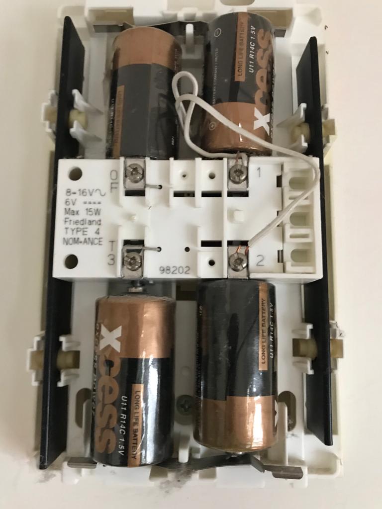

Does adding a spur from the MCB require Part P?

You don’t need a fused spur switch if it is on the lighting circuit. Part P is a building reg, nothing more.

perhaps I wasn’t clear but yes, I was expecting the chime box to have an AC/AC bell transformer in it, as it looks identical to every other chime box I’ve seen which did. Instead it had 4 C-cells in it, wired to the door bell button and the chime solenoid. Not something I’ve seen before but probably more common that I thought.
The plan is to drop a doorbell transformer in there instead as all the bell wiring can be reused, it’s just a question of how to get the mains supply to it.
Sounds like taking a spur from the MCB is fine because it’s not a new circuit. Obviously will be careful to ensure the whole CU is isolated before doing anything.
cheers!
