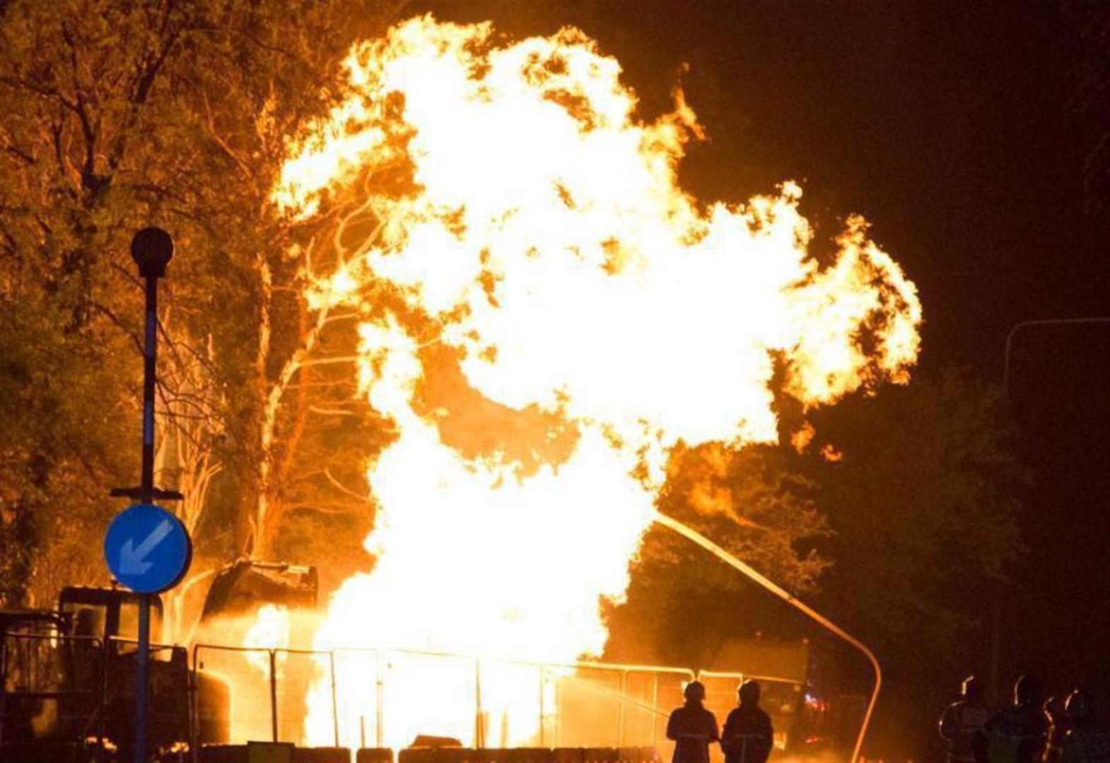

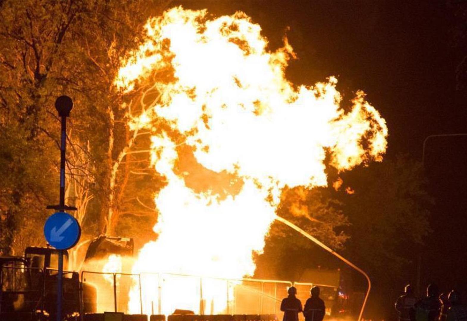

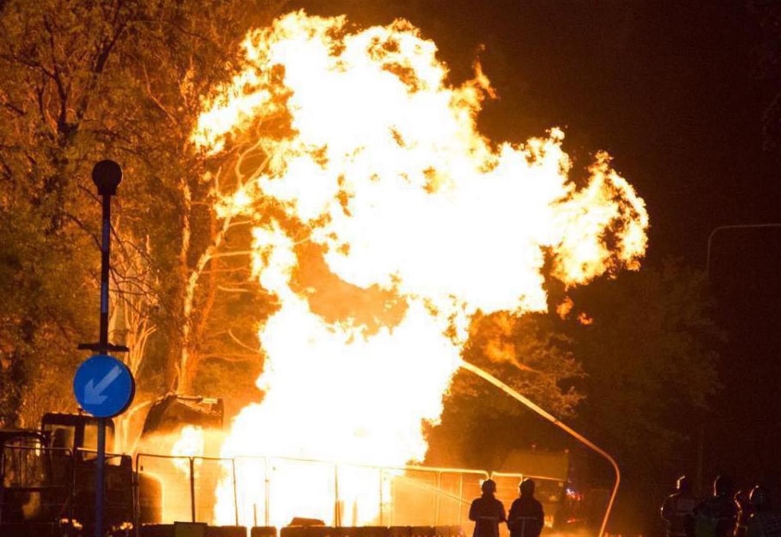

Gas is normally more dangerous escaping into confined space, a low pressure escape into atmosphere wont explode, (might get a bit of a flare if it ignites, but provided there's no-one too close, it can be dealt with.) High Pressure gas is a different matter, HP main split in the road outside our depot last year, even though we were about 3/4 of a mile away in the building, we were not allowed out the main gate. Had to leave our cars in the car park and exit via a back gate, with a mile walk across fields to get back to civilisation whereby a taxi was ordered to take us home! Southern Gas had one go a while back, unfortunately their engineers were working on a leak at the time and were badly hurt.
