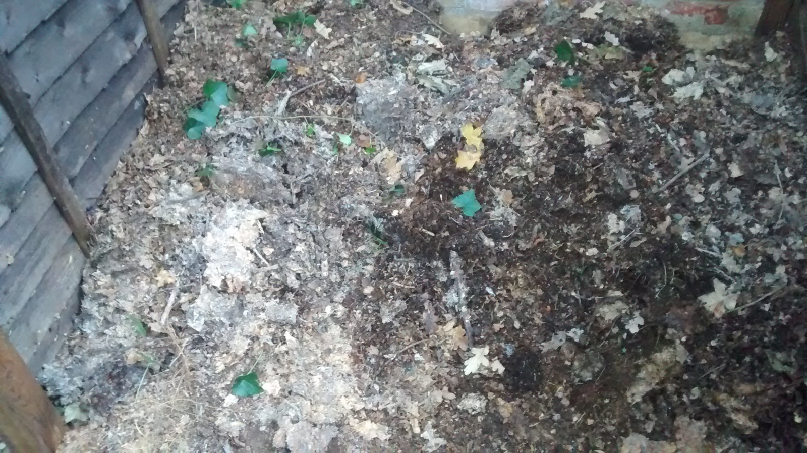

We have a large garden with plenty of mature trees, hence lots of leaves in the autumn. So I have built three leaf mould bins, roughly 2, 1.6 and 1 cubic metres in size. The idea being that the leaves spend a year in each bin, gradually breaking down and taking up less room.

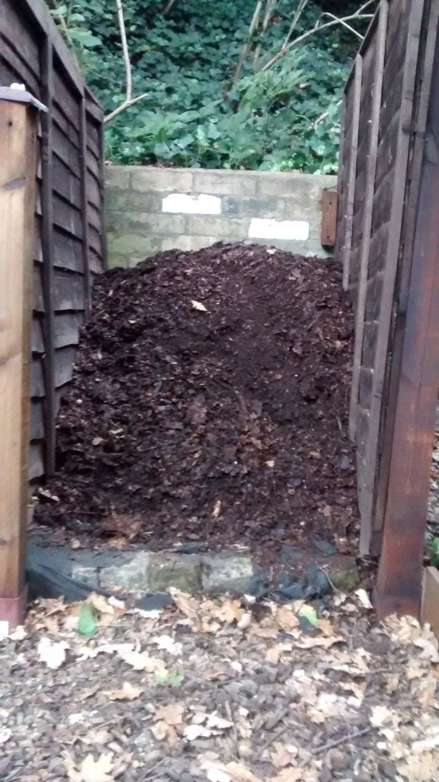

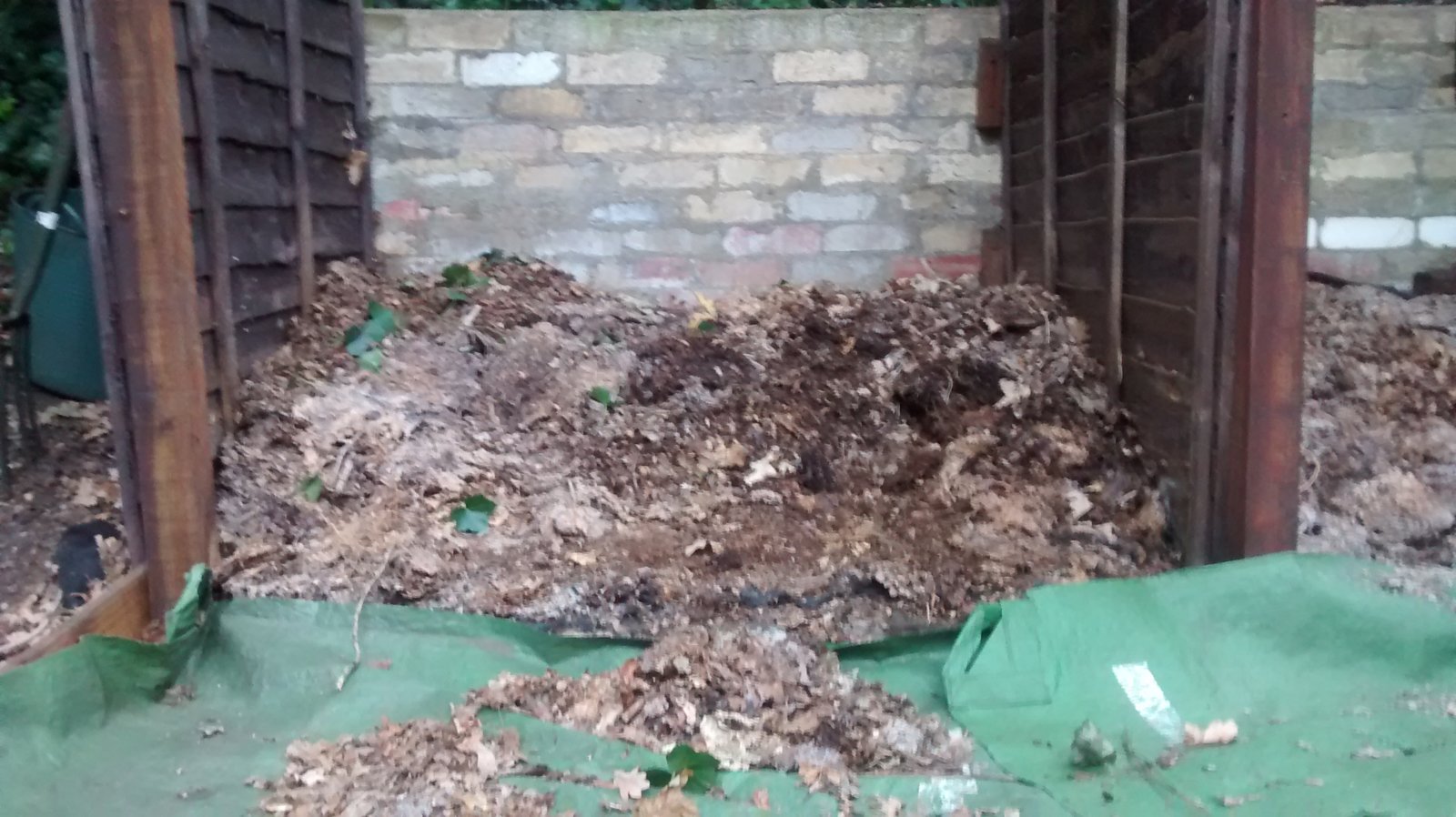

Before I started today there was 2yo stuff in the middle (medium) bin and 1yo stuff in the LH (largest) bin.
I have transferred the 2yo material into the smallest bin and you can see it in the RH picture above. It looks like I would expect and is damp to the touch but if you squeeze a handful together it falls apart.
The top layer dries out & goes a lot paler, so I was not surprised that the top of the stuff in the LH (largest) bin was dry and pale.

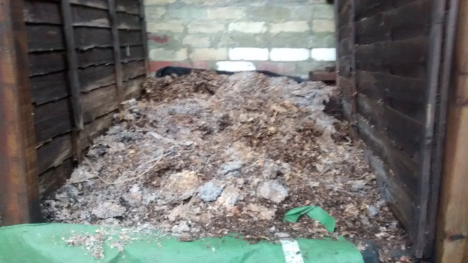

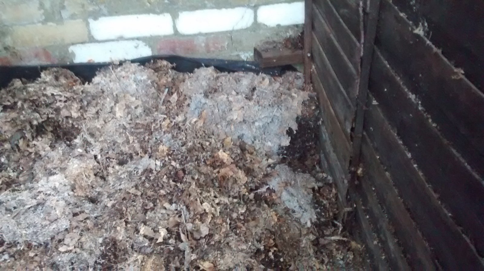

However once I had started moving it to the middle (medium) bin, I saw that a lot of it was dry, it was in layers like leaves that have just been compressed together (rather than broken down) and in places it has something that looks like mould on it.
There have been mushrooms (or some sort of fungi) growing on both LH & middle bins.
Anyone any ideas what has happened here, is it a problem and if so what do I need to do about it?

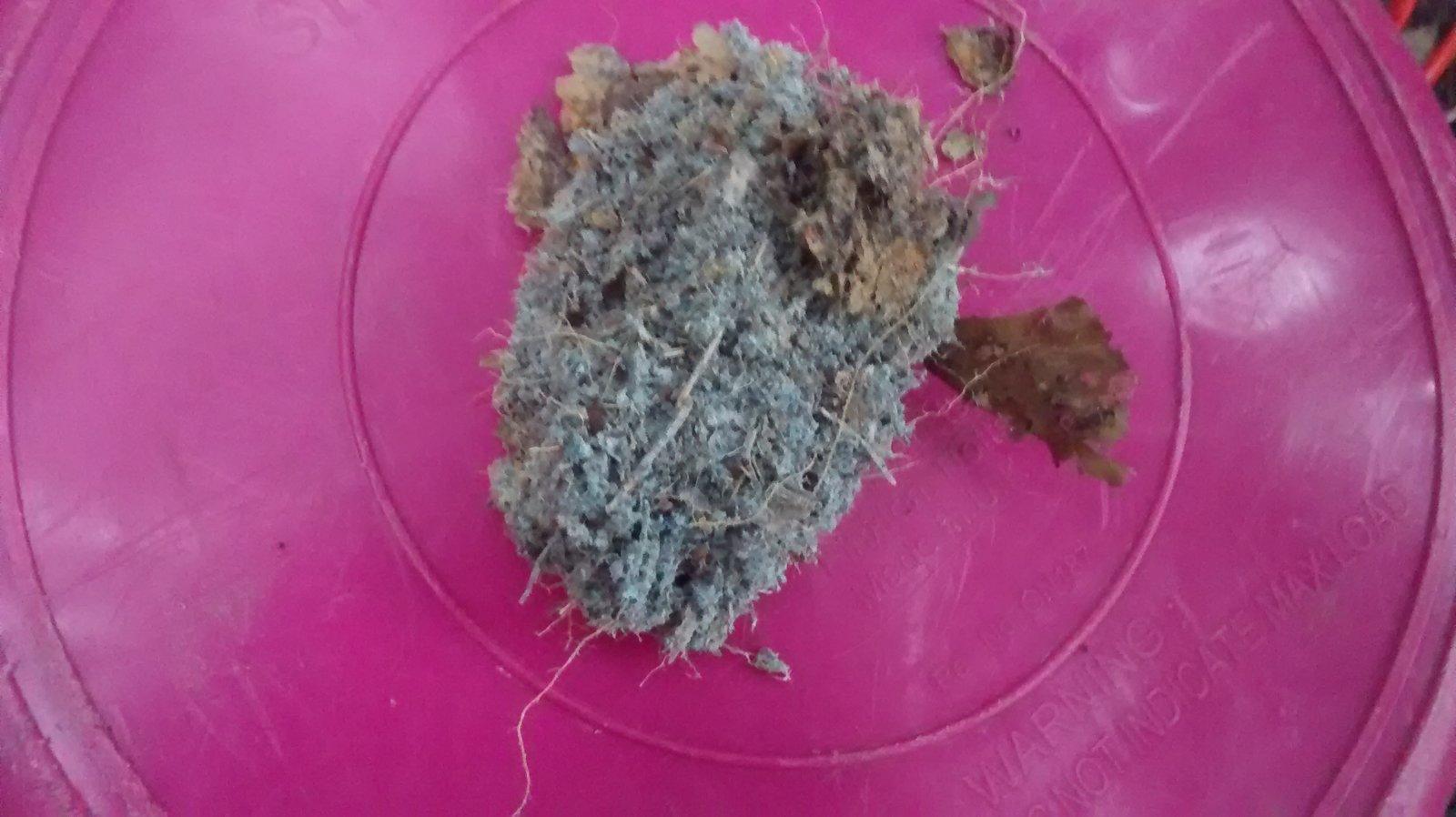

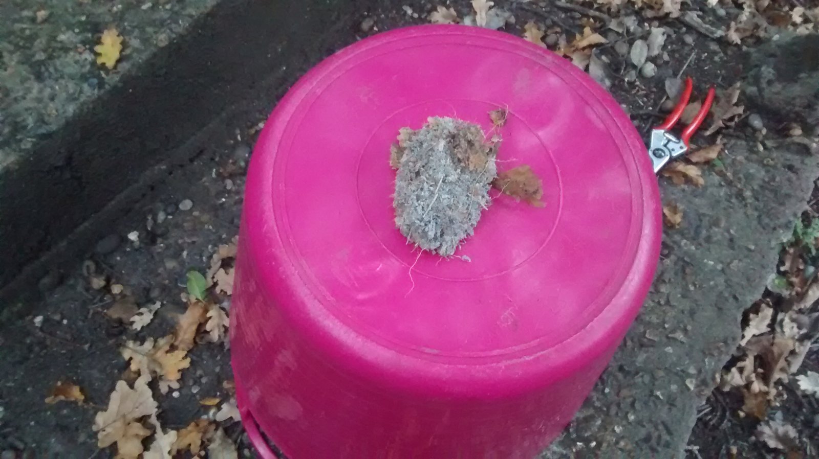

But what is the stuff that looks like mould? That did not appear in the older lot and I never turned that.
might have been fungus
"leaf mould" is slow to decay and does not heat up. The trees drain all available nutrients from them when day length shortens, hence they go brown, dry and withered. An autumn leaf that falls is not the same as a summer leaf that you cut off and dry. They improve the soil texture but do not add significant nutrients.
I think your dry layer might have dried out before you stacked it, and it looks like it did not get wet enough later. Perhaps the different degree of moisture encouraged different microorganisms.
If mixed with grass cuttings, they will decompose quicker and you can compost them.
I use leaves for a winter mulch. By spring the worms have dragged them into the ground for me, saving me the effort of digging, and they house beetles, which eat slugs.
The fungus and bacteria that live on dead material do not eat living plants.

Maybe. As I said there have been some sort of fungi appearing on the surface, and the visible part of mushrooms (etc) are only a small part of the organism. However I don't know what the underground part of a fungus looks like.
I bought a new blower/vacuum last year that works best with dry leaves, so what went into this batch may well have been drier than the previous one.

Keep the leaves moist especially in the summer. The fungi helps breaking down the leaves; it will not harm living plants as somebody already mentioned.
