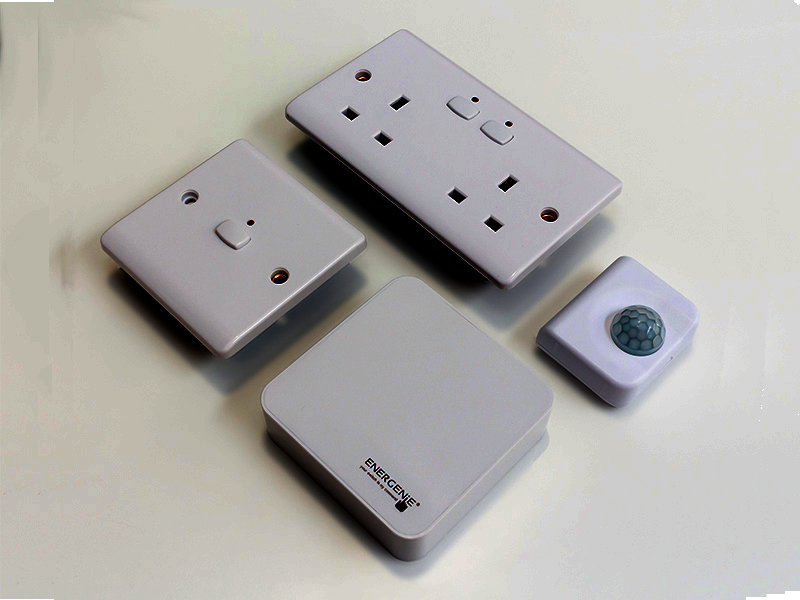

Home Taster Pack.jpg It seems sold as a taster pack MIHO106 by Energenie, I would guess other makes do the same, it allows PIR, time, remote controls, and internet to be integrated together, not a great fan of Energenie MiHome as expensive and you need to use IFTTT for some functions, but it does show you can do it.
