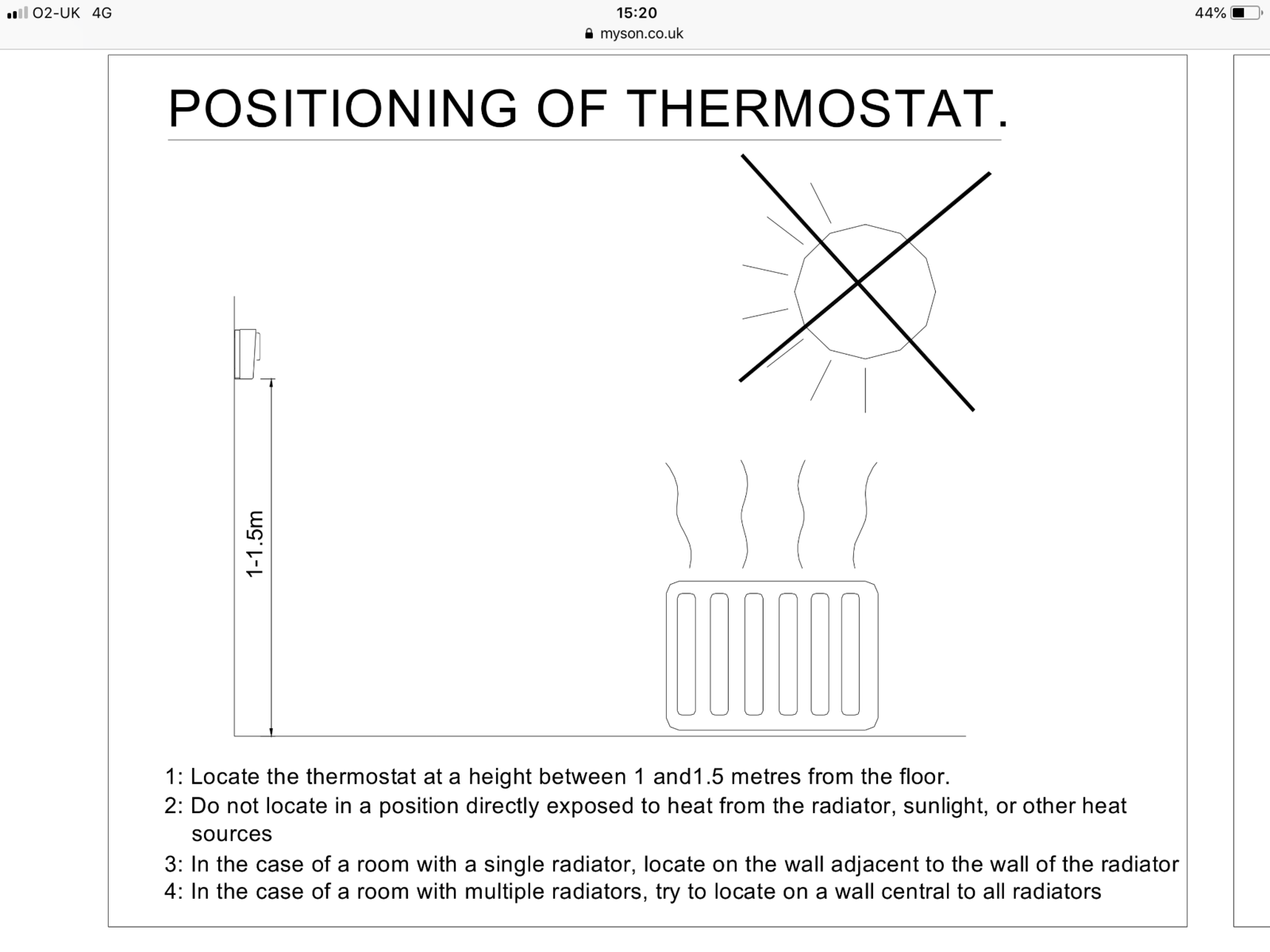

Whenever I’ve looked at manufacturers instructions for sitting of a room thermostat and @stem ’s written instruction for siting of a room stat, my current setup seems illogical, yet when I look in the mi’s it states it’s ok? Very confusing information.
Room stat: Myson MRT1
Location: open plan living room, which incorporates dining room/kitchen.
Number of rads in this location: x3 with TRV’s
Will I get big swings or will it be ok? Whenever I’m upstairs or in the downstairs toilet it seems very cold, although bathroom is possibly a good heated room.

No you cant have a room thermostat above a radiator and it should be installed in a space with a radiator with no TRV on, and before all you google warriors jump in about my next statement just read that this is MY opinion and nothing to do with any Part L, Boiler plus or any of the other shoite that we have to adhere to, I totally disagree with the need for a room thermostat, it is a boiler interlock yes and adheres to some code, if a house has TRVs the room thermostat will over ride these, modern mobile thermostats can be moved around with you wherever you are sitting, Adheres to code because it is a boiler interlock, what it actually is a remote control for your heating with a temp display on so make s a complete mockery of the supposed codes, but in effect is far more suitable for the user, I have a Hive in my house and TRVs on every rad, I dont use the thermostat part of the hive and just use it as an on/off switch with my phone, I dont need to ask the local airport if it is cold outside, I know when it is cold, I have the TRVs set to what I want them to be at, and guess what , it all works no problem, I just hide when the room thermostat Police come around

If that represents all of the radiators in the same area, that's basic installation error. There should be at least one radiator without a TRV in the area where the room thermostat is located. Otherwise the TRV's will interfere with the correct operation of the room stat.
Consider a scenario: The TRV's are set to 20 degrees, room stat set to 22 degrees, the TRV's will stop the room temperature getting above 20 degrees and the room stat will never switch off, so it might as well not be there and the heating will run on indefinitely even though not really required and wasting energy because the temperature set on the room thermostat will never be reached.
The bottom line is that the room thermostat turns off all of the radiators when the set temperature in the area where it is located is reached. So, it should be one of the last places to get warm, then the other rooms are warmed first before the room thermostat turns off all of the radiators.

1. If you have TRVs on radiators in the room with the room thermostat, turn all the TRVs to maximum, and then the room thermostat controls the temperature of the room.
2. I don't see any contradiction in the Myson instructions. It suggests "on a wall ADJACENT to the wall with the radiator", and specifically states not exposed to radiator (or other) heat sources.

I didn't install it, it was done as per new build. As for the "hallway" it's not big so maybe that's why it's in the lounge? Also I can only see x2 wires must just be a switch

That would work, until someone fiddles with it or turns it off during the summer. I've been called out a few times to look at a 'broken room stat' and someone (or the kids / dog etc.) has moved a TRV from the max setting :rolleyes:
I didn't say you did ;). But someone did. If it's still a new build, get the builder back to rectify his schoolboy error.
