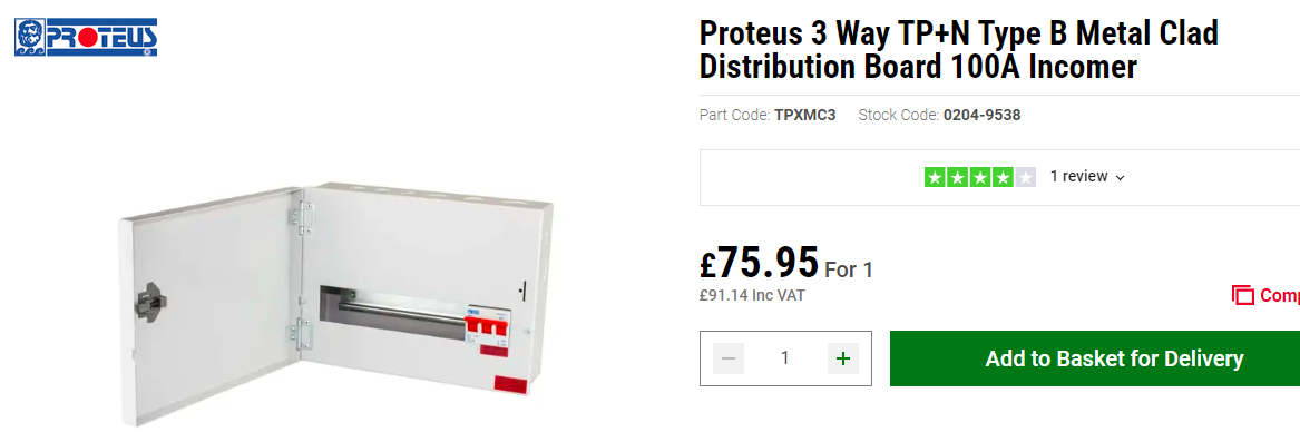

Yeah, as you say three phase busbar sets for regular CUs don't seem to be a thing in the UK. Three phase distribution boards in the UK designed for circuits of 63A or less* always seem to use a large central "PAN assemly" with the main switch mounted below and the MCBs mounted horizontally down the sides. .... I wonder if there is a regulatory reason for this, or if it's just a case of "we sell what we have always sold".
The 'why' (in the UK) question is an interesting one - and your suggested answer may well be correct.
However, I doubt that the reason is 'regulatory', since single-phase-like ones are offered for sale in UK For example ...
