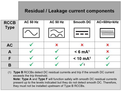

What type of RCD have you got?
That's not the type, it's the differential current trip rating. Post a photo of the front face of the RCD and we should be able to tell from the markings.

The RCD issue is a new one for me. It is a type A. It works okay with my 7kW car charger and all the other gismos in the house, but I hadn't realised there were different types for different applications. The (preferred) Mitsubishi A/C unit manual does not appear to specify the required type of RCD. I will act the dumb customer and let the A/C company install the thing - it's their job, they are accredited and have been installing them for 20 years so hopefully they know what they're doing. If they have to install a separate circuit with its own RCD, then so be it, but it's going to look pretty ugly, as they cannot get a new cable from the mains position without surface wiring on the outside of the house for part of the way.
Given that compact type A double pole bidirectional RCBOs are now readily available for the major CU brands at close to the same price as other types, I can see no reason to install anything else unless there is a specific requirement for a different type.
