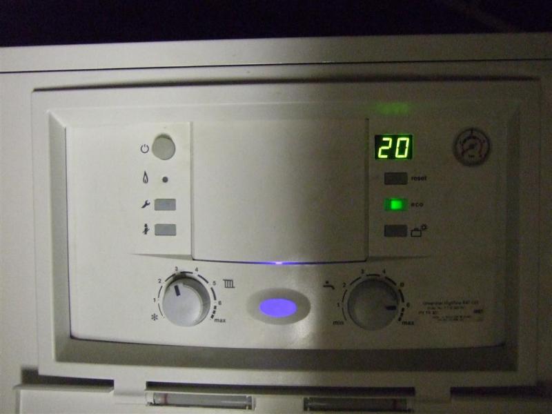

Hi, I had a Worcester 440Cdi fitted end January. I noticed yesterday that the pressure has dropped down to nearly zero on the pressure guage on the front. In the manual it says it should be reading 2.
I looked at the pipework so I could add some more water to the system but I am a bit confused:
The pipe on the left is cold and there does not seem to be a valve to turn to let water in (the yellow lever does not seem to do anything)
The middle pipe is the only other pipe with some kind of connection on but that pipe is luke warm like the others. The valve is also really stiff and I can't turn it without considerable force.
Before I do anything, can I please ask some advice that I am actually looking at the right thing? Should I be turning the middle valve to let water in?
Dont turn them that you can see there.
Take off front panel to boiler, can you see a pipe that connects to the valve extreme left, then connects to valve second in from right, should have a pressure guage on it.
If so then this is the optional filling loop.
Mmm. Ok, next problem. Front panel does not seem to come off! There is a screw on the left and the right at the bottom attaching the front panel to the side inside the panel which I can't work out how to access....
Also the boiler seems to be powered on although the heating and hot water are not in use. Is this normal?

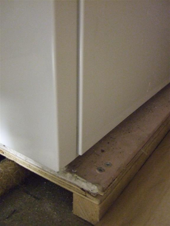

Interesting picture.
To meet CORGI regs this boiler must have 600mm of level floor in front of it to allow it to be rolled forward (on integral rollers) for routine maintenance.
This one seems to be perched on a pallet?
I suspect the casing is warped due to insufficient support, making the cover misaligned and difficult to remove.
Hi,
It is all installed according to spec. I have a building control certificate and Worcester have also been out and inspected the installation. There is about 2m of level floor in front of the boiler. The case has not warped at all. It is only three months old! It is in the loft which I had upgraded in December (full loft conversion) with steel supports, insulation and proper flooring fitted.
I have to say that when I look at your pictures again, I am confused because these indicate the opposite.
The boiler appears to be raised on a wooden plinth, if you have pictured the front door. :?:
