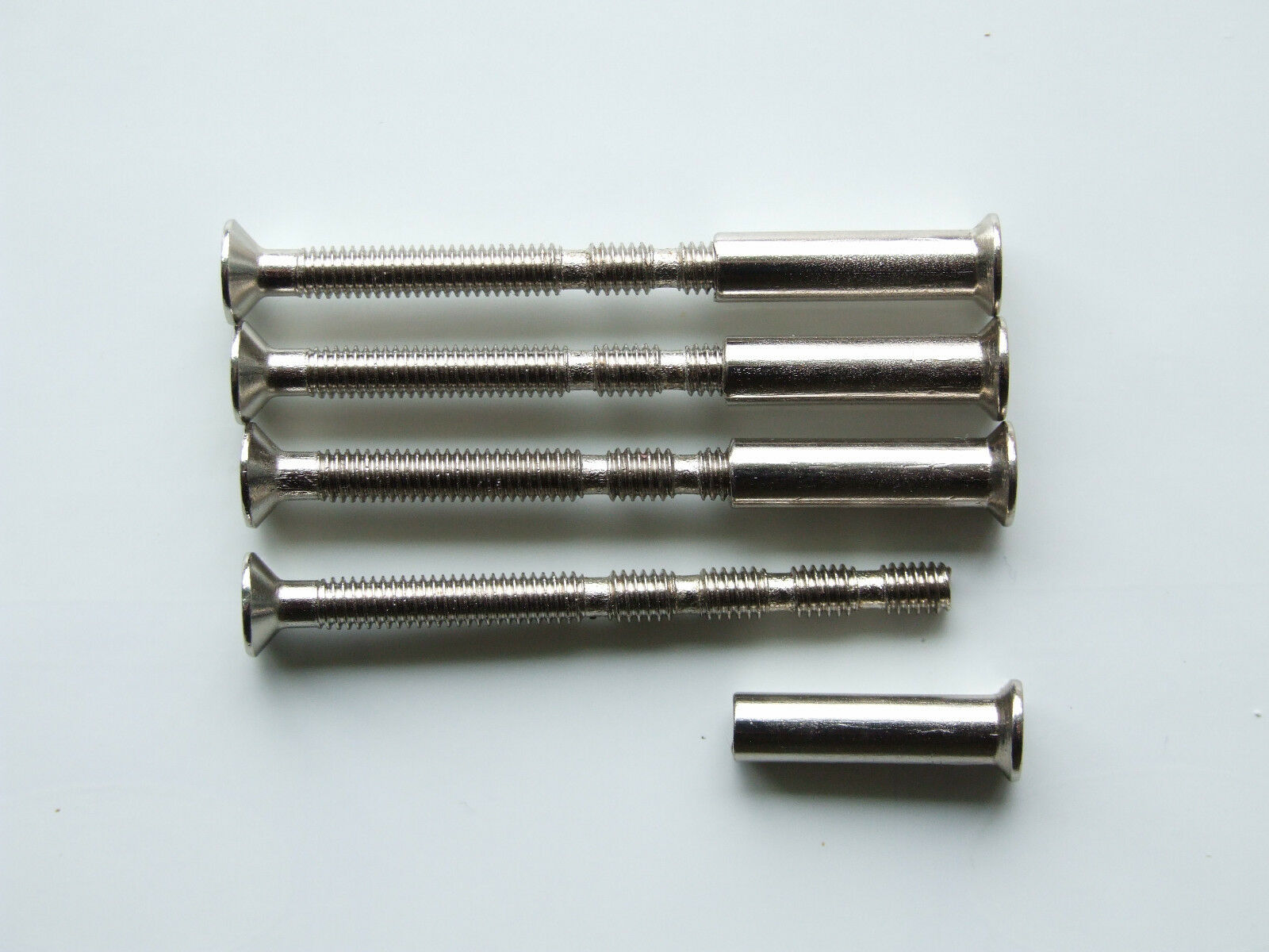

Hi all,
Got a door handle that keeps coming off. Essentially it is the screws that pull out, probably due to the cheap hollow panel door not providing a decent enough hold for the screw threads.
Any suggestions? I was thinking if just trying screws with a bigger thread.
Cheers.
This particular door is our understairs storage cupboard door, which only has a handle on the outside.
I guess those fixings are more designed for holding 2 handle fixings together, but maybe would still work if I use washers. Just will look a bit odd
Sleeve nuts don't work with that type of handle and back plate. I'd suggest removing the latch, chopping out a bigger recess and installing a snug fitting softwood block. This needs to be big enough to "pick up" the door handle screws and should be glued in place. The door should then be fitted with a roller ball catch, adjusted to reduce the spring pressure and if at all possible the handle locked so it cannot rotate, before reinstalling with longer screws.

Because sleeve nuts are designed to be used with either 2-piece escutcheons (under piece generally stamped steel with two or more hexagonal holes for the sleeve nuts and a friction fit polished top cover) or handle sets where the handle base (often stamped steel) is pierced with 2 or 4 hexagonal holes for the sleeve nuts and come with polished cover pieces ready mounted. The OP's handles isn't that type. Also any lock, or more likely in this case, sprung latch needs the body to come ready drilled to accept the sleeve nuts and many older or lower cost fitti gs do not have the drillings

You can buy replacement handle pairs, which bolt through the door, clamping the door between them like a sandwich, rather than screwing to the door.
Some sleeve nuts are hex and smooth on the ends but the ones John links too are countersunk Philips head both ends and can be used on most door handles.
An update; ordered the sleeve screws/nuts from JohnD's link above.
Luckily I found the other counterpart handle in shed, so decided just to stick that on other side of door, to act like a big washer in effect.
Took a little longer than anticipated. Had to make the holes on one of the handles bigger to accommodate the sleeve nuts, plus hacksaw the screws one section shorter.
Also had a bit of trouble screwing into the sleeves, as the alignment of holes wasn't 100%.
But all done now, cheers guys (can you still say that these days?)
