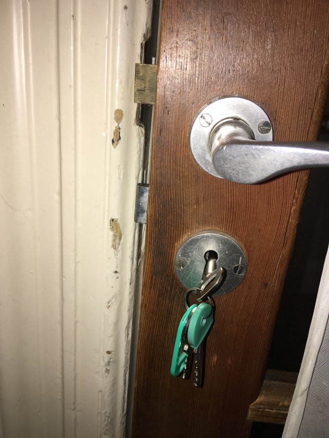

Is an 85mm door lock style wide enough for modern 5-lever mortice locks or lockable handle rim latches?
Ian
I also forgot to ask ... there is an 8mm gap between door style and frame, so the existing mortice deadbolt only just catches the strikeplate (sometimes it doesnt though!).
Whats the best way to fix this? Pad out the hinges? Pad out the strike plate? New door?
I might just get a new door anyway. The current door is glass panels, so not the most secure. It opens into a common stair shared with one other neighbour. The maindoor to the building only has a yale type lock on it.
Ian
I would be inclined to put a woodstrip in the frame, then re-fit the strike plate. Use good big screws so they are firm in the frame itself.
The current BS3621 has a longer bolt throw, but you should always minimise the gap.
