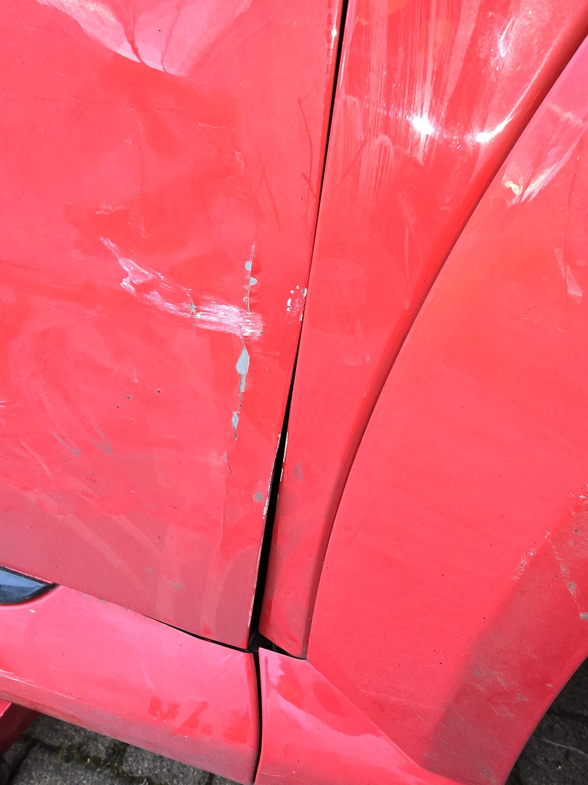

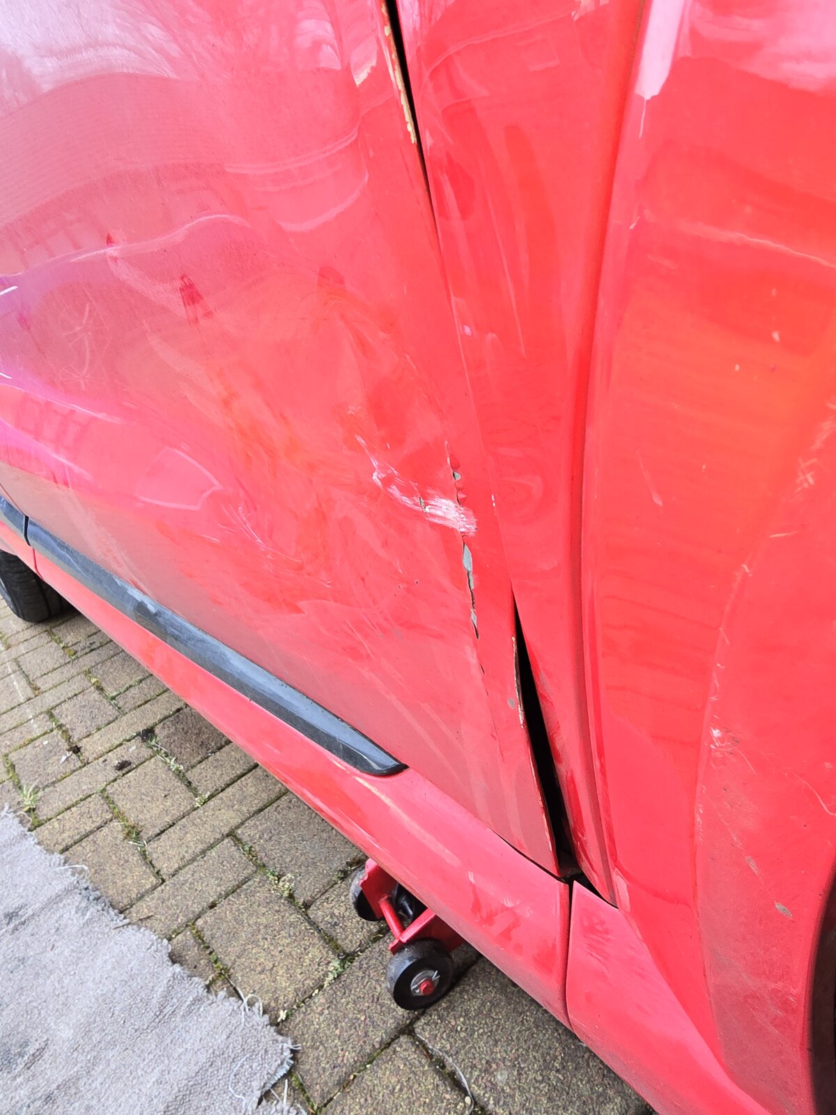

hi , I bought a cat n car , car was hit on wheel , but part of the damage is hit the door as seen in pictures.
the door clips wing as wing has been pushed forward.
before I spend money on a new door , can this one be repaired .

Very difficult to tell from here, but more important is the A pillar that holds the wing - that needs to be sorted first.
If the car took a biff on the wheel, there may be wishbone damage too.
I'd remove the wing first, and lets see from there.
John :)

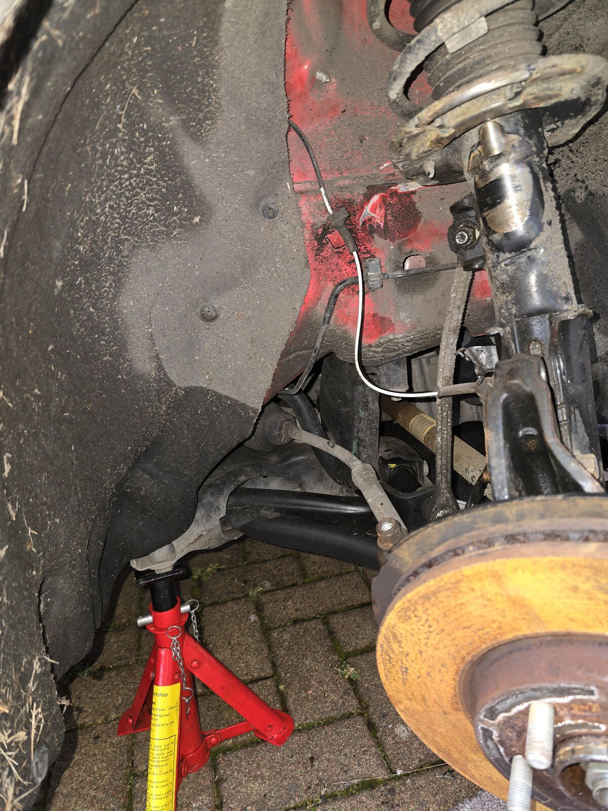

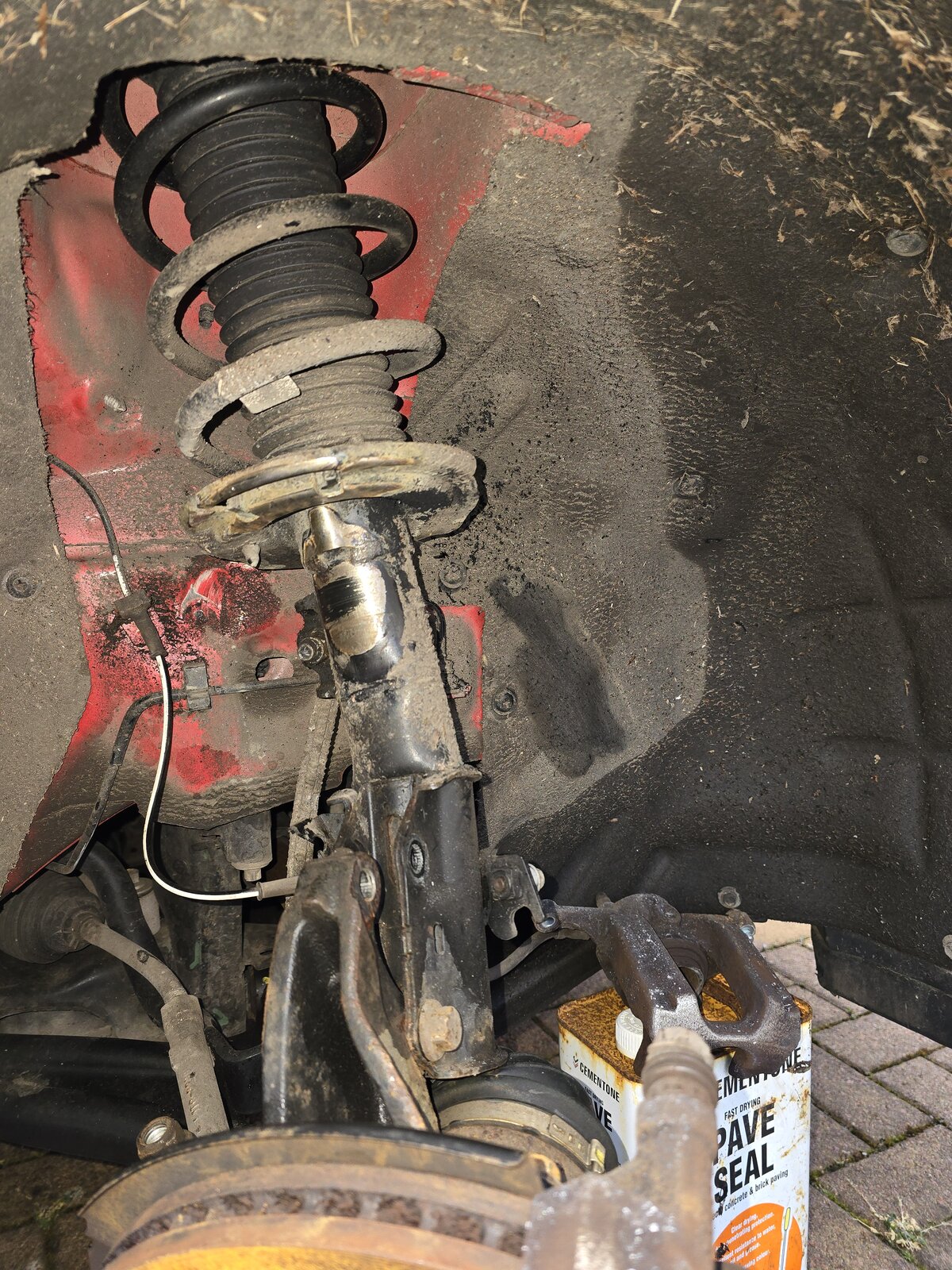

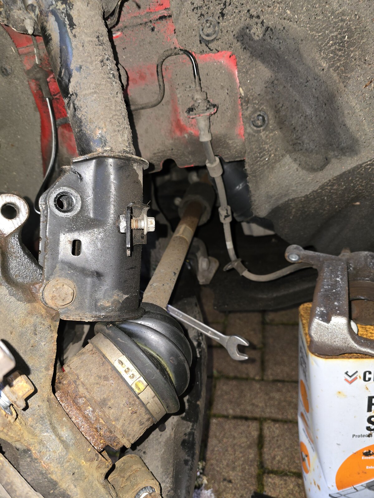

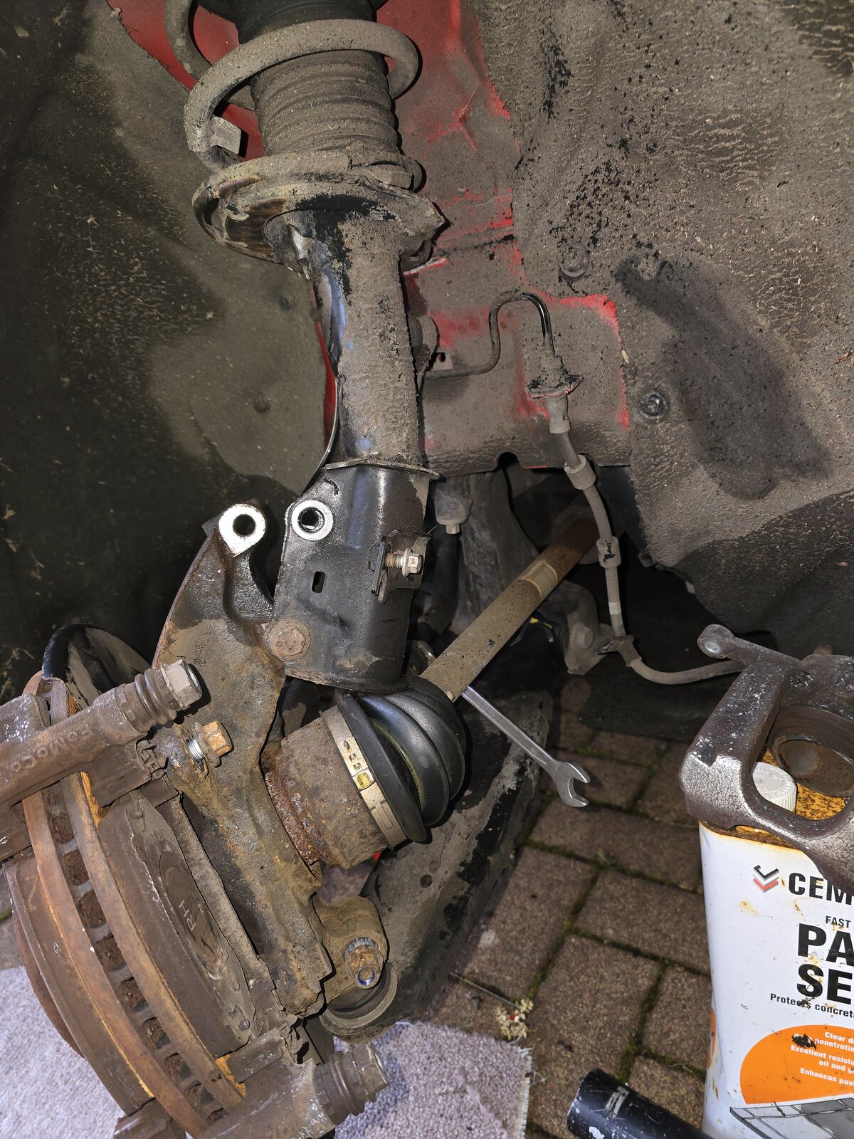

the damage to car is the inner trackrod , tierod ,and the strut was bashed in.
wishbone , deiveshaft,hub look on , wheel arch liner is intact aswell . , when I looked at killer, its OK, lines around door are good , door opens and closes apart from catching .

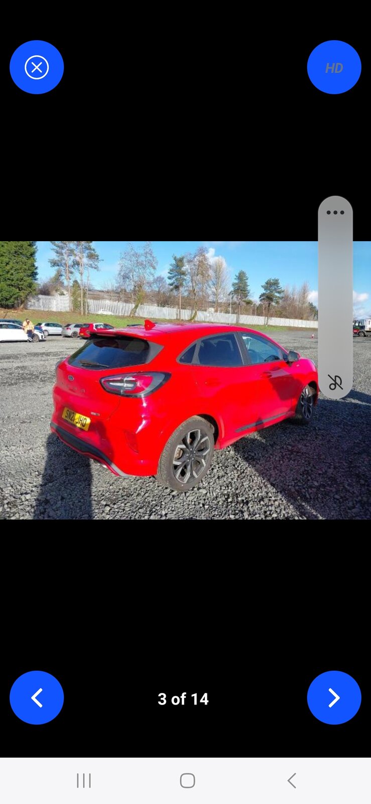

I think we’ll need a close up of the wing edge....presumably the door wasn’t damaged by the impact so it’s the wing that’s causing the closing issue.
With the bonnet open, is there any creasing of the inner wing?
John
Recently I've seen two doors saved by mobile body repairers. They both did jobs I thought would need at least a new door skin. For the harder one, a guy was called from a little way away because the nearer said it was too difficult, it needed special eqpt. They were both really skillful but the second was a magician.
The "easy" one was an X3 door stove in about 3 inches with a kink in the crease line. There was one tiny mark showing, but only if you knew, no paint required.. 6yo car so £150 a bargain.
Send pics from several angles and pop them off.
