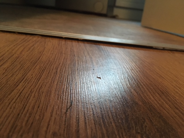

Hi I had som Lino fitted in the kitchen 1 year ago and the guys that laid it put down a little silver door threshold. I have noticed it starting to lift. Anyway to secure it down so this won’t happen? Thanks in advance.

Does it have screws in the top. If it does, then they may not have used long enough screws, and they've worked themselves , lose
Then you need to lift it, clean the old adhesive off, apply some more, and then put something heavy on it whilst it sets.
